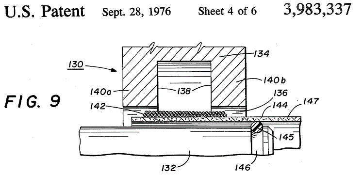

And this patent from Dallas company Babbco Ltd in 1976, figure 9:
Patent link 3,983,337

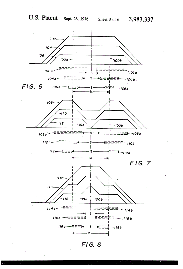

The last one (from 1976) describes the use of twin coils in combination with a single gap to provide the same effect as what is described as the XBL technology. However, this section is interesting:
Here is Fig 9:
And here are Fig 6-8:
Have I missed something or is this just another prior art patent?
It will also be appreciated that the relations of the magnetic field and coil can be interchanged so that the magnetic field is divided and the coil is continuous, with precisely the same theoretical and practical results. Such a structure is indicated generally by the reference numberal 130 and FIG. 9. The center magnetic pole 132 may be identical to the magnetic pole 26. The outer magnetic pole 134 has an annular opening 136 in which an annular groove 138 is cut to form two equal subsections 140a and 140b. The total axial length of the two subsections 140a and 140b may be equal to that of the outer magentic pole 28 plus the space between the subsections. The coil 142 is mounted on a coil form 144, which may be identical to the coil form 44. The coil 142 has an axial length equal to the distance between the centers of the sections 140a and 140b of the pole, so that the sections 140a and 140b are centered on the ends of the coil. Variations in the axial lengths and spacings of the pole sections 140a and 140b relative to the coil 142 will result in force curves identical to those illustrated in FIGS. 6, 7 and 8. Additional analysis will show that all other arrangements result in non-linear sections for the force curves. It will also be noted that the relationship of coils 104a and 104b is such that the force can be made linear indefinitely by providing additonal magnetic fields of the same length spaced apart by the distance M. Such an arrangement provides no practical advantages, however.
Here is Fig 9:

that grove looks like outside the gap, at the end of center pole
and looks more like a farraday shield ring
I think the 'XBL groves' are inside the gap
or I may have misunderstood the whole thing

Tinitus: are you refering the groove marked 146? If so, it has nothing to do with the discussion.
ah, I see the grove #138# now
thanks
well, it does indeed look 'similar' to XBL 😉
did I see XBL design with copper in the groves, somewhere ?
btw, picture shows underhung voice coil

Well, first of all, Fig. 9 does not show an underhung design since it has two gaps. An underhung design has a continuous gap with a shorter coil within. It would be just as correct to describe it as two overhung gaps.
The quoted part of the Babb patent describes the use of two coils and one gap. Lets say the gap is 12mm high, and each coil has 6mm winding height. The center of the front coil should then be precisely at the front end of the gap, and the center of the rear coil needs to be precisely at the rear end of the gap. When moving 1mm forwards, the front coil leaves the gap by 1mm while the rear coil enters the gap by 1mm. This means the coils can move 9mm in both directions and the total amount of winding height within the gap will still be 6mm. That means one coil can move completely out of the gap.
Copper in the grooves is just a way to reduce flux modulation within the magnet circuit.
