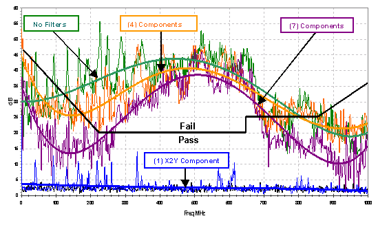

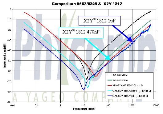

OK, I had a chance to read the literature. Although the X2Y caps seem to be most dramatically better in terms of radiated noise, they may also offer improvements in terms of decoupling. It looks like a large (~1uF) X2Y in the 1812 package retains the HF performance of a 100nF 0603 ceramic while having most if not all of the advantages of the larger cap.
I didn't see any tests of 1uF X2Y versus 1uF//100nF//10nF 0805 or 0612 ceramic, which would have been nice. My concern is that the difference is impressive, but not so dramatic that it is totally obvious to me that these will be significantly better.

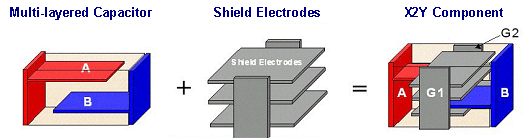

You'll have to design the boards specifically for these caps due to the shield electrodes.
What is the significance of this?
It is very hard to say in the context of DIY. In general we are not concerned with acheiving regulatory-approval emissions levels, but that doesn't mean we are unconcerned about radiated noise corrupting our signal integrity or analog circuitry. That said, I think at the frequencies of interest in DIY DACs, decoupling is more important than controlling radiation by a significant factor. (provided appropriate rise time circuitry is used!)
