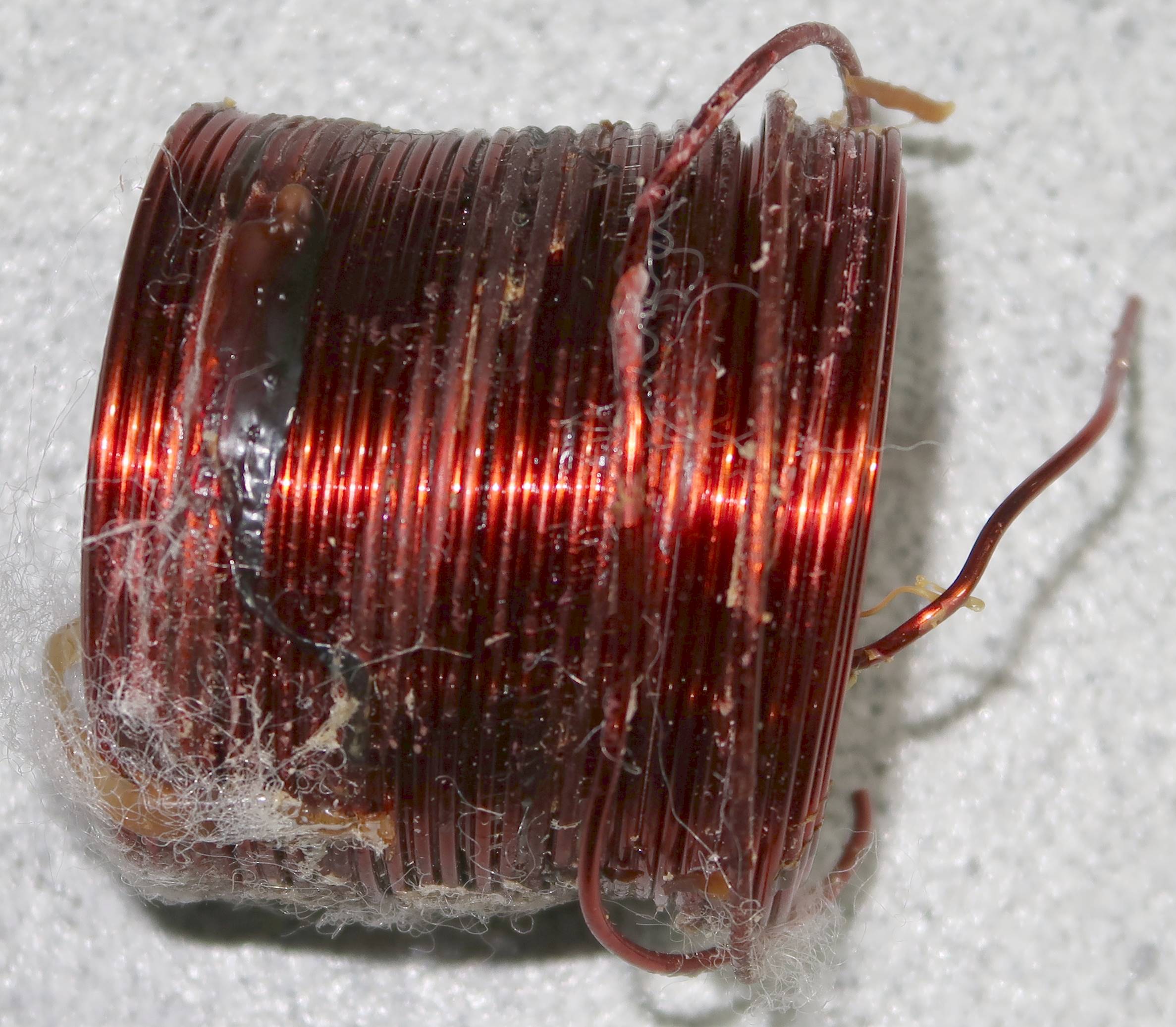

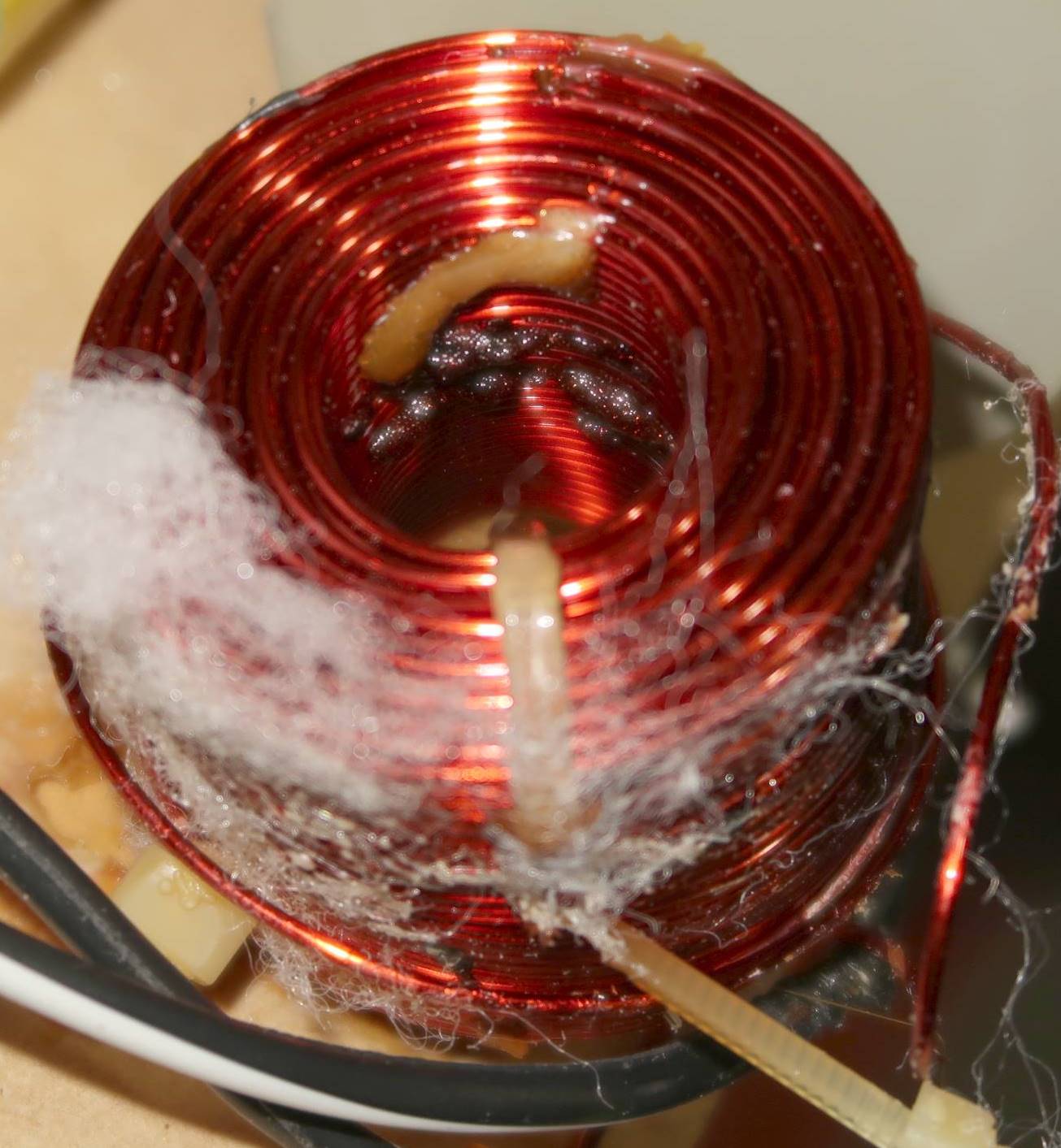

I have the speakers here at last.
The crossover can be bi-wired, makes for easy testing.
The panel section on both are perfect. A nice even 4ish ohms across their range.
The bass sections on both have been over driven for a looooooong time.
Both bass systems when swept with dats drop to 0.1ohm around 4khz.
The primary inductor (3rd order crossover) for the bass section on both speakers are no longer inductors.
More like crispy lumps of metal.
My LCR meter and the dats system refuse to even recognise them as inductors 🙂

The inductor in question is held to the board with cable ties, they have melted through.
There's also a wire running past them, these have had their insulation melted through completely and are showing a good 3+mm of bare copper.
Note that all the inductors are good air core ones that are very well wound.
Nice and square, even, uniform winding.
Now have a closer look at the pics attached........
And no, thats not glue you can see on the inductor. It's melted wire enamel.
I would suspect that a previous owner may have been bi-amping, and either pushing the life out of the bass system, or had a faulty amp delivering some level of continuous dc.
