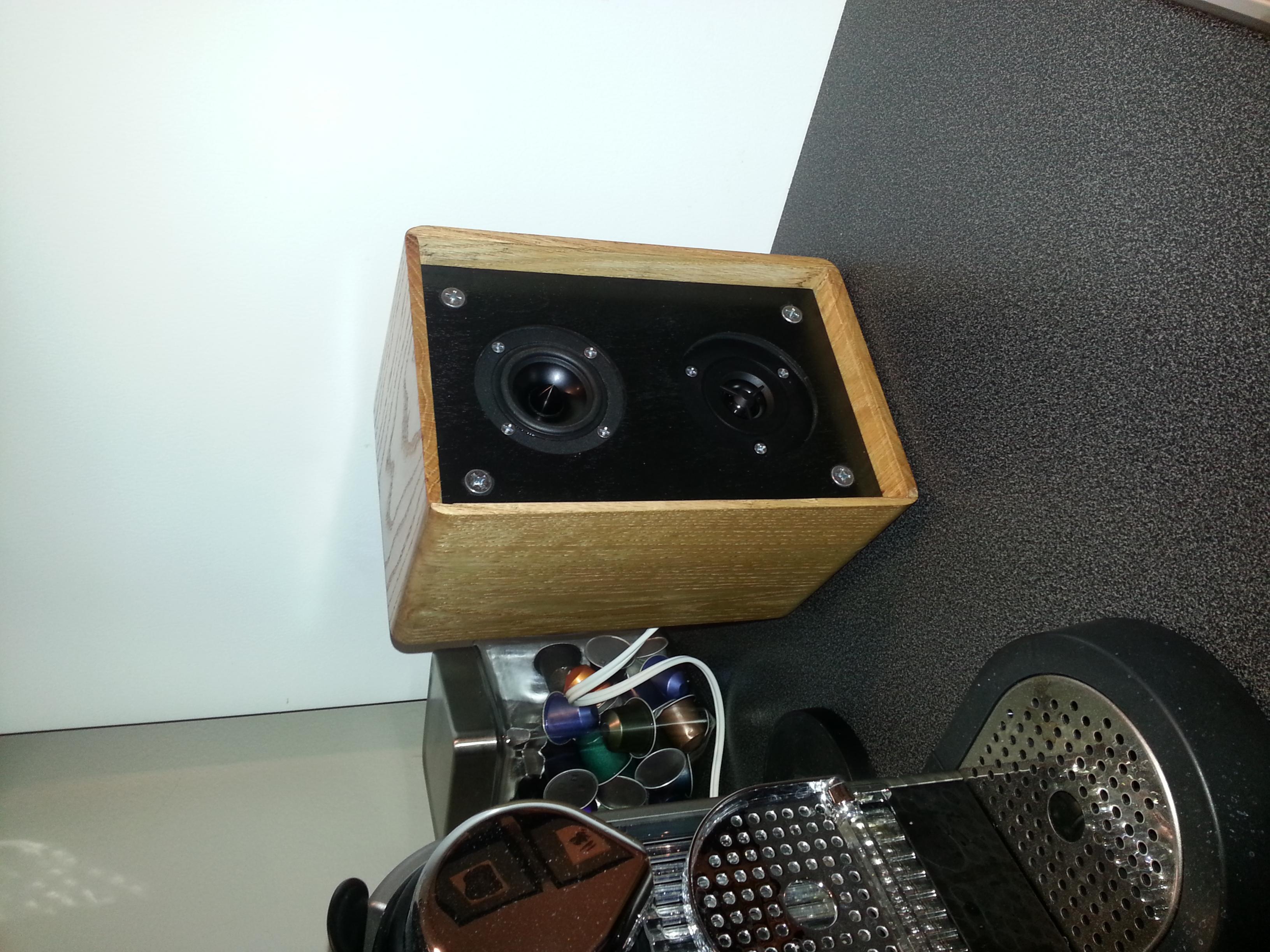

So here is the reason why I was trying to keep everything tiny. I am sure this will cause a few face-palms but here goes.
Attached is my project. Its a raspberry pi powered WiFi radio. This one happens to be mono but I have another that will be stereo. My goal was to keep a small foot print but maintain decent sound...something I think sonos do pretty well. I just figured they were too expensive and thought I could do a decent job on my own. I will ditch the tweeter, as I have another plate without its mount hole.
Perhaps the sheer product/purpose of my design negates some of the high quality audiophile suggestions above?
Yeah, stereo is kinda where it's at these days.😉

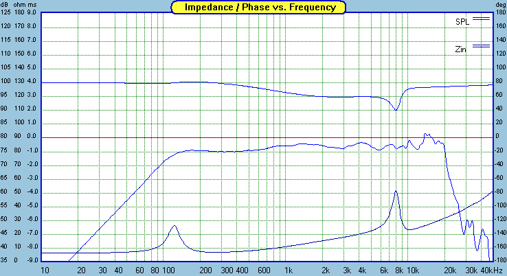

I looked at the frequency response graphs of the two three inch drivers you mentioned on page 1, and don't like either of them enough to use for mid and tweeter. I'd have gone with a Peerless 3 inch TG full range driver ($22 at Madisound)(or Vifa TC driver as 2nd choice - $12 ea).
Any 3 inch driver should IMO only be used down to about 400HZ, unless the listeners ear is going to be within a few feet, and even then, going below 200HZ didn't work as good as I had expected in a few systems I built. Too much FM distortion when EQ'd to be acoustically flat at 6 feet out.
The thing about passive crossovers is that they are difficult to get right. The impedance of the drivers is likely to be significantly different than the rated impedance, at the frequency you want to cross them over at. This means you need to measure both the efficiency and the impedance of each driver, before you can legitimately calculate the reactive components and efficiency equalizing resistors involved. If you've got a bunch of time and want to experience that learning curve then fine. Most people will give up at some point or get it way wrong.

I looked at the Dayton 3 inch drivers and thought they were real good in many ways, but the extra high Xmax meant that the surround suspension stuck out far enough to cause some "cavity effect" which I believe caused the frequency response to be a bit rough, especially in the high end. Not nearly as flat as the Peerless TG or Vifa TC driver. I base this on the published spec sheets for each driver, so I'm taking that with a grain of salt and using my intuition a bit on that one. The Dayton would make a better woofer and OK midrange driver up to a point, but if you want it to be a tweeter too, I didn't think it was flat enough.
