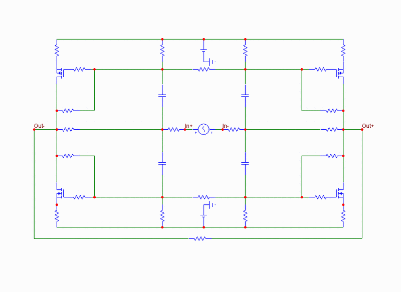

Is it possible to X the Zen V5?
I made a quick drawing on the sim and found the following.
At first impression a bridged Zen V5 works better than an X.
(Assuming the drawing is an X of course).
So could anyone tell if this is worth a study?
/Hugo

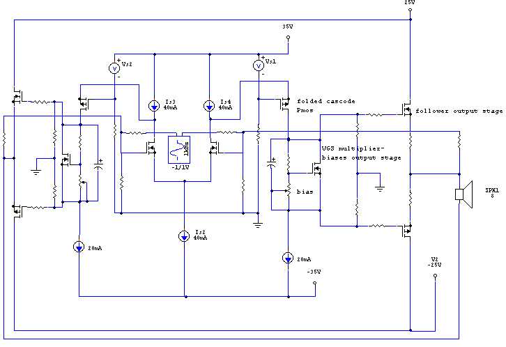

At that point you're not far off from the regular X amp... Just use a differential pair, folded cascode with a VGS multiplier, and a follower output stage. Seems easier and probably better than using two cascaded common source stages- amounts to a single voltage amplification stage and a driver, with the differential pair shared for both halves (ready to add X feedback). I have simulated it, and it works well.
If you want to "X" ZV5, you would be looking to attach
the Source pins together in two identical ZV5's. Since
the circuit is phase inverting, the "cross" feedback is not
employed - it remains as with the ZV5 circuit - the communication
between the two halves occurs through the Source pins of
the gain devices.
Is this enough of a hint?
:devilr: / :angel:

I'm afraid I only understand half of what you want to explain :goodbad:
Nelson,
I haven't got a clue...for the moment :cannotbe: but maybe others will 😉
/Hugo - time and much imagination will tell...😉

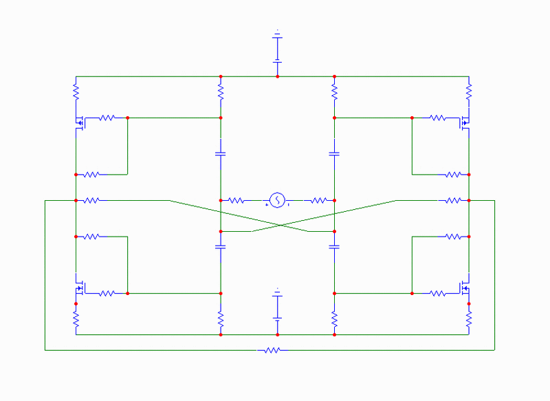

This is my (after a good sleep) interpretation of
"attaching the Source pins together".
The technique reminds me of the magic resistor in the Monolithic Supersymmetry thread.
However, the value of these R’s has to be much higher: around 10 to 20k.
Any input welcome :bulb:
/Hugo

Netlist,
This is a conceptual schematic of what I was talking about. Funny thing about it is that after throwing it together and guessing at the values, I ran the simulation and it worked! 130 watts or so into 8 ohms.
This is only my interpretation of the p-p X amps. In reading about the real thing, I found that Nelson dosen't use feedback around the output stage, so this obviously isn't what he is doing exactly. But, it seems to work, and it's something to look at and think about.
Obviously, when it comes to all of this stuff, it is better to listen to the man himself, than to someone like me who is only beginning to understand the concepts on some basic level. I just thought it was interesting, for the sake of discussion.

That's a nice approach, JH.
Your circuit seems to perform quite a bit better than mine except for the harmonic distortion figures.
Again, I have no idea if we're on the right track.
Seeing your design gives me the feeling we are.
Steve
I already simulated your followers yesterday, in silence..of course. :devily:
Indeed quite a powerful amp.
I have to take a more in-dept look at it.

Netlist said:
I can't see the X. Please tell me.
/Hugo - not that good X-er..😉
Well, the differential pair's current source is the low impedance "summing" point (just like on the AlephX). Since each half of the circuit's voltage amplification stage (which is made up of half the differential and the folded cascode) are inverting, the output of each is fed back to it's own input (look for the resistors at the speaker's + and - terminals going back to the inputs). Do you see it now? In other words, since the output is a follower and is non-inverting, there is no "criss-cross" on the feedback path. Hope this helps.
You're probably correct about the X.
My understanding is that you mean that since the follower is not inverting the VAS you can't see the X as in an inverting amp.
Suppose you take the feedback from the VAS instead of the output, you could send that feedback resistor to the other side?
I’m I clear and is this more or less correct?
Exactly... the Aleph types have an inverting input stage, and the output is also inverting, so you have to take the feedback to the opposite side to get the right phasing. With this, there is only one inverting stage, so you are out of phase on the output, and it can be brought back to the same side... Susy, yes. X, no.
I?m I clear and is this more or less correct?[/B]
Not on this amp, because the folded cascode inverts it once. You would have to take it to the same side.

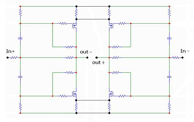

First, JH´s proposal is the only one which is a true Zen-concept.
But the inefficiency is very low, specially with resistors, because you cant get the full rail swing at the output.
And yes, the impedance should be raised from the about 600 ohm to at least 20K or making a preamp that can dive the 600 ohm load, it is possible.

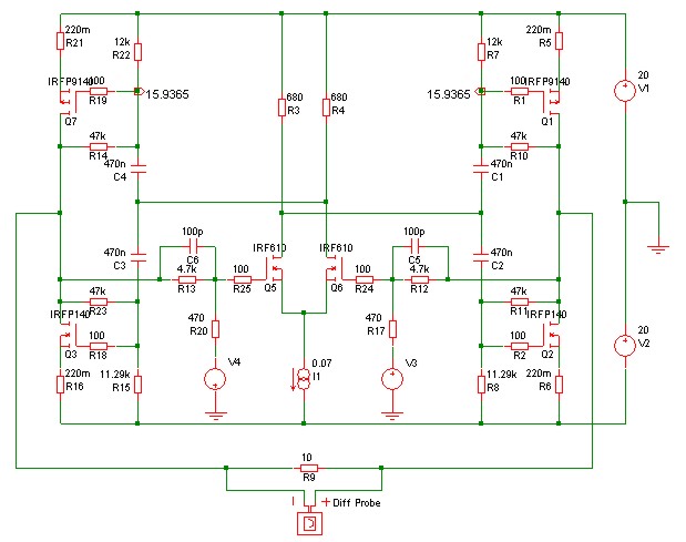

A REAL ZEN X
Here's one that should qualify! I also did a version with the Aleph style sources, but couldn't find a way to make them active (I'll have to keep playing with that one.)
On this version, all the mosfets should probably be doubled up to really deliver the power. It is VERY current limited with just a 2 amp source on each end.
