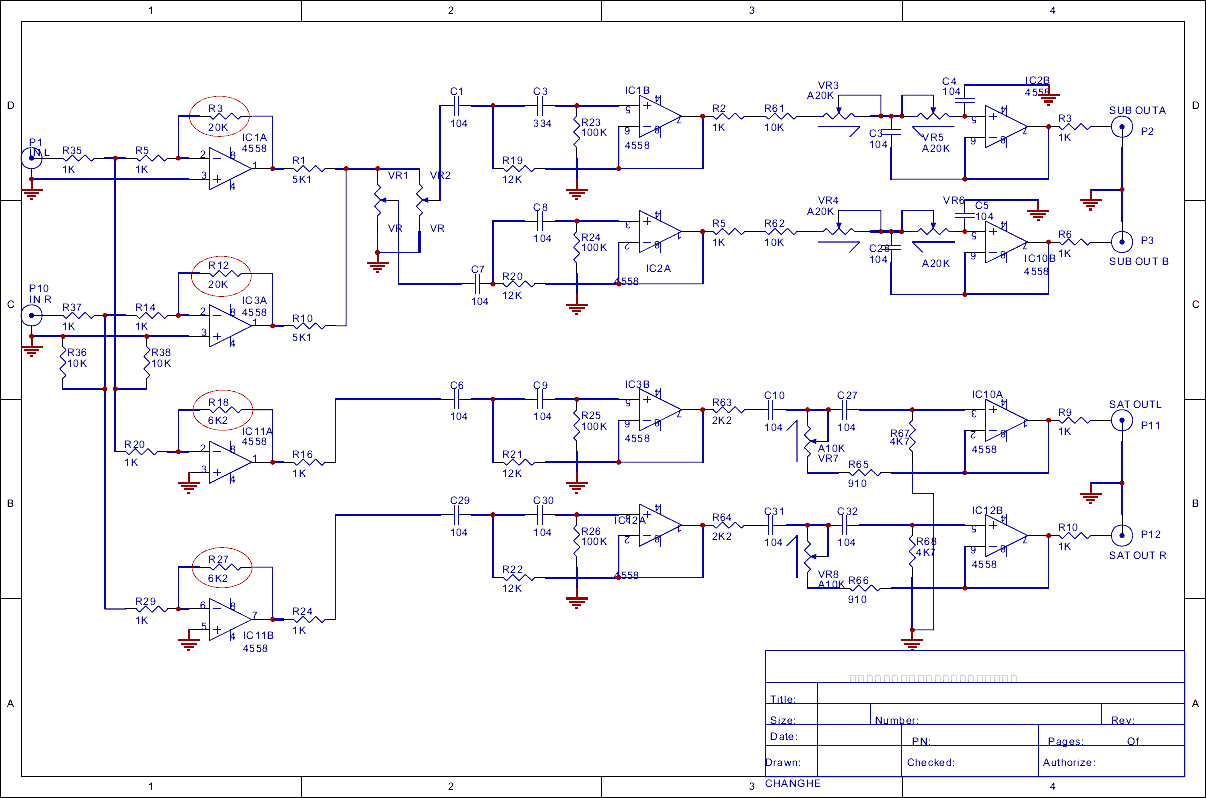

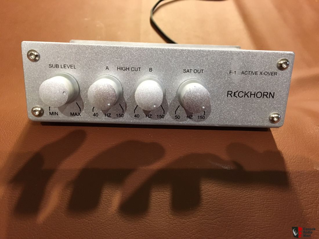

I have some free Rechorn F1s to give away (probably moved out some 3 dozen already). They could use some work (deal with bad grounding, add a PS reg, and clip a wire to convert from mono to stereo.
Don’t know about the distinct XO frequencies.
