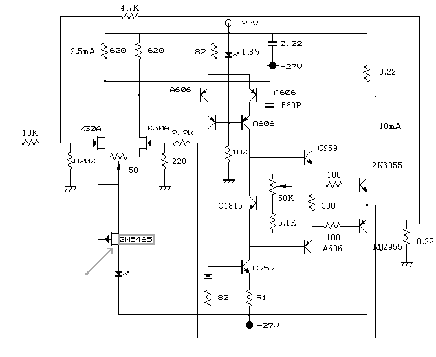

That JFET is wired as a current-regulator diode, there's no reason you couldn't replace it with an N-channel device with similar Idss (and flip the gate connection, of course).
Hello sparcnut
Would you be so kind please explain it how I replace the P-channel FET with a N channel FET .
Can you make a sketch so I can understand what was your thought .
I have 2SK30A at hand , that has the closest Idss to the orig.
2N5465 .

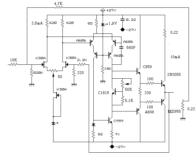

If you have a 2SK30A with reasonable Idss, you can simply flip the FET upside down and attach it the same way. A resistor (range 100R-2K or so) can be inserted in series with the source of the FET (between source and gate) to reduce the current to any value below Idss, if necessary. It's right at the edge of the voltage rating (50v vs. 54v rails), but the LED and voltage drop across the LTP components should keep it from going too high.

I just study a couple N channel J Fet the best choice it would be 2SK117BL . Of course is has different pin out but the Idss is very close to the original 2N5465 .
I will use a resistor before the LED to decrease the voltage a bit for safe purpose .
Now I understand how all these works .
Thank you one more time sparcnut .
I'm happy not just because the problem got solved because now I learn something new .
