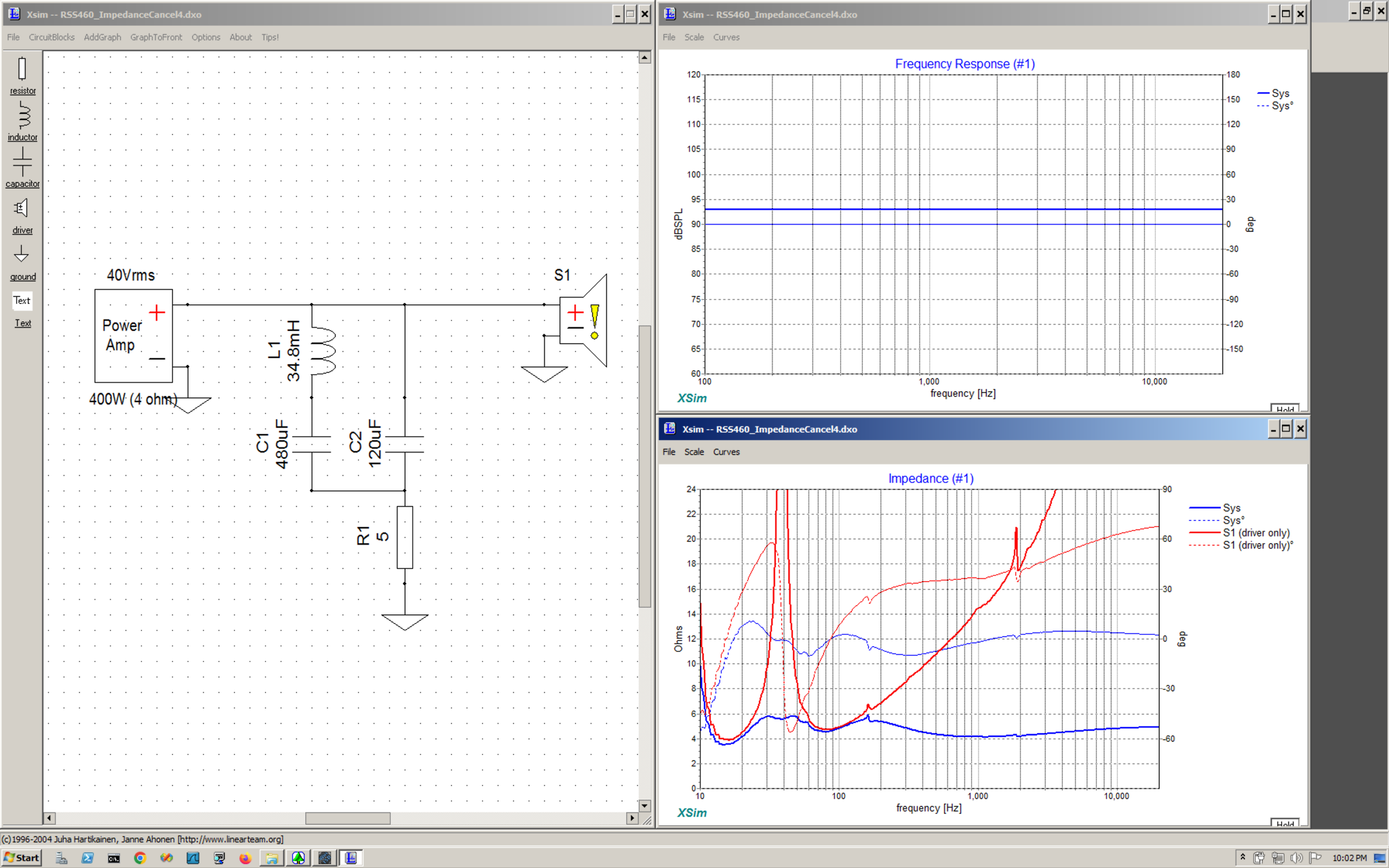

If you want some fun, try impedance flattening your drivers. Sorting the subwoofer cleaned up kick drum transients and distinction from the bass guitar, and nailing the mids changed snare drums from a "cronk" to a "crack", while also (I did NOT expect this) placing layered voices precisely on the soundstage instead of having them vaguely in the middle. The impedance magnitude is less important than the impedance phase, which you want as close to zero degrees as possible to emulate a resistive load. It turns out reactive speaker loads interact with cables, and reducing the reactance reduces cable effects. In this article compare figures 28 & 29 with figures 9 & 7 respectively.
Ignore the flat amplitude response charts; I couldn't be bothered to throw FRD files into the simulation drivers.
