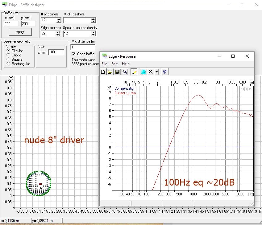

silverprout, you are asking too much from a 8" woofer.
With the needed equalization, it simply can't handle bass even at 100Hz . Usually dipole bass is 2 10-12" subwoofer drivers. I have a nude 12" and it needs almost 20dB of eq to reach 100Hz! This is so crazy that it is hard to believe, but trust me!
Check John Kreskowsky's studies NaO Note II RS Details
