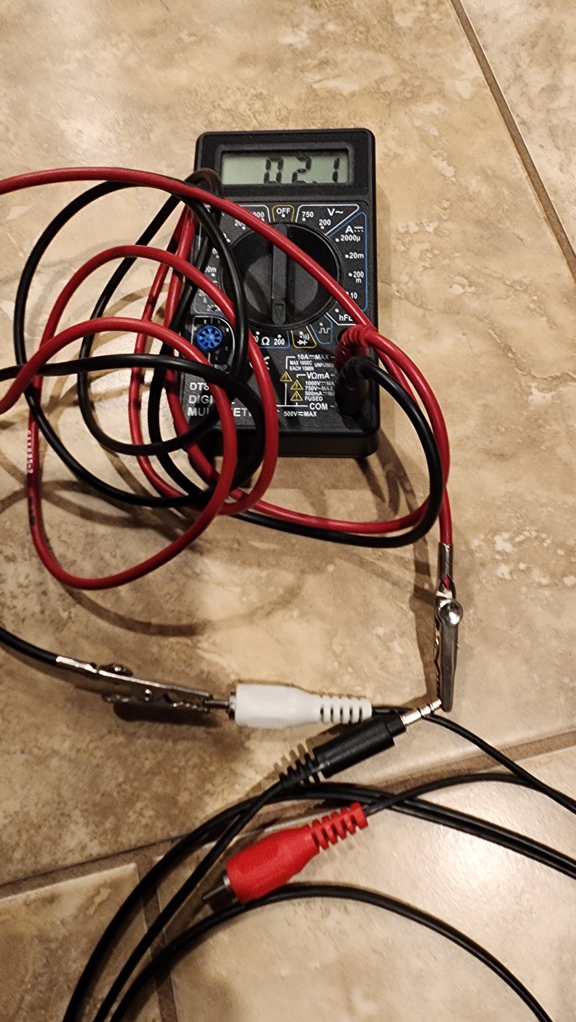

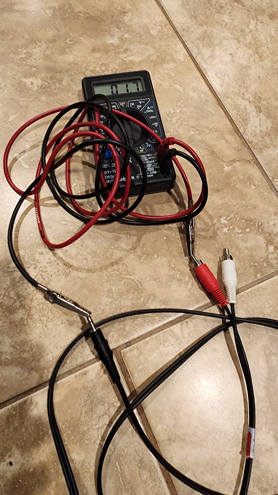

Been working on small travel system. While using various cables i have with small phono jack to stereo rca connectors i noticed some have wrong polarity.
Beware!

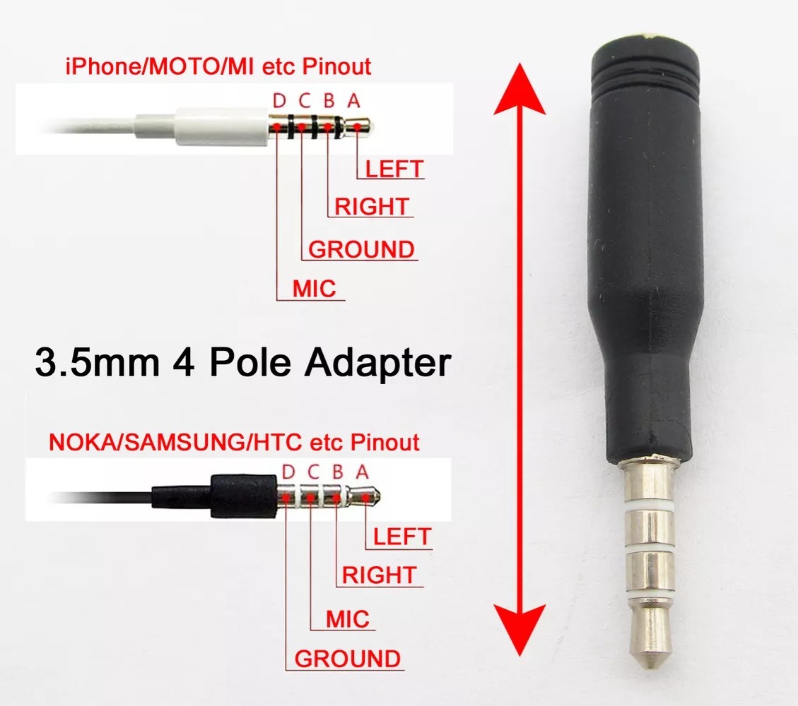

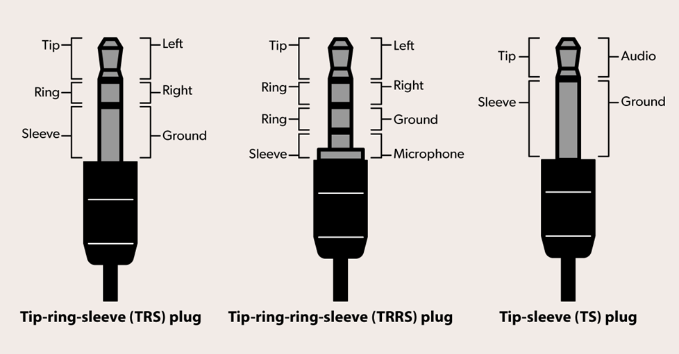

This is convention, tip is always left channel.
