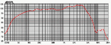

Here is the Alpha. It has the smoother response of the two through the midrange. I guess we could call this 94 dB through the midrange response. The big rise in sensitivity could be addressed, to a greater or lesser degree, with an inductor in series.
The Thiele-Small numbers give us a mixed picture. On the one hand, you end up with a pretty smooth, desirable Qtc of 1.15-a bit higher than the optimal range, but no too bad. On the other hand, your F3 is around 63.
I should point out that most DJ boxes are 3 cubic feet, usually ported, (but so what), and have an F3 around 60 Hz. This is how they make their living, and most people find that to be an aceptable F3, even though you would like something deeper for home listening. If 60 Hz sounded "tinny", DJ's would have to use equipment that goes lower, and they don't. So you can slide by there.
Here is the graph of the Alpha 12:

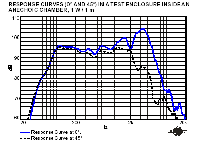

Here is the Selenium. It is a somewhat rough through the midrange. The rise in response near 1500 Hz also can be addressed somewhat by an inductor in series. It also will have an F3 in the 60 Hz range. A notch filter around 3500 might not be a bad idea in the crossover-either that or a very steep slope for the crossover.

Considering that you have only 8 watts to work with, I would say that both of these are workable. Still, you would like to have a slightly deeper response from a large 3.5 cubic foot box, (100 liters). If I were to choose between these two, I think I would lean toward the Eminence because of the smoother midrange response and because it looks like it might be less tricky to cross over.

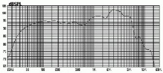

Roddy: How do you like the idea of hooking two of these Audax HP210GO up in series or parallel? Assuming Trespasser Guy has a 4 or 16 ohm tap, the sensitivity goes up 3 dB. Except for that little dip at 400 Hz it seems to hug the 90 dB line pretty well. I have no idea why they rate this speaker at 92 dB-it clearly is a 90 dB speaker. But two of them hooked up together will play through the midrange at 93 dB. And they are only $140 for four of them.

It’s not a bad idea at all. 2 drivers in // and in an MTM arrangement should have enough efficiency for an 8W amp (besides, tp_g could build a 20W gainclone later for <$50). If tp_g goes that route, I would suggest losing the horn (as I live and breath) for more dome tweeter. I’m thinking something like BrianGT’s Thor arrangement (I know it’s not Brian’s, I just think of him when I think of the Thor). Here’s the link to his project. The design is the same with phrugal parts.
