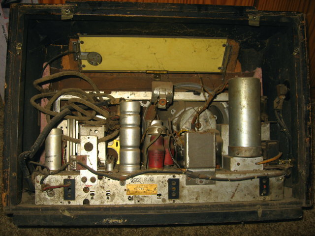

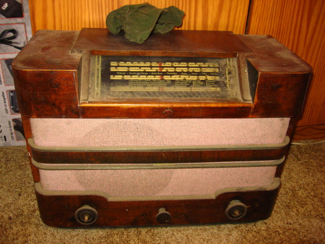

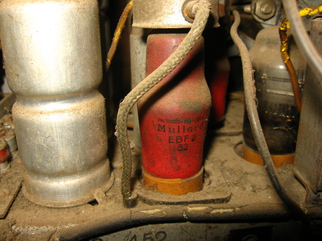

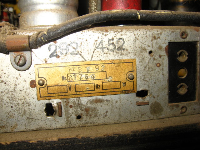

Found this in the garage....
I wonder if it is worth restoring, the wire insulation is mostly perished, but otherwise it looks ok, just DIRTY.
Any help in identifying would be welcomed too...

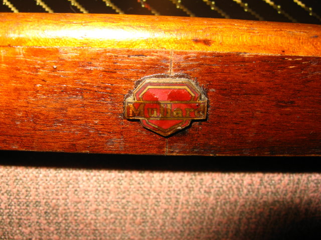

On the face is a Mullard badge.
Cool looking device. If multiband, even cooler. Not hifi, obviously,but low fi has its nostalgic appeal.
You're tubes are probably fine, but the electrolytic caps will all have to be replaced. There are a lot of antique radio clubs and websites, probably get more help than here.

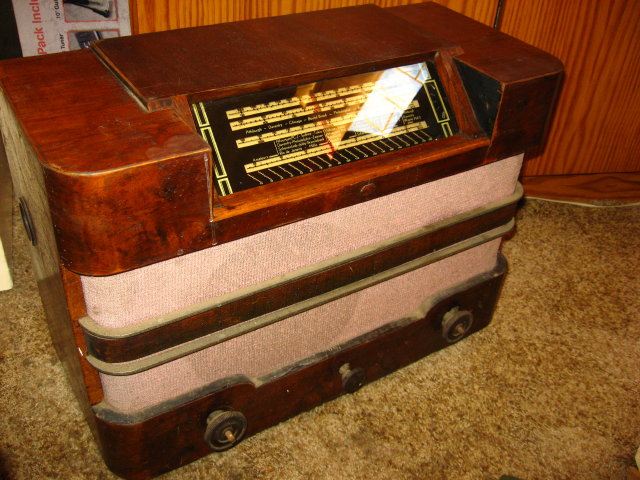

Hey, been dusting a bit at it, cleans up pretty nice for its age and neglect...
The dial still seems to move the needle around, and the selector can choose between 3 bands and phono.
Phono input, whoa! A mono record player. It will never go out of style! I wonder if BBC news still broadcasts on shortwave? We get them here on the FM public service station midnight to 6am, interesting if you are working maintenance and need something to stay awake. Cool your capacitor still turns, I have an early 2 transistor radio with a stuck tuning capacitor.

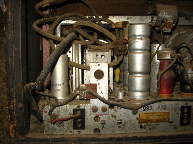

I have rebuilt worse. Test the caps before replacing them. It looks almost old enough to have some oil filled power supply caps. They should still be good.

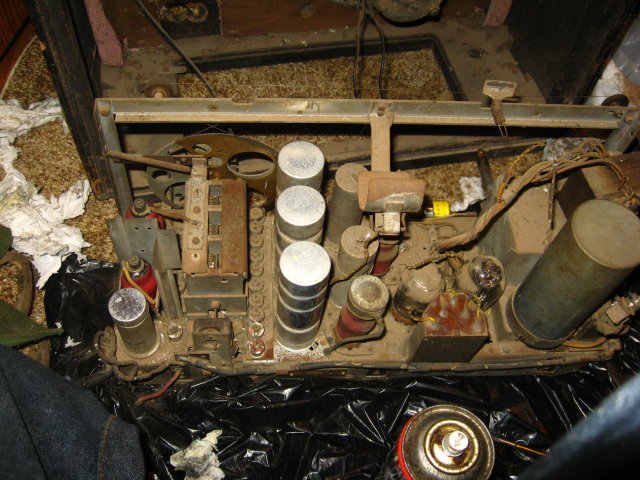

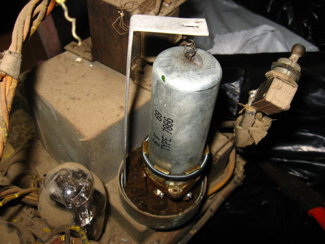

OK, I managed to get the assembly out of the box in one piece.
Trying to identify some of the components are hard though...

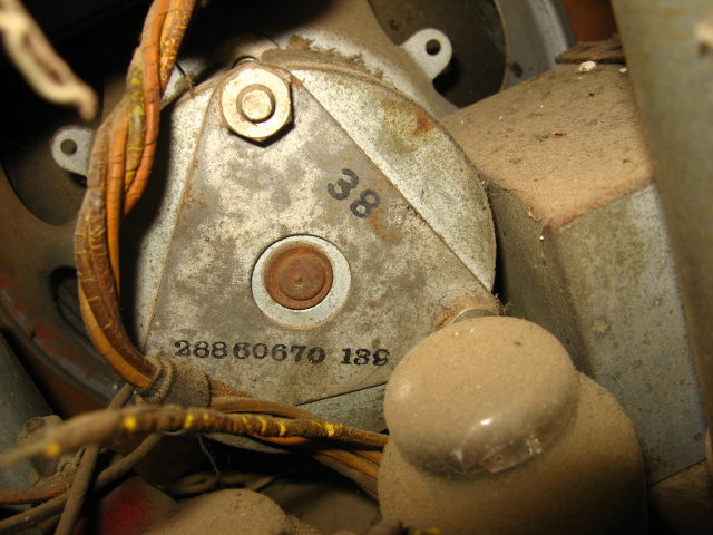

Like what is this gyrating disconbobulator, hanging from a spring in a can doing in there? It seems to have some perished foam stuff in the bottom.
Cool! Looks like a vibrator voltage step-up device:
Vibrator Power Supplies
Of a Type 7866. A mechanical switching PSU..
Which sort of implies it runs from a 6V source - which sounds a bit strange. What does it say on the back of the radio (if it has a back)?
No back, I'm afraid... sounds hectic though.

That would be a Stromberg carburetor, from a 1934 Ford.
Quite a find, you have there........ 😛
looks like this radio was a portable! 6 volts was the standard car battery when it was built. The piece does indeed look like a vibrating reed to switch the DC into the step up transformer.

Very nice, I'm no expert, but I think Mullard sets are fairly rare.
