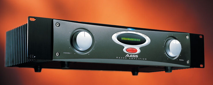

Also I am thinking of using a Alesis RA300 Power Amp casing (+ intigral Heatsink) for the Project, do you think the heatsink would provide enough cooling for the Aleph J . . . ?
(I have attatched a pic of the Alesis RA300)

From the picture it difficult to judge the length of the heat sinks. In short they are to small and probably only 25-40% of what is required for 100watts each.
This chassis might work for an Aleph Mini of about 10 watts output. A chip amp is another option.

I have to admit the pic wasn¡¦t that good but the one I wanted to put on was to big . . . pasting the link would have been a good idea I suppose:-
http://www.ixbt.com/proaudio/ra300/fb.jpg . . . . . (I am going to change the front)

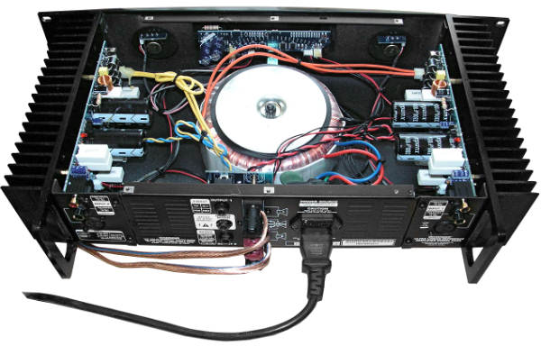

The Alesis RA300 is the same as the Behringer A500 (I doubt that makes it any more clearer) which has been mod¡¦ed on this site previous. I am hoping I might be able to use the Toroidal, looks a decent size . . . . . getting big Toroidals in England is near impossible . . . . . (small island, small parts ƒ¼ )
Each heat sink (one ether side measures approx 4¡¨ H x 10¡¨ L . . . . and the fin¡¦s are around 1.5¡¨ ¡V 2¡¨ deep)

4" x 10" still ain't gonna cut it, Matey.
Oh dear . . . . looks like I am back to the drawing board with the chassis, I will re-think that one . . . . . and think big this time . .
With the transformer, I was looking for a 0-230V - 2x 18v 400va (800va total) Toroidal, but out of all of the companies I have tried, their off the shelf units barely hit 225va . . . . . for both 18v secondary’s.
I have approached companies to wind a bespoke but they don’t like knocking out single units . . . . .
Thank you all for your help, youve saved me from building a time bomb . . .
