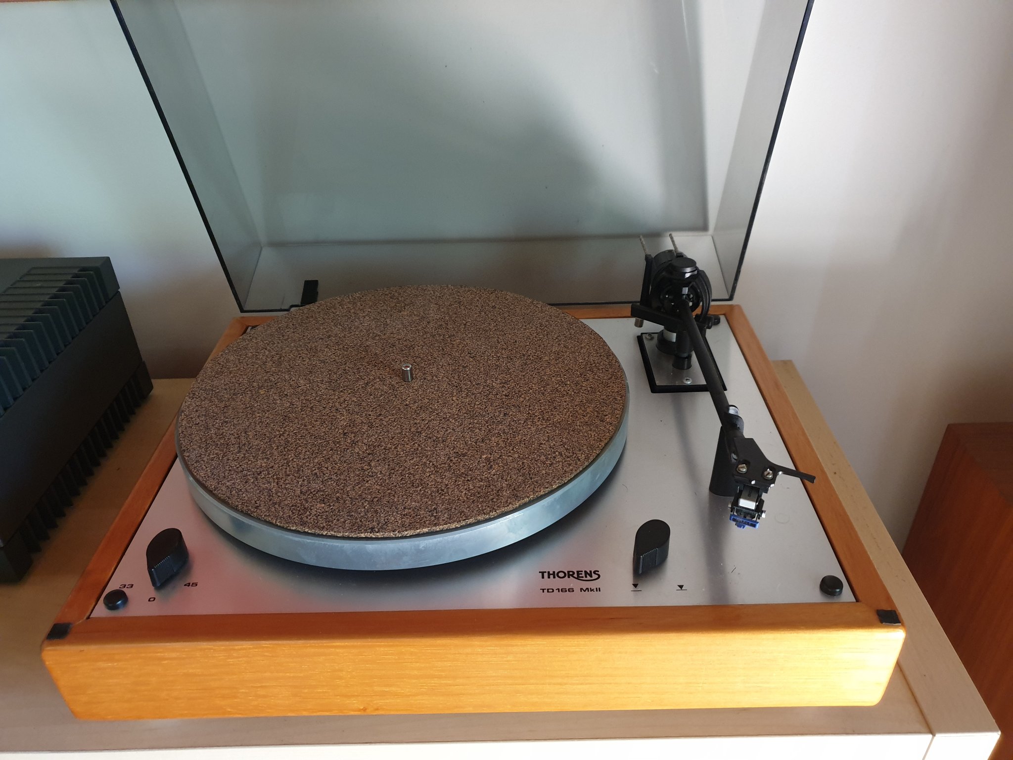

I was thinking about replacing the motor in my TD166 MkII with a brushless DC motor. The main aim is electronic speed adjustment to replace the mechanical belt-shifter.
Has anyone tried this? I did find the Origin Live and would like to built my own "cheaper" version of that.
Was thinking of using PWM speed control, possibly with hall sensor. Or an Arduino-based controller.
Can use soft-start or keep the original clutch-pulley
Is this a good idea? I would appreciate any advice on the best motor/pulley to use and reliable speed controllers.
Alternatively; let me know if it is a stupid idea and that I should just leave it alone 🙂

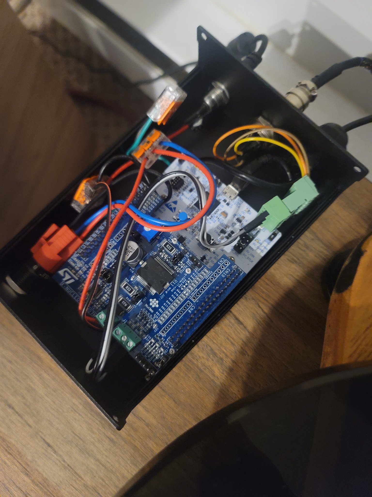

i use an Arduino-type board + plug in bldc driver board + SimpleFOC software library to generate 3-phase sine waves (or SpaceVector waves) to drive my BLDC motor. It is silent, and achieves extremely low speed variation.
$50 in motor control hardware + $100 for a nice strong low coggimg bldc motor (like a 4pole or 8pole BLDC from Anaheim Automation) is pretty awesome.
i have used both Arduino and STMicro Nucleo boards.
