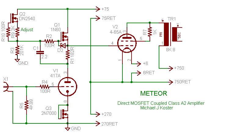

I assume that the JFET is driven as a follower, with the tube for voltage gain? The OP is asking about the JFET as and input/driver.
And I am answering, that vice-verse is more effective. 😉
And yes, he can use JFET to drive 300B. Like, Michael Koster posted here schematic of his amp where he used MOSFET to drive DHT tube.
I've done what MK has done too (for a low impedance output on a phono amp). I know that he asked about driving the tube, but the OP made it clear that he is asking about substituting the FET for an input gain stage. By "driving directly" I think he means substituting for a single tube gain/driver stage. Let's not confuse the issue.
