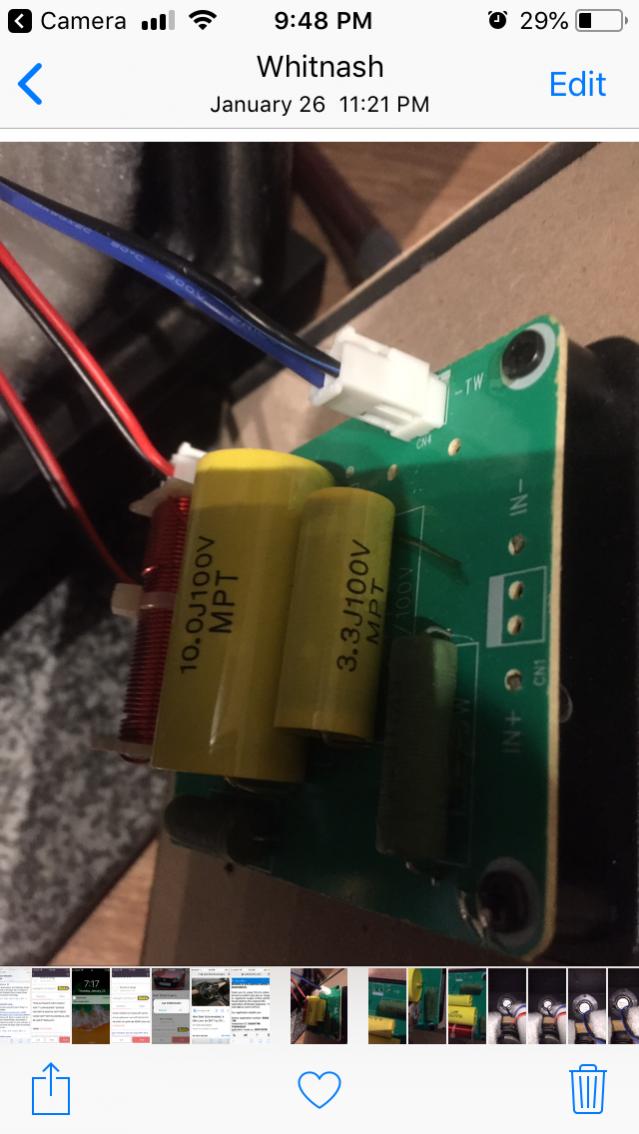

Would I benefit from replacing caps.
Hello all I am using epos k3 speakers. Would I benefit from replacing the caps on the crossover board. And what ones would be ideal many thanks all lee

What is the difference between mpt and mkp would you use
the same value or increase or decrease.
You must keep the same uF values (and similar or higher voltage ratings)
when replacing speaker capacitors. The MPT are generic metallized polyester film,
and the MKP are generic metallized polypropylene film. The brand more depends
on what's available to you readily.
MPT is a new one to me. Seems to be metallised polyester, which we used to call MKT (polyester). Slightly worse than MKP (polypropylene) in theory. 0.5% dissipation factor as compared to about 0.1%. This is a dielectric effect.
TBH, I can never hear any difference at all between all these plastic capacitors.
People never seem to upgrade ferrite coils. Now those ARE measureably worse than air coils. Must be because you usually need to measure them. 😀

I think I am wrong about those MPT capacitors. They are 100V polypropylene:
Further performance increases have been achieved with the implementation of high quality crossover components, including the selection of very high-grade polypropylene capacitors and metal oxide resistors. As standard, the K-Series comes pre-wired with Oxygen Free multi-stranded copper wire. Specially designed cable management holes inside the cabinet and high current connectors allow for aftermarket replacement cable sets to be installed, if required.
https://www.epos-loudspeakers.com/products/floor-standing-loudspeakers/k3/

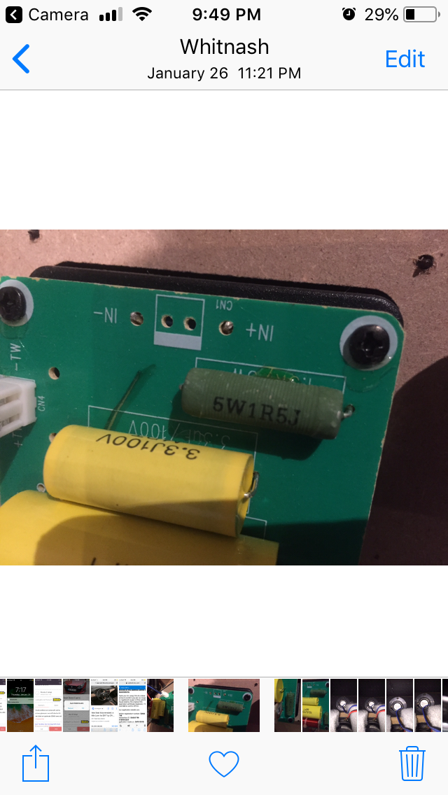

The tweeter filter is a 3.3uF and maybe a 1.5R resistor. Not too sure what the bass section is. It claims to be a 2.5way. Which doesn't make sense to me with a 4 element filter unless one mid is running fullrange, and the other gets some rolloff. You'd usually use something like 1mH and 10uF in a regular TMM bass filter.
701381d1535994464-benefit-replacing-caps-328b4d8f-1ad4-4d07-943c-6006529bd245-jpg
Anyway, the main event is the 3.3uF if quality can be improved. But beware the exotic film caps are all bigger. For sure 400V seems to be most manufacturers choice. Hard soldering the connectors would be a good bit of technique too.
..would you also replace the resistors.
Yes.
..a lot more "bang for your buck" as well - it tends to directly effect clarity.

Before you go anywhere else, it would be helpful if you could answer two questions.
1/ What is it, exactly, you are trying / hoping to achieve?
2/ What is wrong with the caps in your speaker at the moment?
You probably don't want to hear this, but I'm going to say it anyway: nobody, to the best of my knowledge, has ever heard a difference between reasonable quality MKP type caps in properly conducted blind listening tests.
Now, accepting that the above isn't entirely conclusive, it is true there can be some minor differences between MKP or alternative high quality capacitors; this is circumstance dependent & generally requires a very revealing system. Frankly, I suspect a pair of £1,500 Epos speakers, which while decent products for the money, aren't of that kind of resolution.
Component marketing is largely that: marketing. Very persuasive, very appealing in a 'magic bullet' sense, but overstates the case. Be that as it may, if you want to change the caps, to my mind there is zero point in changing them for another perfectly standard MKP, whatever the nominal voltage rating. You will hear nothing, unless you are told what you will hear, which instantly provides expectation bias. You will probably hear nothing changing them for anything else either, but if you're going to do it, the only real reason to do so would be if you were shifting to something with different construction. That means size, and money. The three nominal options would be a double-row non-inductive 'supercap' (don't get sucked in by the name, it just means it's a double-row design) such a Mundorf Supreme, Jantzen Superior Z cap or Audyn Plus. The next option would be a true film & foil which uses an independent foil layer rather than metallising the film. Examples of these are the Mundorf Zn, Audin KP SN, Musicap and Hovland offerings. Finally, paper in oil types, e.g. Jensen's offerings. The majority of these are extremely expensive options; probably cheapest is to use the Audyn Plus or KP SN. Paper in oil cap prices are through the roof and IMO you'd be wasting your time with the Epos. I think you're wasting your time & money, period, but it's your choice & if you believe you will hear a difference, then you may. Whether that's worth the coin & time only you can say.
