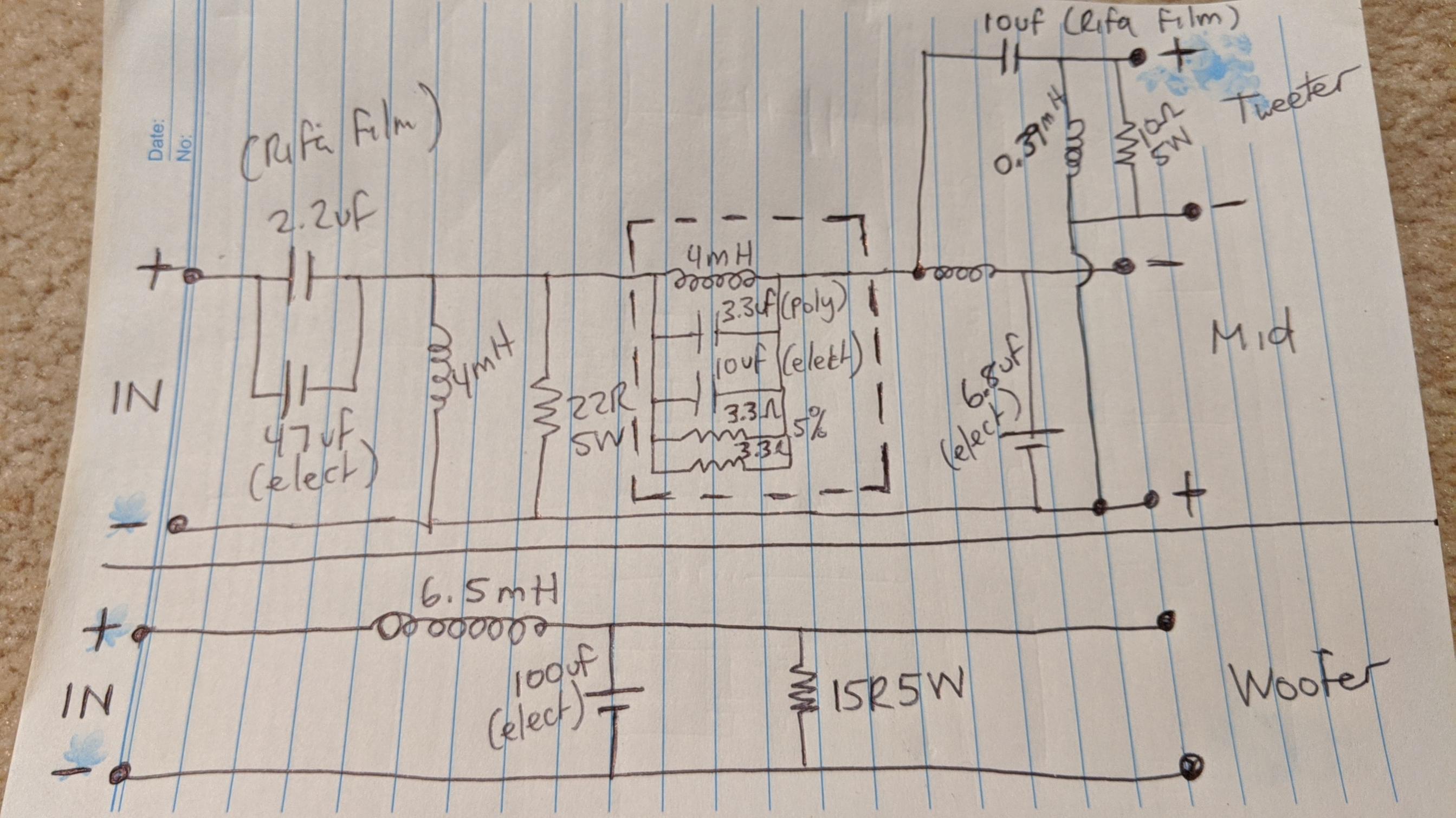

I bought a set of 3 way diy speakers incorporating a Seas 8" driver, Alpair 5" midrange and Aura tweeters designed and made by a well known speaker builder. He has used Rifa film in the series and Bennic electrolytic in the parallel circuit. Would it be beneficial to upgrade to a better branded specification capacitors? I know changing may voice them differently. I've attached the crossover schematic.

It's mostly personal preference, if you can (or think you can) hear a difference.
Aluminium electrolytics bypassed with film caps should give you the best of both worlds (larger size in a small space, and the better sounding part as well, if you can hear a difference).

The 15R in parallel with the woofer may be due for replacement, since it burns
significant power and is only rated at 5W. Check the 22R and the 10R resistors as well.

Replacing electrolytics with metallized film capacitors means not having to worry about the lifespan of the capacitor after it has been replaced. This is a good thing. However, in some designs, the ESR of the electrolytic has been factored into the crossover and replacing it with a lower ESR capacitor (ie metallized film, film & foil) alters the desired response.
In a woofer circuit, a metallized capacitor is going to be much larger than an electrolytic. This larger size makes it more susceptible to EMI interference via domestic electrical wiring (50/60Hz plus harmonics).
Replacing any capacitor with an audiophile-approved brand makes sense when the possibility of selling said gear to audiophiles is a real consideration. If not, save your money for music.

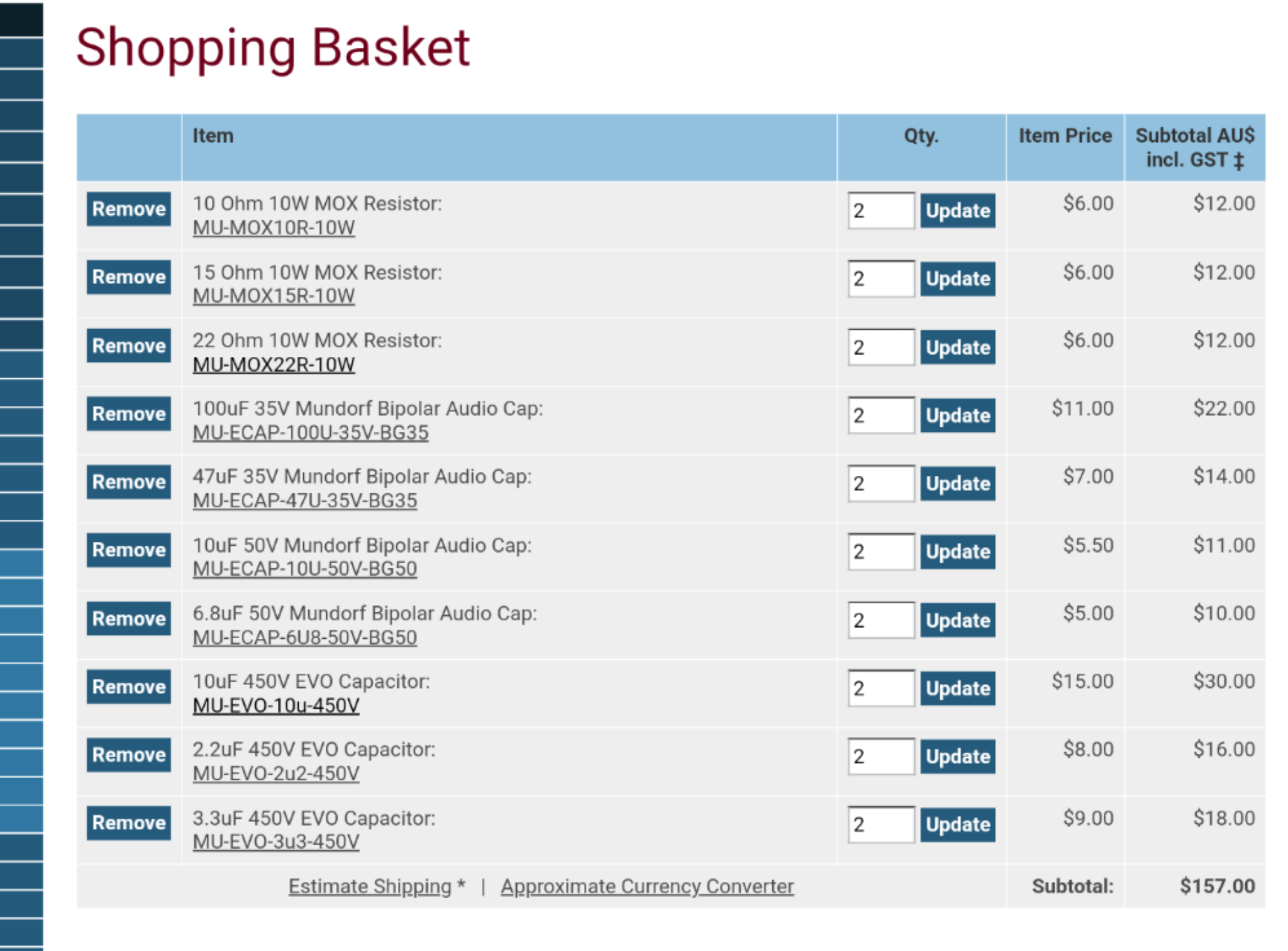

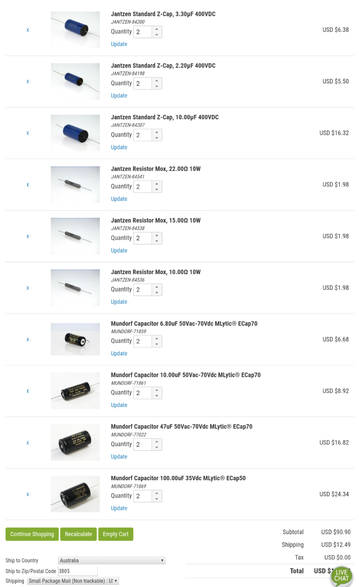

So I've got two different quotes using two different brands of Polypropylene capacitors. Jantzen standard Z Cap or Mundorf M-CAP EVO for the series. Anyone used either?
Mundorf Lydic ECap bipolar in the parallel on both quotes.
Both quote are the same when you incorporate the exchange rate.
Are you sure that you have correctly sketched the crossover filter?
I'd go with the Jantzens over the mundorfs.
And why not buy local ?
SpeakerBug
A quick look at your jantzen sheet suggests the local speakerbug guy is cheaper by the time you figure in usd to au conversion.
SpeakerBug
