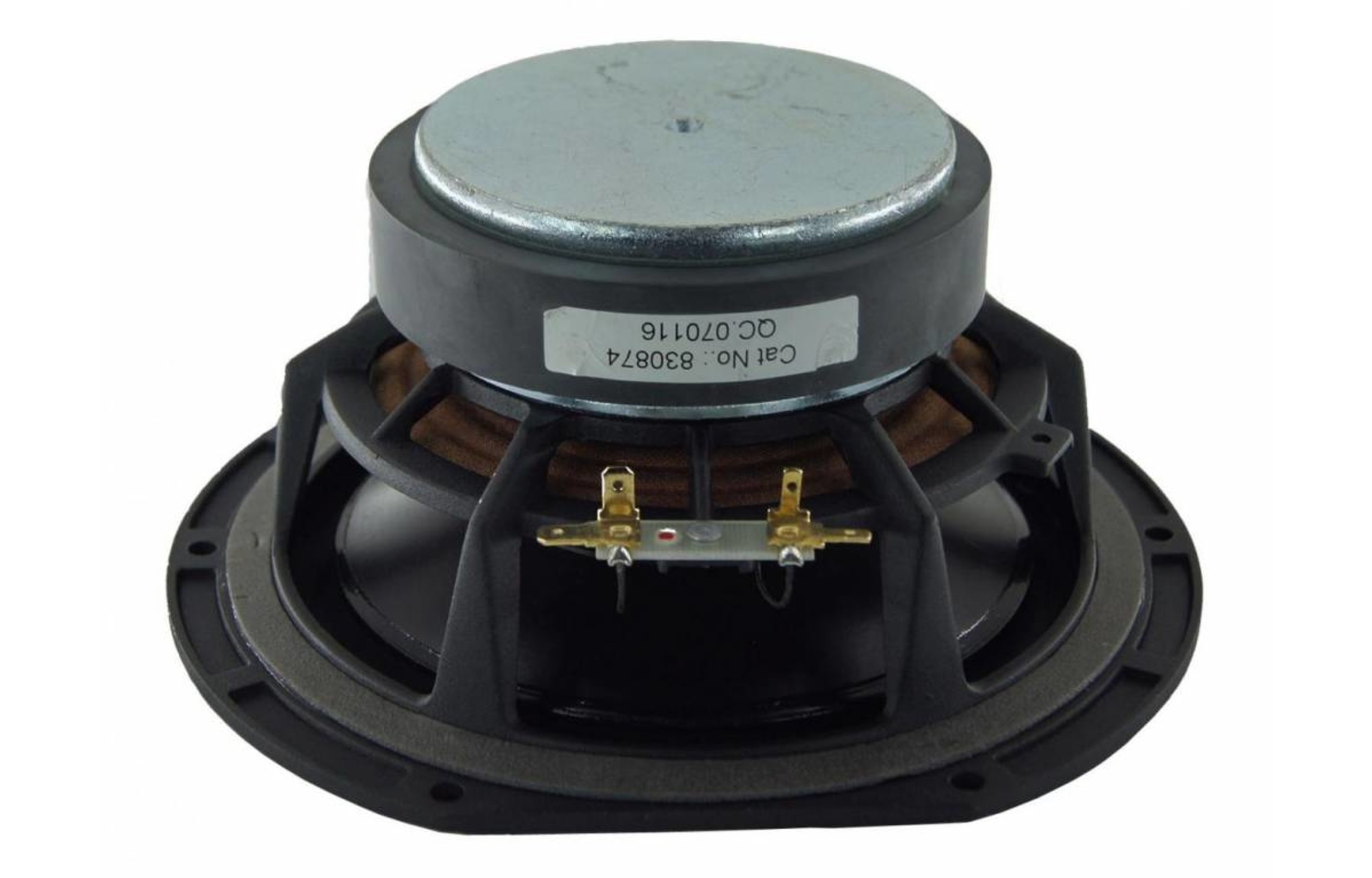

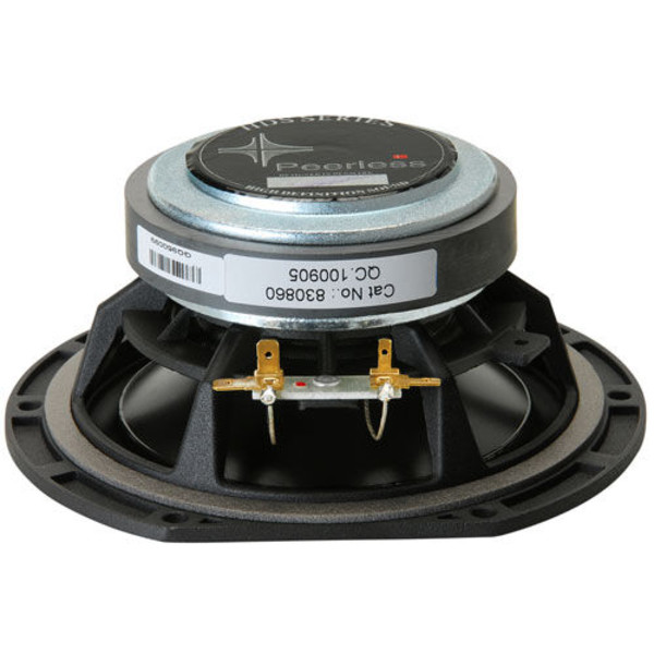

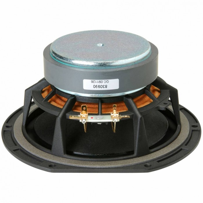

Sorry. I meant to type Resonance in the title. Fixed it.Here's three images from the web of the rear of Peerless poly cones. The seam is clearly factory/machine done. The bead/seam on the drivers I have is pretty clearly hand applied and kinda sloppy. I just don't feel good about this.

1) polypropylene is notorious for being hard to glue to
2) that is not "doping" (it would need to cover all the edge surface for that, internal or external) but a thick gluing/seam bead, its purpose is not to ,damp resonance or add mass to the moving parts, although that will be a side effect, but to keep cone and edge together.
3) admittedly it looks "ugly" or "sloppy" but I guess it´s doing its job, so ....
4) I guess they had a rash of cone-edge separations, specially dreaded consumer complaints and warranty replacement; even if as low as 1 in 20 that is 1 too much, specially if discovered at customer´s home, some time later (not at the Factory because they wouldn´t pass the most basic tests) , remember "bad news spread fast" so I bet assembly instructions added the line "add a reinforcing glue bead around 6.5" PP cones".
Obviously hand applied, not as automated as at the cone Factory itself.
Doubtlessly accompanied by instructions to cone Factory: "hey guys, please make sure you glue them WELL, do as many tests as needed to ENSURE that"
5) I guess these reinforced adhesive speakers work fine and within spec, although a slight variation in resonance wouldn´t surprise me.
As long as they are used in pairs from the same batch .....
6) IF you measure their parameters, please do and post them, if having a non reinforced speaker for comparison, even better; TS parameters "should" show a small difference (a couple grams tops) in "moving mass" and very slightly lowered resonance frequency, although that should still be well within parameters.
Added weight there will not audibly change sound; now IF it were at the voice coil/cone junction yes, you would lose some high frequencies; a couple extra grams at the voice coil are significant.
