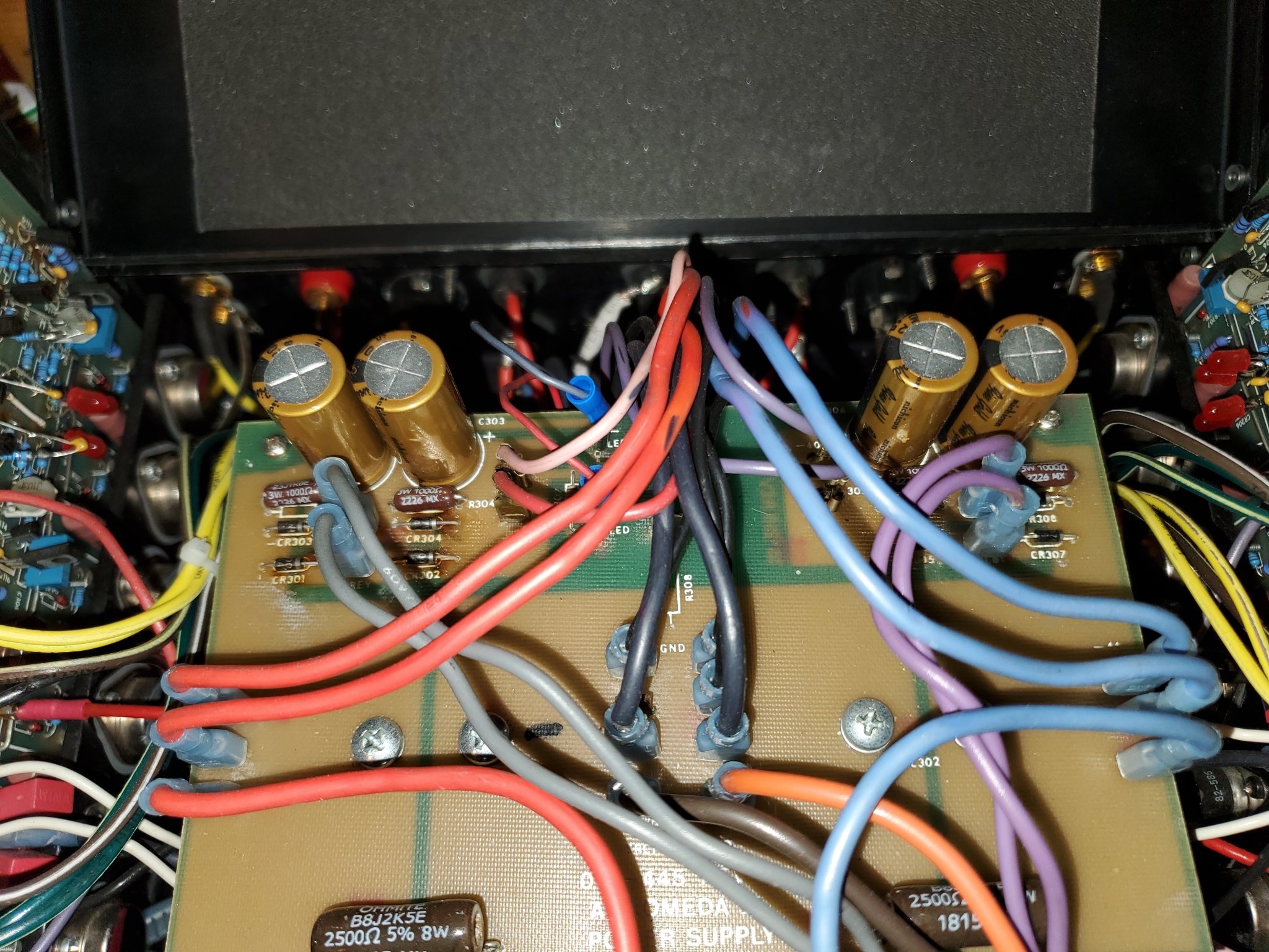

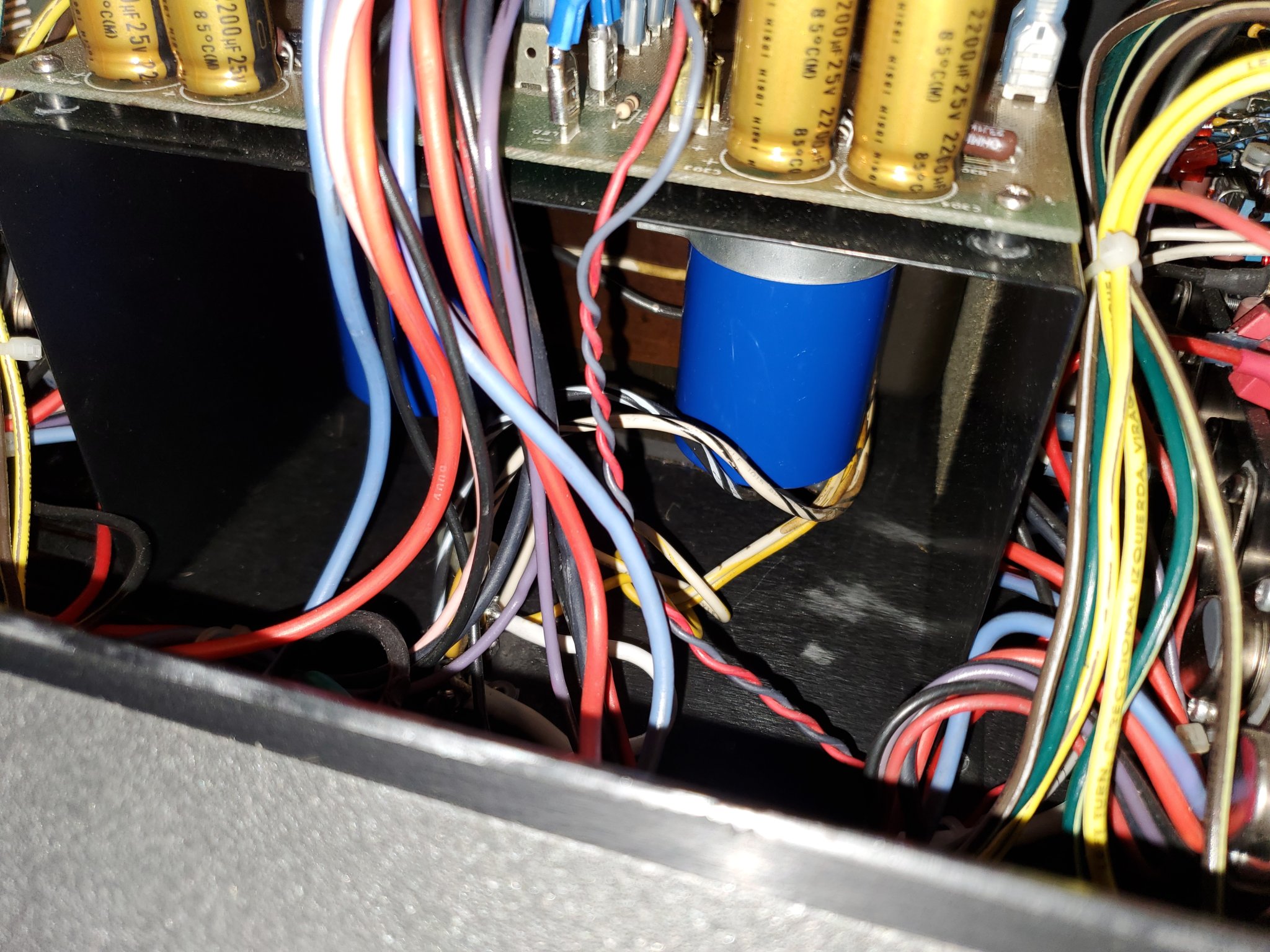

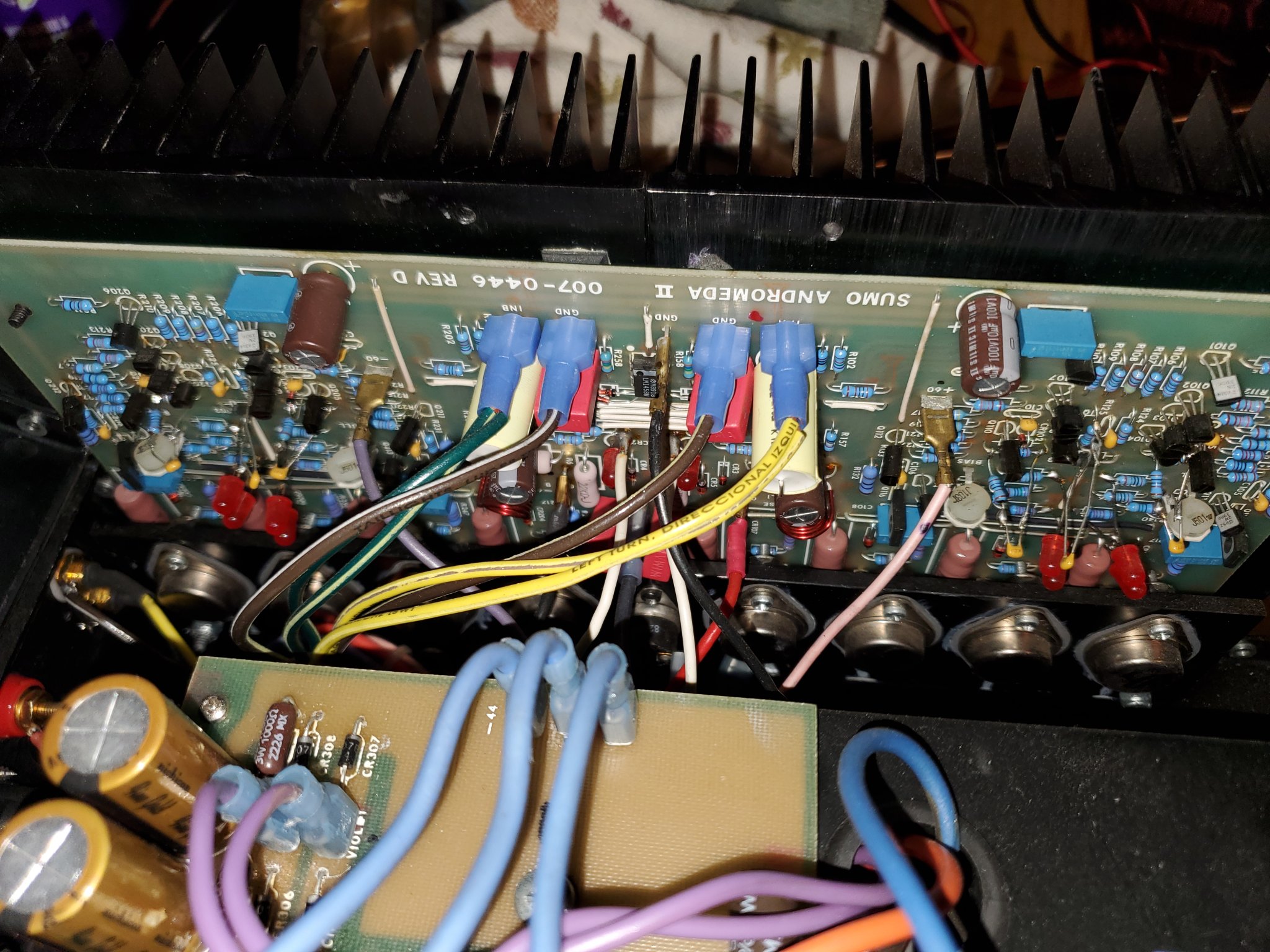

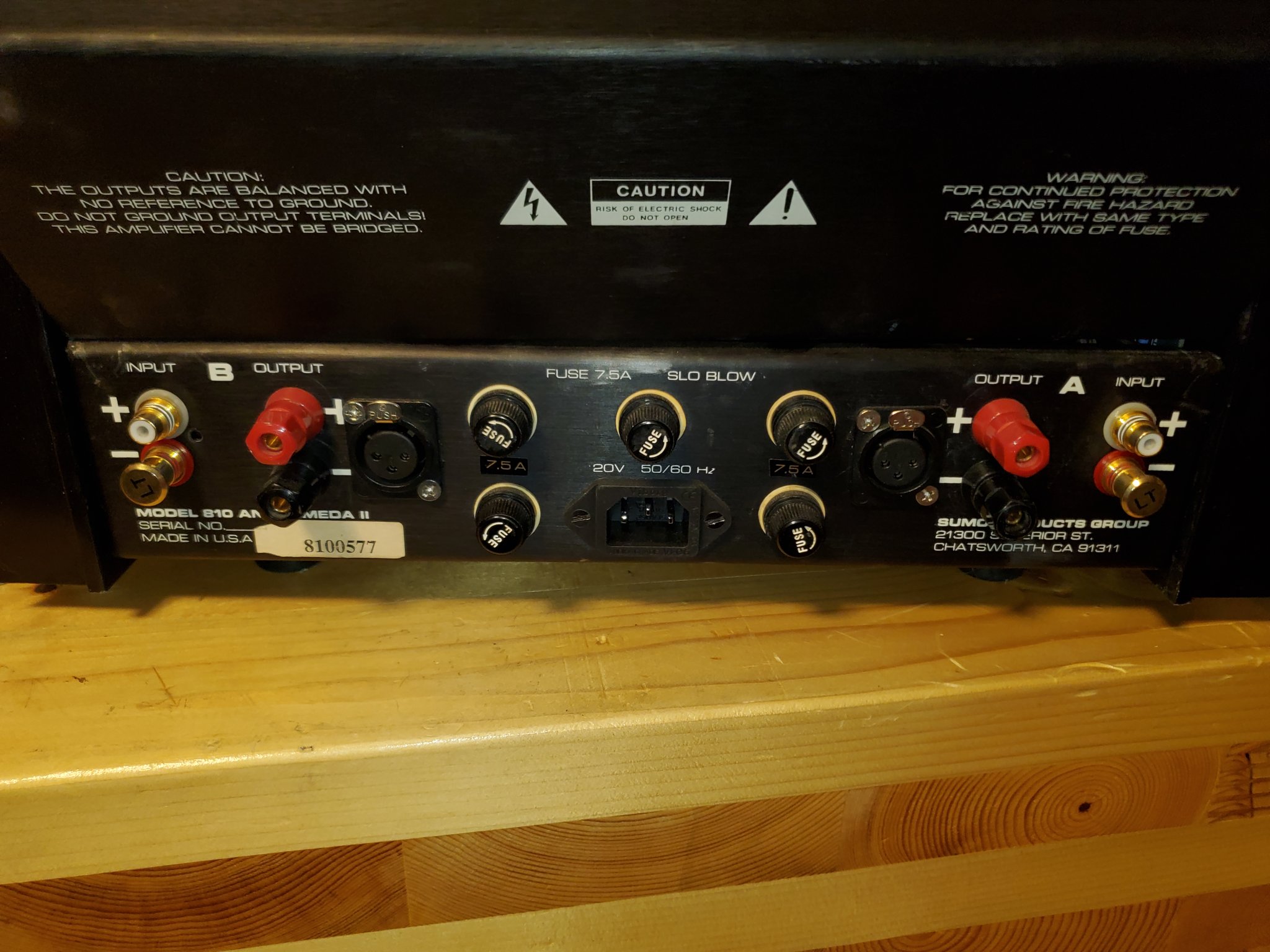

I have a sumo Andromeda ii that I picked up in a package deal. Seller said it needed work but didn't elaborate. I came across your thread while googling info on this amp. I'm thinking this a is a bigger project than I can handle. I've had a peak under the hood on this one and it looks like there's been significant work done on this one already. Let me know if you're interested.
I'm not sure how much work has been done there. As the D on the board says, there were several revisions to the Andromeda II. The later ones had TO-247 outputs instead of TO-3s. There are a number of added small caps here, but those may have been factory mods mid rev rather than alterations/repairs by a third party. Overall, from what I can see, it looks pretty good.
I have enough amplifiers at this point. I wouldn't mind some side gig repair work, but I recently moved to France, and am not yet settled, so that's really not an option right now.
No more details on what's wrong with the amp? Are any of the fuses blown?

There are currently no fuses in the amp. I haven't even attempted to replace fuses or power it on. I do have a DBT and a variac. So far the extent of my audio repair has been simple replacement of old components. I'm not knowledgeable with diagnosis and troubleshooting.
The main problem with this particular version is the TO-3 Mosfets, damn near impossible to find and very expensive if you do find them.

First things to check with a meter would be whether the gates of any of the output MOSFETs (or the Zeners that are across them) are shorted, and also whether any of the outputs are shorted case to source. If these are Motorola devices MTM20N10 and MTM20P10, IIRC, the best source I've found for small quantity replacements is UTSource.
BTW, it's possible that if the load was shorted, it overdrove the gates and shorted the Zeners while not blowing the outputs. It has not been my experience that that was actually the case, but it's theoretically possible, so, if you do find shorted gates, you should pull the outputs and see if they're OK out of circuit. Out of circuit, you can test a MOSFET with a meter: Ohms mode, use + and - leads to charge the gate and verify that the source/drain read short; then use - and + leads to discharge the gate, and verify that source/drain read open.
