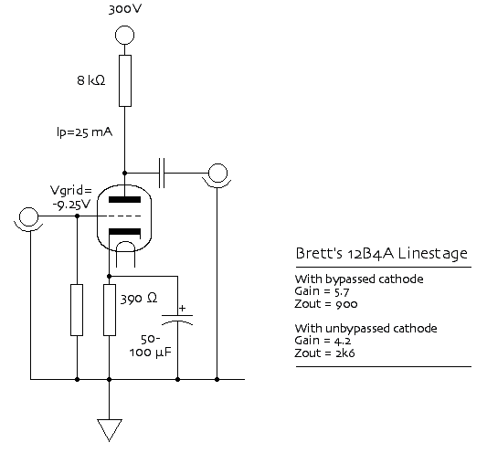

I can second Andrewbee's recommendation for the Vacuumstate FVP5 and the even better RTP3C, if you need phono. Should you only need line, then there's Frank's design or my little one; doesn't get much simpler than this.
FWIW, get over the idea of there being a 'best', it'll save a lot of tail chasing and sufferring searching for a mythical nirvana. You're either going to have to build a ton of circuits and decide for yourself, or just build something and be satisfied. Of all the pre's I've mentioned, I've actually built and use them all (FVP5A and RTP3C phono stages and the 12B4A line).

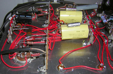

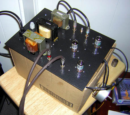

There are some interesting designs out there but try building a Rosenbilt Grounded Grid before you waste time on any of the others. I just built two of them and the results were astounding. Two variables in it are the output coupling cap and the feedback resistor. Use 5uf and 150K instead of what is called for. Also get 6189W's(Sylvania or G.E.) and you won't have the microphonic problem that most 12AU7's suffer from. Takes about a week to fully break in...... You will not be disappointed!
Mark
Yes, it drives as low as 300 ohms I believe. I'm driving a pair of Aleph 2's with mine. Total cost to build mine was around $100.00 U.S. even with the NOS 6189W's. I literally threw them together in about a day and a halfs time! I still have to make the wooden base.... just picked up some nice quater sawn oak for it. The attenuator is a nice old Daven "T" type that I converted to 50K ladder type.
Mark

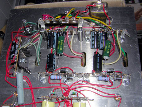

Power Supply end of things..... All wiring is silver plated OFC copper that is teflon insulated. No hum, no noise, no hiss! The star ground point is between the two output caps. It doesn't sound like typical tube or solid state circuit... very different and unique character all its own.
Mark
