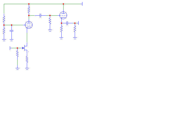

JoshK said:I just noticed this thread. Was working on projects last night. I like your ideas, they make sense. But I still have a question with regards to the grid resistance versus the cathode resistance. Didn't we want the load resistance low as well, or does it not matter?
Josh,
The I/P impedance of the cascode is in parallel with the 4.99 Ohm I/V resistor. Since that impedance is several orders of magnitude greater than the I/V resistor, it is effectively "invisible" to the DAC chip.
The O/P of the cascode presents its own issues. A DC coupled voltage follower is needed to buffer the high O/P impedance. Also, PSRR is non-existent in cascodes. So, the B+ must be WELL filtered and regulated.
Sheldon,
Your schematic is reasonably consistent with Allen Wright's phono section FET cascode.
Stopper resistors are needed on the FET's gate and the CF's grid. DC couple the CF's grid to the cascode and adjust its cathode resistor accordingly. Also, you left the low pass cap. across the I/V resistor out.
As Mr. Beck indicated, the gain of a cascode is tied to the transconductance of the lower element. The 10 KOhm load resistor value I gave was based on 6922 sections serving in both the top and bottom positions. A different value is needed with a FET in the bottom position.
The voltage divider that sets the cascode's idle current could be made a pot. A 100 Ohm Riken at the FET's drain would do double duty as a stopper and a test point.
I think this circuit has potential. AW's FET cascode is quiet enough for use with LOMC phono cartridges. The proverbial church mouse is noisier.
BTW, AW sells closely matched pairs of low noise JFETs. 🙂 "Just what the doctor ordered."

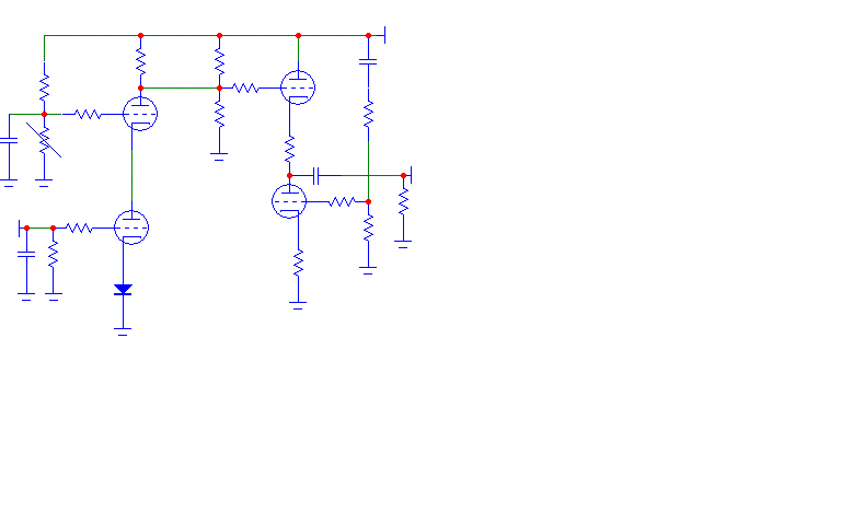

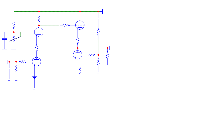

Sheldon said:Just thought experiments. How bout all tube:
All of this is "brainstorming", at least for now. 😉
Loose the grid stopper on the upper triode of the cascode. Remember, the upper triode in a cascode operates GG. The voltage divider at the buffer's I/P grid has to go too. Wire the ends of a pot. between B+ and ground and connect the wiper to the upper grid of the cascode. Put a 100 Ohm Riken between the cascode's lower plate and upper cathode, as a stopper/test point. LED bias for the cascode will work, but I prefer an unbypassed metal film resistor. Local current NFB from degeneration is (IMO) a good thing here. The cascode's load resistor gets tweaked to yield the amount of gain needed.
BTW, a 6922 for the cascode and an ECC99 for the buffer looks good to me.
Fixed the pot. The resistors on the buffer grid, Broskie adds as safety resistors, but I may have missapplied them. I left them out for clarity here. So more like this?
Edit: On further checking, realized that John has beat me to it (no surprise there). http://www.tubecad.com/2004/blog0013.htm
Sheldon said:Fixed the pot. The resistors on the buffer grid, Broskie adds as safety resistors, but I may have missapplied them. I left them out for clarity here. So more like this?
Getting close! There is no need for a fixed resistor connecting the "top" of the cascode's current set pot to B+. The value of the current set pot. should be no less than 1 MOhm. The cap. to ground gets connected directly to the upper triode's grid. Think GG!
PSRR in the White CF buffer is good enough to allow connection to well filtered, but unregulated B+. Reserving the regulator to feeding only the cascodes decouples the cascodes from the buffers.
