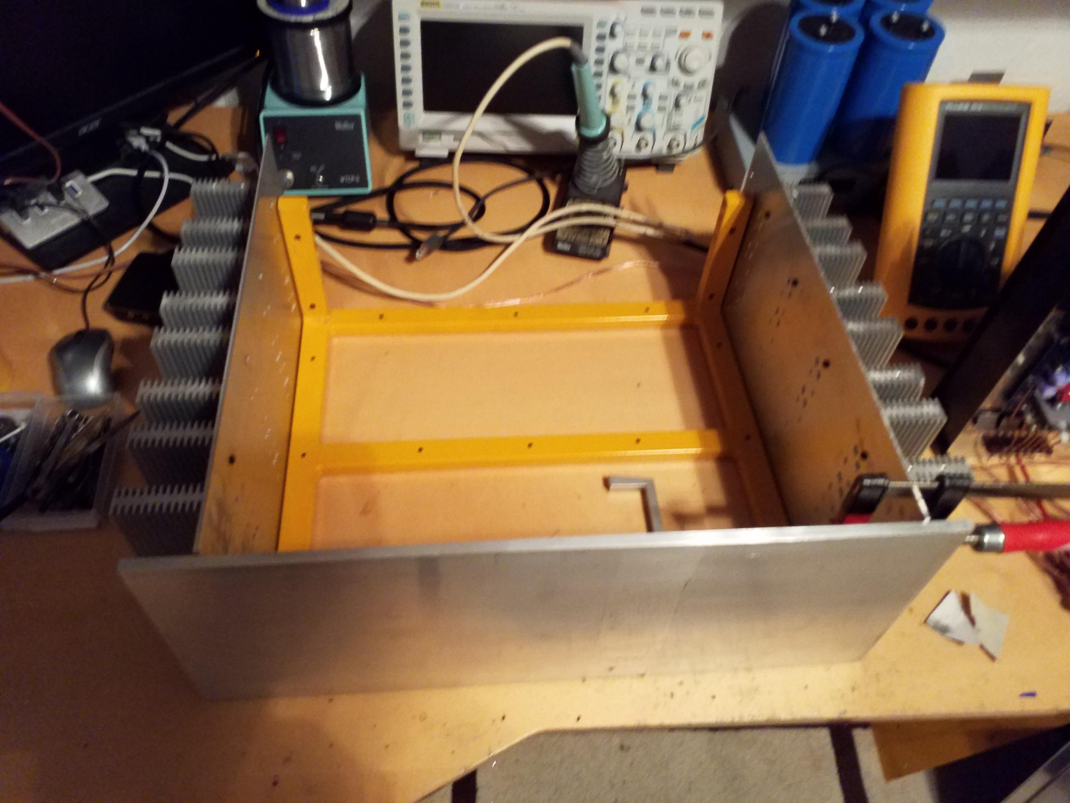

I'm also in the chassis process and will attempt using a router and carbide mills this weekend, I will not attempt lettering, but cut, smoothen and chamfering edges.
Aluminium is 3 and 8 mm, will also smoothen ends on heatsinks with router using a wooden contraption.

Be sure to wear protective gloves! Eye protection is only needed if you don't want to visit the emergency room! Ear protection when using a router can be avoided to allow you to save by no longer requiring tweeters after your hearing is damaged!!
Old clothes allow water based cutting fluid which is also nice to keep the aluminum from sticking to the bit.
Use at least two clamps to keep the work in place. It can be interesting to explain why there is a piece of metal sticking out of your body!
Don't ask how I learned all these tips. 😉

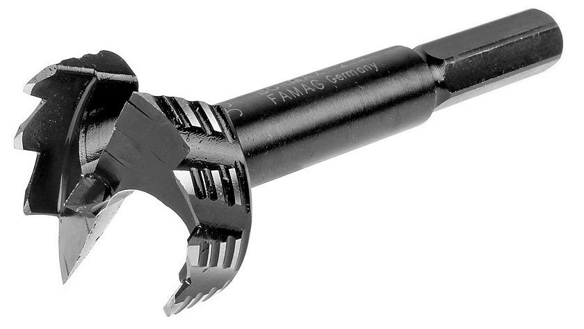

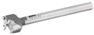

As simon7000 said be careful and take small bites, don’t climb cut. That said aluminum cuts fine with carbide tools. Forster bits will also work for flat bottomed spot faces.

What forstner-bit are you using? The average one, available through amaz., or rather pro-qualities with hard metal blades? (this or this)... aren't the blades wearing out quite quickly?Forster bits will also work for flat bottomed spot faces.

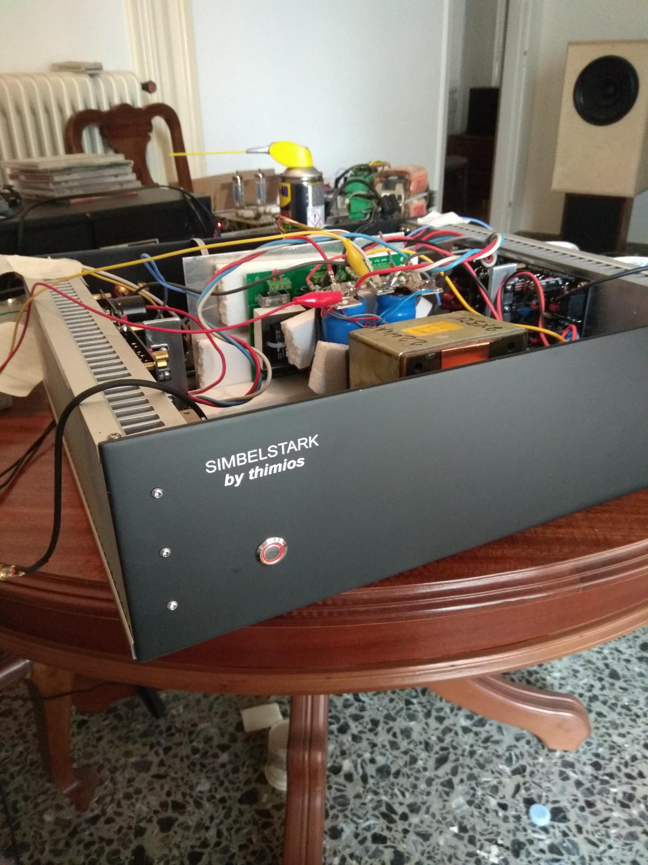

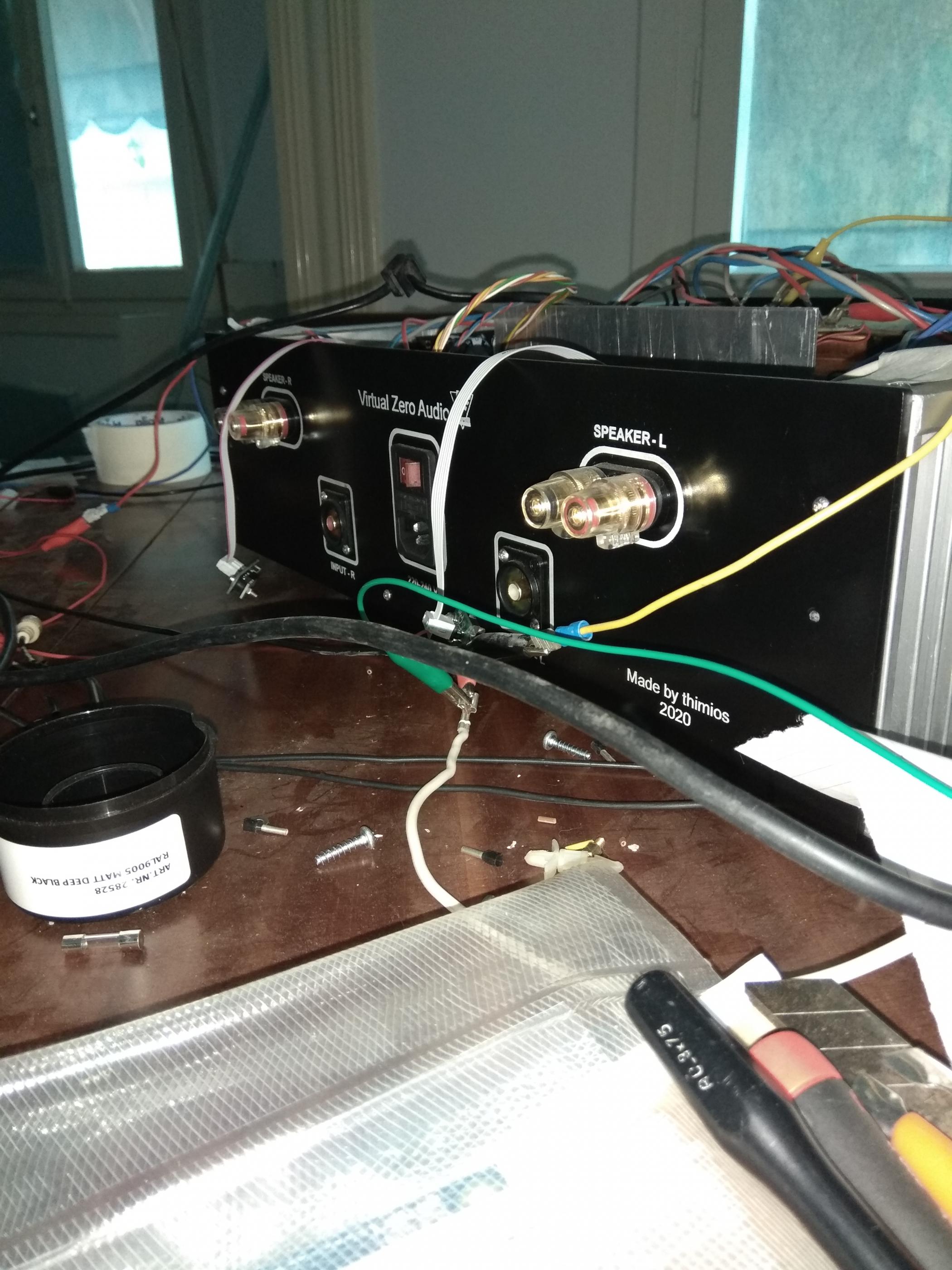

My good friend Dimitry have a laser engraving machine and always help me!

I want just to show the laser engraving methode.
Chose your own.

I guess the implied idea is: "laser engraving works, here´s an example, get a friend/shop to do it"These are two very good advices, which I will follow, but unfortunately Dimitry is too far away—and I don’t even know him
Which expands and confirms the earlier suggestion of using a Trophy engraving shop, which are relatively easy to find.
