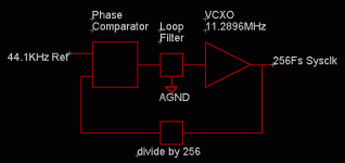

So, I want to rephrase my rather confusing first posting to a very simple one:
What is the best way (if any) to slave my beloved Philips CDD882 to an external word clock, preferably using the word clock output of my dCS Delius?

It seems to me, you have answered your own question.
Your CD882 requires at least 256Fs for its system clock. Your DAC produces a word clock signal, Fs. Clock injection and Sync Link invove sending 256Fs or greater. Therefore,given the need to derive 256Fs from the Fs reference, your only option is to install a clock multiplier of some sort e.g. a PLL.

As you definitely have noticed, I am just a stupid beginner, so I have to ask one more question: where can I find a schematic for this option or can you attach/send me one?Therefore,given the need to derive 256Fs from the Fs reference, your only option is to install a clock multiplier of some sort e.g. a PLL.

When I said that you had answered your own question,I meant that the parameters you had laid down pretty much defined your only option.
The basics of a pll based sync system are outlined in the diagram below and there a number of designs available on the net.
There is the service manual for the Pass Labs D1 and the Stax Talent BD1. Both of these designs have VCXO/PLL setups though not an external reference. They are pretty much the same thing as a setup with an external reference the only difference being the internal reference. The most useful design in this case, though, is probably the Guido Tent design,

I don't reject it. I simply followed on from the parameters you laid down. You have a Fs (44.1K) reference and you need to generate a 256Fs (11.2896MHz) clock signal. The other two setups need a 256Fs or higher reference and without modification the dCS won't provide this.
