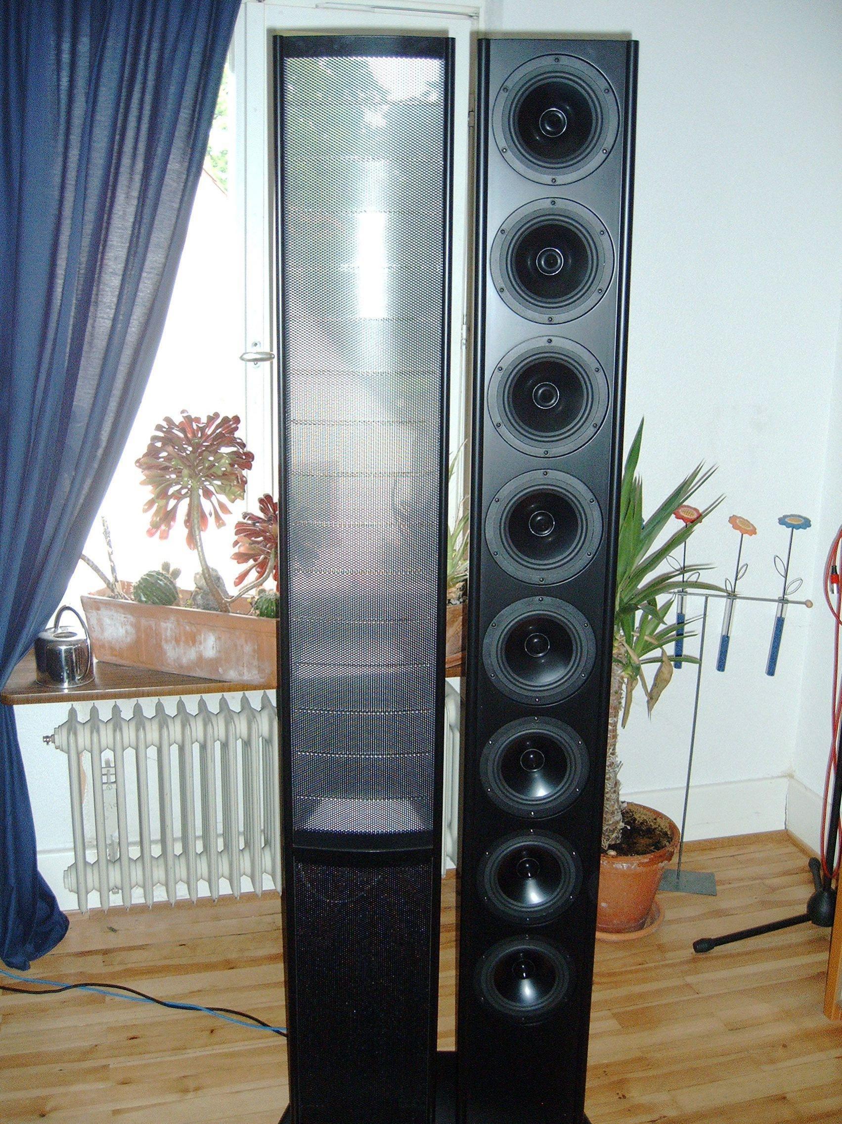

You may have seen my earlier prototypes with dipolar bass towers (with 8x 8" resp. 8x6.5") in close proximity to the panels with just a small slot to let air pass through. I never had any probs with air movement blowing the ESL-membrane into the stators. The main difference to Legis beeing the high mechanical tension of the membrane and as such a higher xover freq.
A steep xover flank also might help keeping the overlap of both branches small, but ML used monopolar distributing basses in close proximity with their panels and soft xover flanks without any issues. But they work with high xoverfreqs of 400-500Hz.
A dipolar bass is advantageous here because of its natural steep first rolloff (null), but does only allow for a xover of 250Hz or less
I´m afraid that there will be no really satiyfying solution as the system is. I assume that only a raise in Fs of the panel might help, eventually even with a third way filler-driver dipolar tower as in the Statement2 and my purist ESL -and I use a very powerful, potent woofer too.
All else wll probabely restrict heavily the possible dynamic range.
