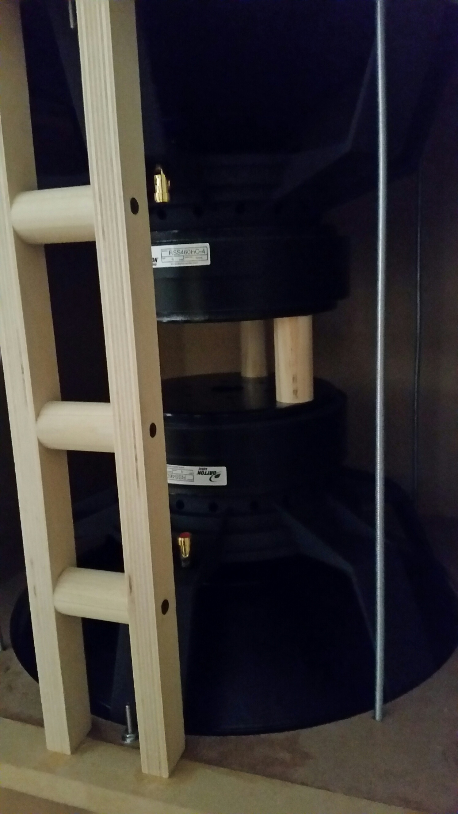

YOU MEAN LIKE THIS ?
I do apologize for the poor picture quality. This is a push-push, reaction-forced cancelling sub-woofer system using 2 Dayton 460Ho drivers.
It's not clearly visible, but 4 out of the 8 mounting holes have threaded rods in order to compress the 3 dowels that separate the magnet structures.
The "T" bridge in front serves to further add rigidity to the exit slot.
No need to apologize, the picture is clearly visible and you've solved the most important problems quite well like the distance between the drivers (looks okay from the picture), the driver spacers/connections and the baffle connection rods. I'd prefer wood for the baffle connection because of the much lower resonance but I think your solution works fine as well.
Every structual improvement is preferable, so thumbs up for that too. 🙂
