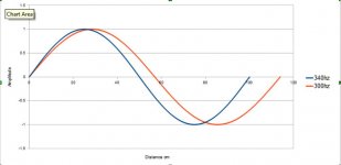

For a start the wave fronts that the different drive units are producing can only be truly coherent at one listening height. This is obvious when you think about it because moving up and down alters the relative distance that the sound waves have to travel from the tweeter and the woofer. This is why properly done coaxial drivers attract such a large following, as their vertical off axis response mirrors their horizontal off axis. That is (if properly designed) remaining flat and coherent as you go off axis, with only high frequency, beaming related droop showing. Rather then a non coaxial system that has the two drivers going in and out of phase with one another as you change the vertical listening axis, creating dips and troughs all over the place.

In other words the variation in the acoustic centre is represented in the phase response you take when you measure the driver, thus this is factored into the crossover design (it'd have to be otherwise we'd end up with unpredictable results!).
Acoustic phase and electrical phase are one and the same thing. If you delay the electrical signal by 1ms, it's exactly the same as moving the driver backwards 34cm (all things being equal). We are not altering the waveform (hopefully) with either form of 'delay' we're simply delaying the onset of the wave front.
A driver has a natural acoustic response, this contains variations in both phase (the relative acoustic centre) and amplitude. An electrical filter also posses the same properties (linear phase filters not withstanding!). The drivers acoustic properties aren't going to change once the cabinet design has been finalised and it's up to the delay imparted by the electrical filter to phase align the drivers present in the system.

Lets look at this from a different perspective.
The measurement of phase during the design process is simply a representation of any of the delay characteristics that the driver itself represents. Phase in itself doesn't naturally exist and is something that we as humans have invented as a way of usefully describing this delay. Or, we have invented as a way of describing the relative delay between a fixed reference point and something that we are specifically interested in. The measured phase and it's described time delay are by nature frequency dependant, as the wavelength and thus the time of the delay, changes with respect to its given frequency. I think this is what you were saying in your last paragraph, but in a different way?
I must admit I am not technically minded when it comes to the mathematical proof or theory of how all of this is exactly working and I am not quite sure how you calculate or physically describe the reason for the acoustic centre shifting. According to Vance this isn't simply the acoustic centre shifting, as pinkmouse described, with respect to the part of the cone the sound is radiating from, there's more to it then that. But it could simply be describing how the phase of the driver shifts with respect to the fixed microphone position and as the phase measurement is frequency dependant, we see a phase shift re/ frequency.
Vance then goes on to say that for most intents and purposes one can assume that the driver radiates from a point just in front of the voice coil. He also goes on to say that any variations in the acoustic centre are made academic once the filter is in place. This makes sense as the role of the filter is to bring the two drivers into phase alignment. Although I think it should be noted that this is only around the crossover point.
Obviously the two drivers on a stepped baffle could be physically aligned so that when filter-less, the region between 1-3khz could be decently coherent. However once you filter the drivers this physical alignment would be wrong. Now of course you could start to go for asymmetric slopes to bring them into phase alignment, or you could keep your symmetric slopes and physically move the tweeter to bring the drivers back into phase with one another. This was the point I was trying to get at earlier, where the required physical offset for the tweeter is entirely dependant on the xover used.
Does that make sense?
The kind of thing I'm visualising, although this cannot quite describe what's going on, is something like this.
Where we could take the origin to equal the microphone position. The loudspeaker would be placed 1 meter away, which would correspond to the wavelength of a 340hz wave. Then as we use a 300hz wave, the wavelength is obviously longer and further away then 1 meter. The mic position cannot change as this is our reference point, so as a result the calculated acoustic centre moves by X and that would be represented in degrees in some way on a phase plot.
A point radiator in a fixed position with frequency dependent phase is a simpler approximation of a real driver than a point radiator with frequency dependent position. At least if you're trying to model the time domain behavior over a large solid angle. It's not, however, generally sufficient to consider the driver's lowpass characteristic and breakup. The highpass from suspension resonance and enclosure behavior affects the phase response as well and is more difficult to deal with as it's lower in frequency and hence requires larger physical offset or places greater demands on analog or digital correction. The audibility threshold for group delay rises significantly in the bass so this isn't as much of a problem as it might initially seem. But it's been my experience linearizing phase below 40Hz produces small but pleasing improvement.
