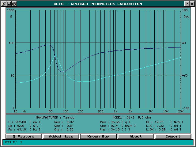

Hmmm A kingdom royal is an odd Tannoy.
Best Tannoys were the Alnico powered dual concentric drivers... period.
The quality would be coming mostly from a well engineered XO filter
and not from a magnet type. Once had a chance to test a T12 (3142 unit)
product so I've played with different XO filters and the original didn't seem
anything like clarity, nowhere near that actually. So, one could think that driver
might be the cause of it.
