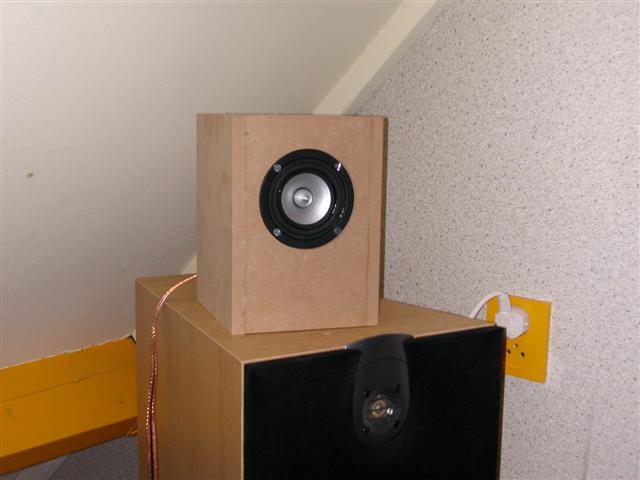

Last week I built a pair of seales speakers with one Tangband W3-871S each. They sound marvelous! I really like them but they lack in the lower frequencies.
I could build a vented speaker with them ofcourse but I'm affraid it will exceed the xmax way too soon then.
Do you perhaps have a suggestion of a 5"/6.5" woofer to match them nicely?
I do live in the Netherlands, so Radioshack/Dayton isn't really a possibility for me. I will have to stick to the major brands here.. (Visaton, Vifa, Peerless etc)
Also (yeah I'm picky 😛) I would like not to exceed the 30liters (+/- 1.05 cubic feet) and spend way over 50 Euro's on each driver.
Thanks for your help 🙂

Peerless offers low priced drivers and they are leaders in bass application. I guess a pair of 6.5'' woof would be more than enough to match those TB you got there....
I agree with Guss. Peerless is the leader when it comes to accurate and powerful bass in moderate-sized enclosures, and their Classic 5" and 6-1/2" woofers should be more than adequate at a good, low price.

Definitively the 6.5inch

Again, I'd agree with Guss and would recommend the 6.5" over the 5" just for its better bass performance. Heck, I'd recommend a Peerless 8" model, that is if you don't mind it being slightly "slower" than the 6.5" and occupy more space.

Construction details aren't really complicated 😀 I went to a local DIY shop and had 18mm MDF (3/4") sawed into the right sizes for me. Then I put them together with a nice amount of fast-drying wood-glue and some clamps.
The holes for the units were made with a circle-jig and a router.
For dampening, I bought a sheet of BAF (dacron, artificial wool) and glued some to all the sides so it was almost filled.
It doesn't include any baffle step compensation. Only a notch filter to take away a bump in the middle frequencies.
