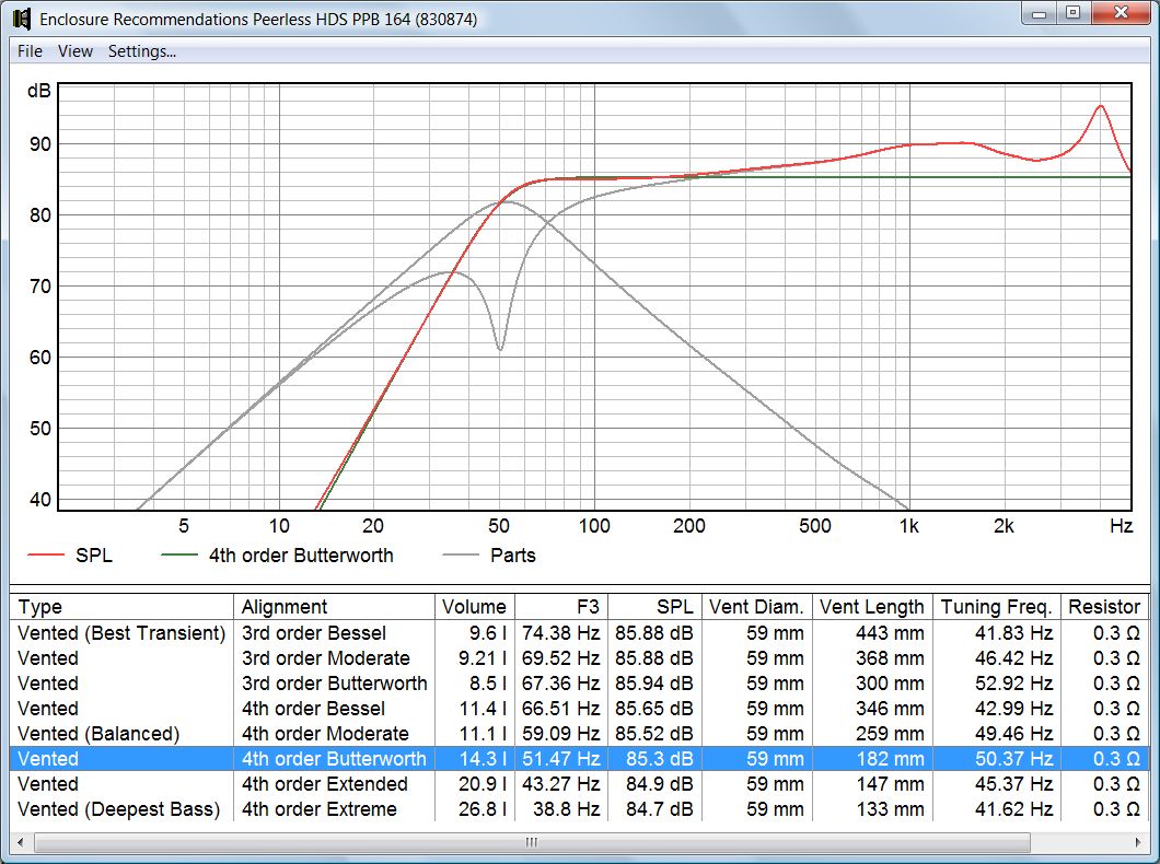

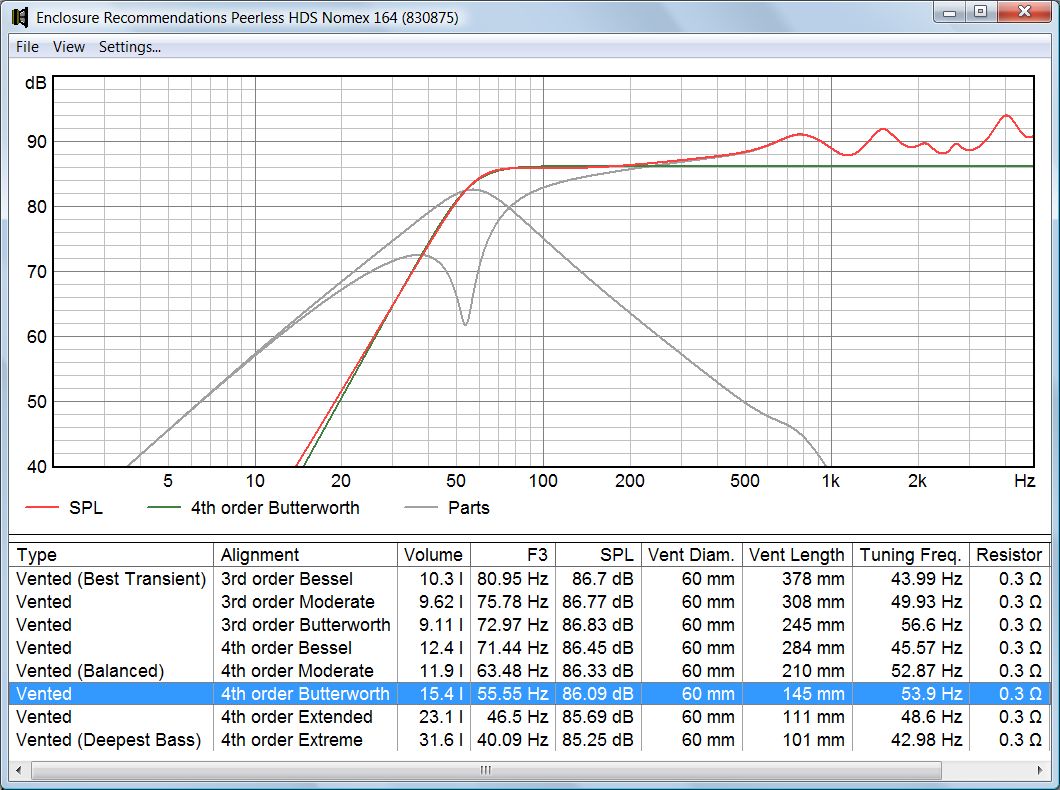

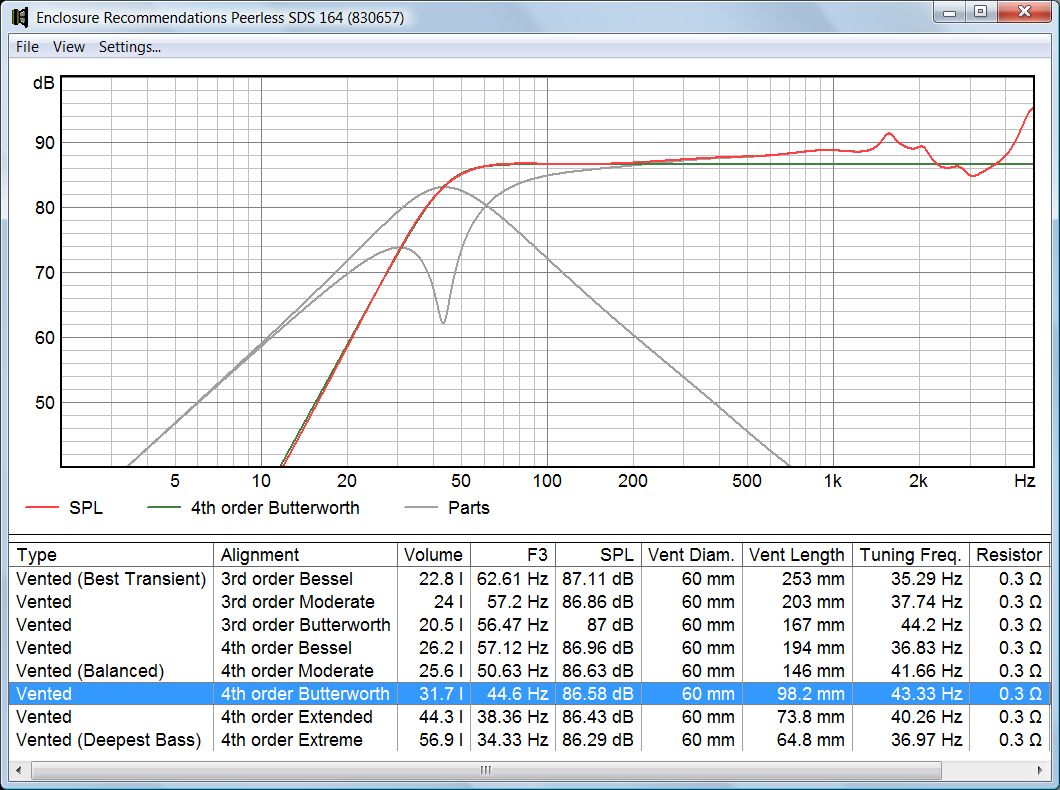

Stay with the Peerless SDS 164 drivers. Going smaller is no option, you will not gain anything. The equal sized drivers from the Nomex and PPB line offer lower distortions and more Xmax, but they actually do not outperform the SDS regarding bass performance at a given transient response!
