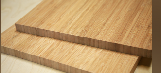

That looks like nice bamboo. There different "grades" or quality levels. I would expect that to be quite well behaved.

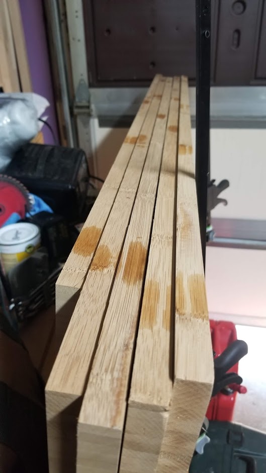

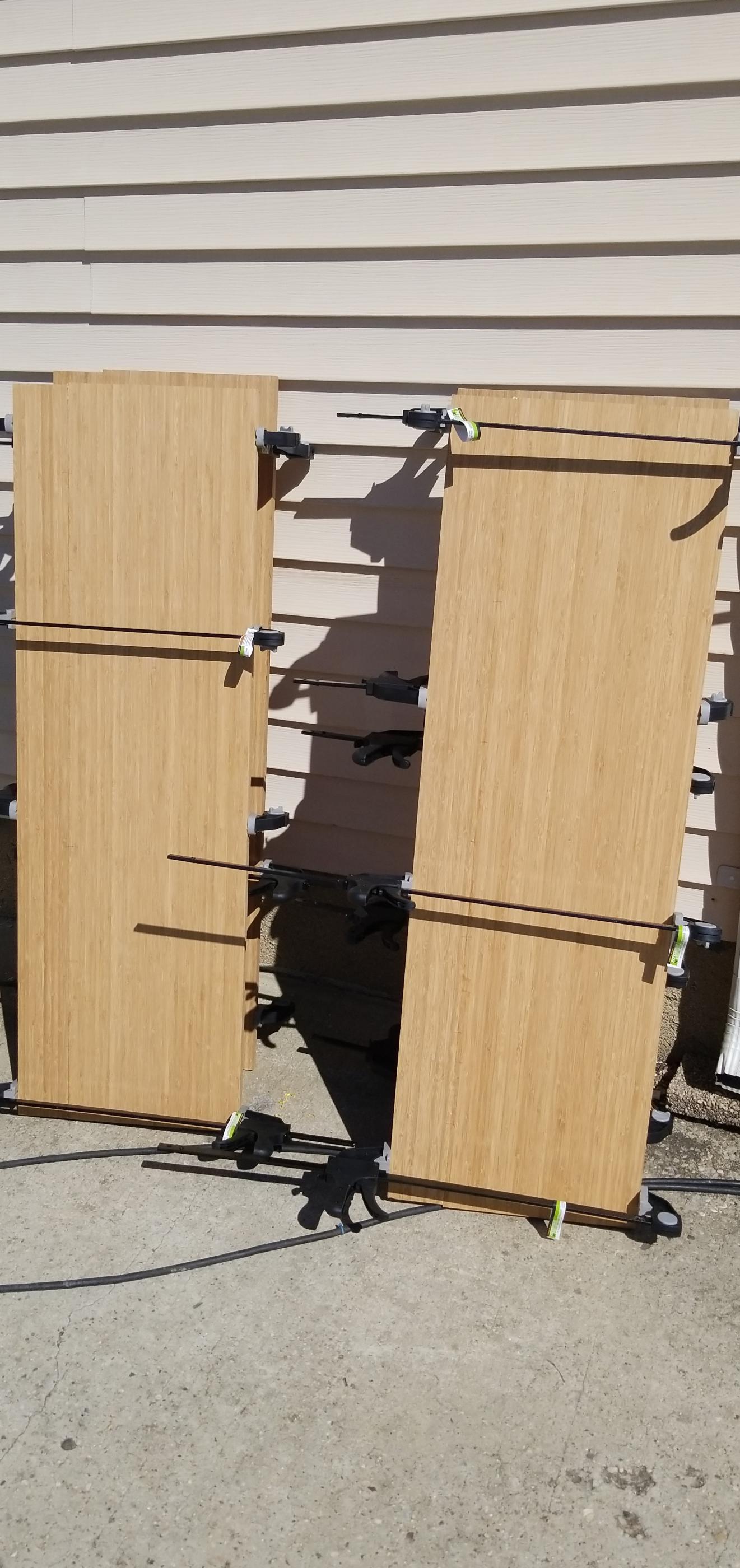

Amazing material the boo.. Amzing and strange at the same time... This weekend I extended the 12" wide panels to 15.5" At glue up, the bamboo acted dry and certainly wicked in the tight-bond as any dry stock usually does.... After clamping, I stood the boards up against the sunny side of my house. Started on the next panel, and before gluing up that one returned to the one that was setting up to scrape the glue off as it was in the rubbery stage... Turned the boards around every 20 min so the sun wasn't beating on only one side, just to be sure I wouldn't get any warping... Thes boards were in the sun, on a 60deg dry day for at least 5 hours....
This morning I puled the clamps off and strange, there were what looks to be damp spots where the clamps were.. Oddly, the material feels dry, acted dry, but there is no other explanation as to how the spots showed up only under the clamps... Came home from work today, some 9 hours later and huh!? What I thought was damp spots are STILL there ??
So... moisture or don't want to think but could it be a chemical ?
I have to dig out my moisture meter, and find what setting I should use for boo, but I feel like Im working with something from another planet...
Strange times indeed!

There could be a chemical reaction between the bamboo and the iron in your clamps causing the stain. Try it again with scraps and place a wooden block or caul between the bamboo and the clamp face. See if it happens then.
FWIW, I’ve been using small offcuts of laminated bamboo boards similar to photo in AudioFanMan post #6 above as cutting boards and trivets in kitchen for at least 10 years, and while they regularly get wiped down with vinegar/water solution and left to air dry, they’ve yet to warp or delam at glue lines, which is more than can be said for the Boos Block Maple board.
