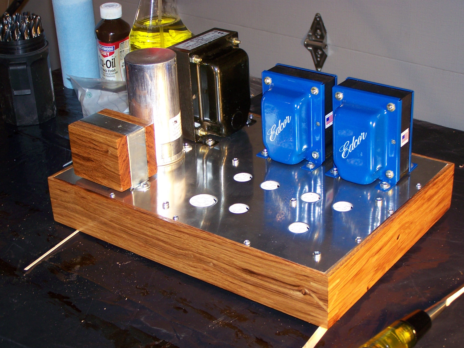

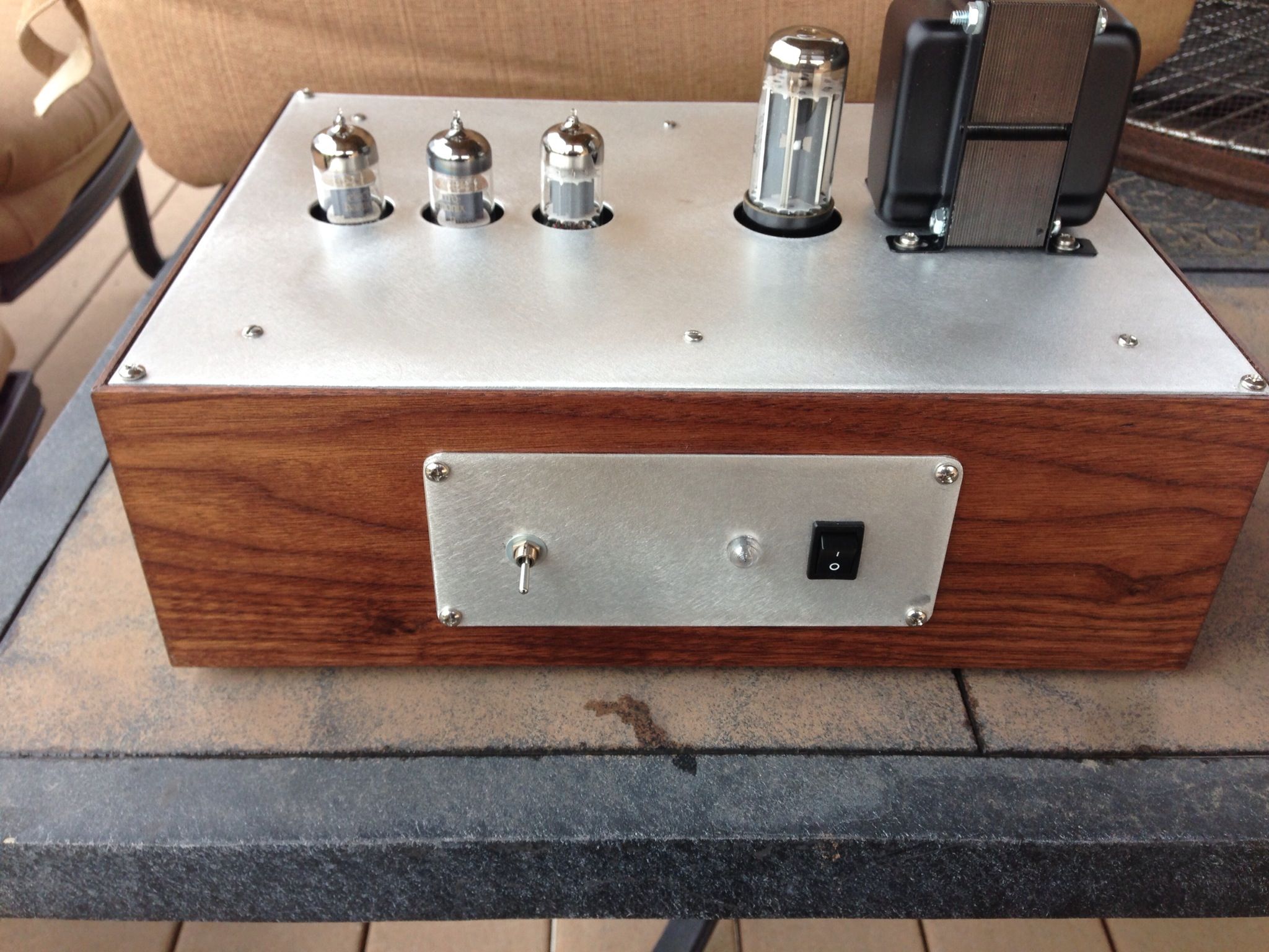

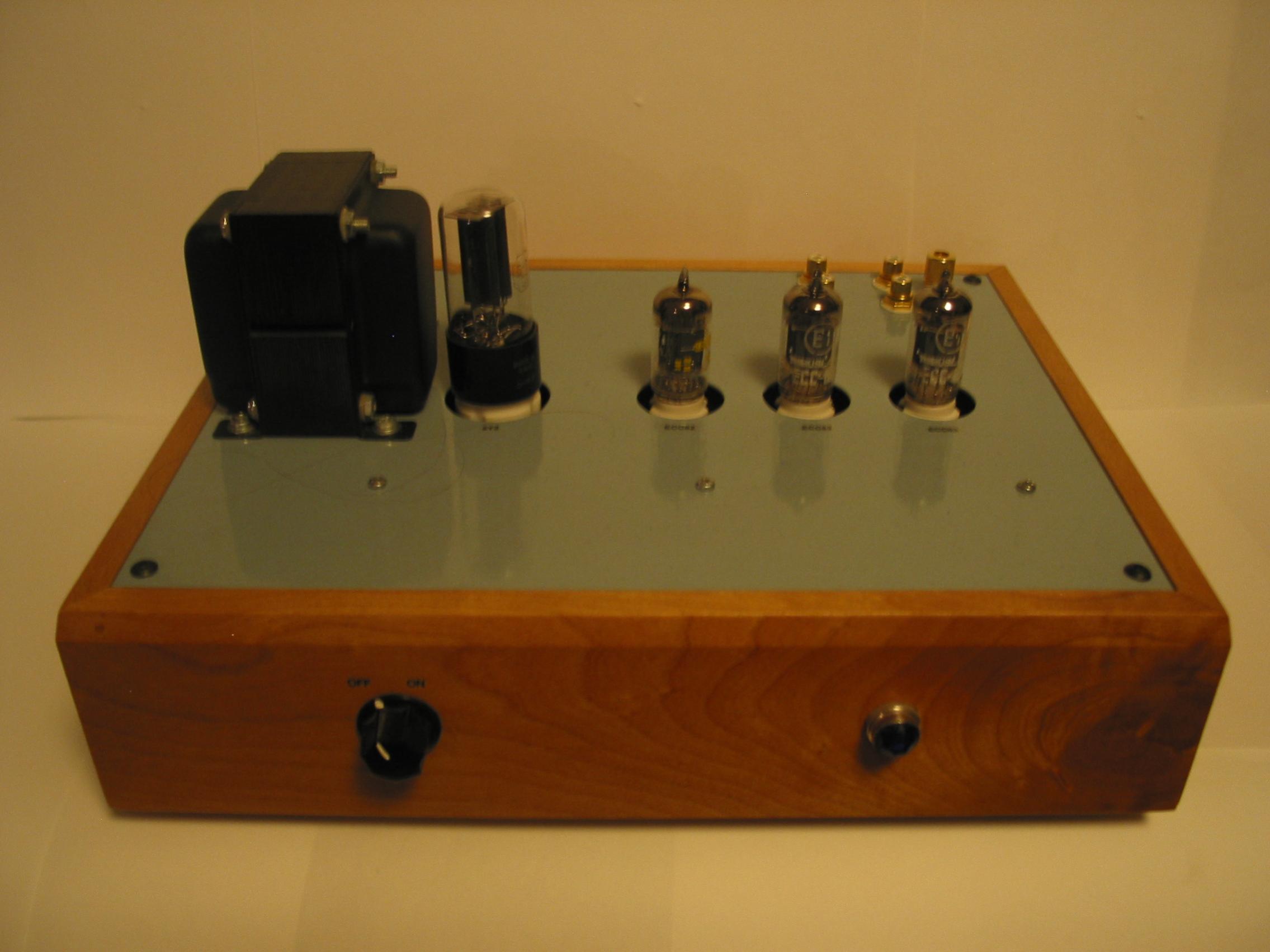

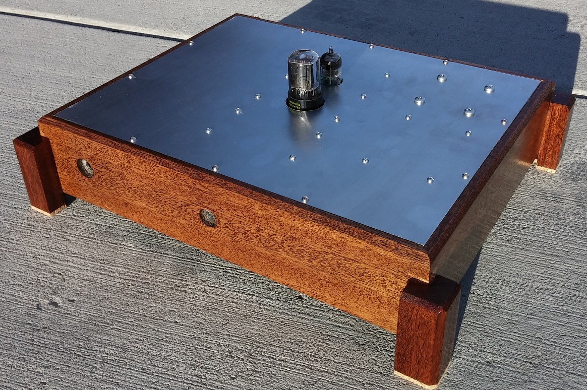

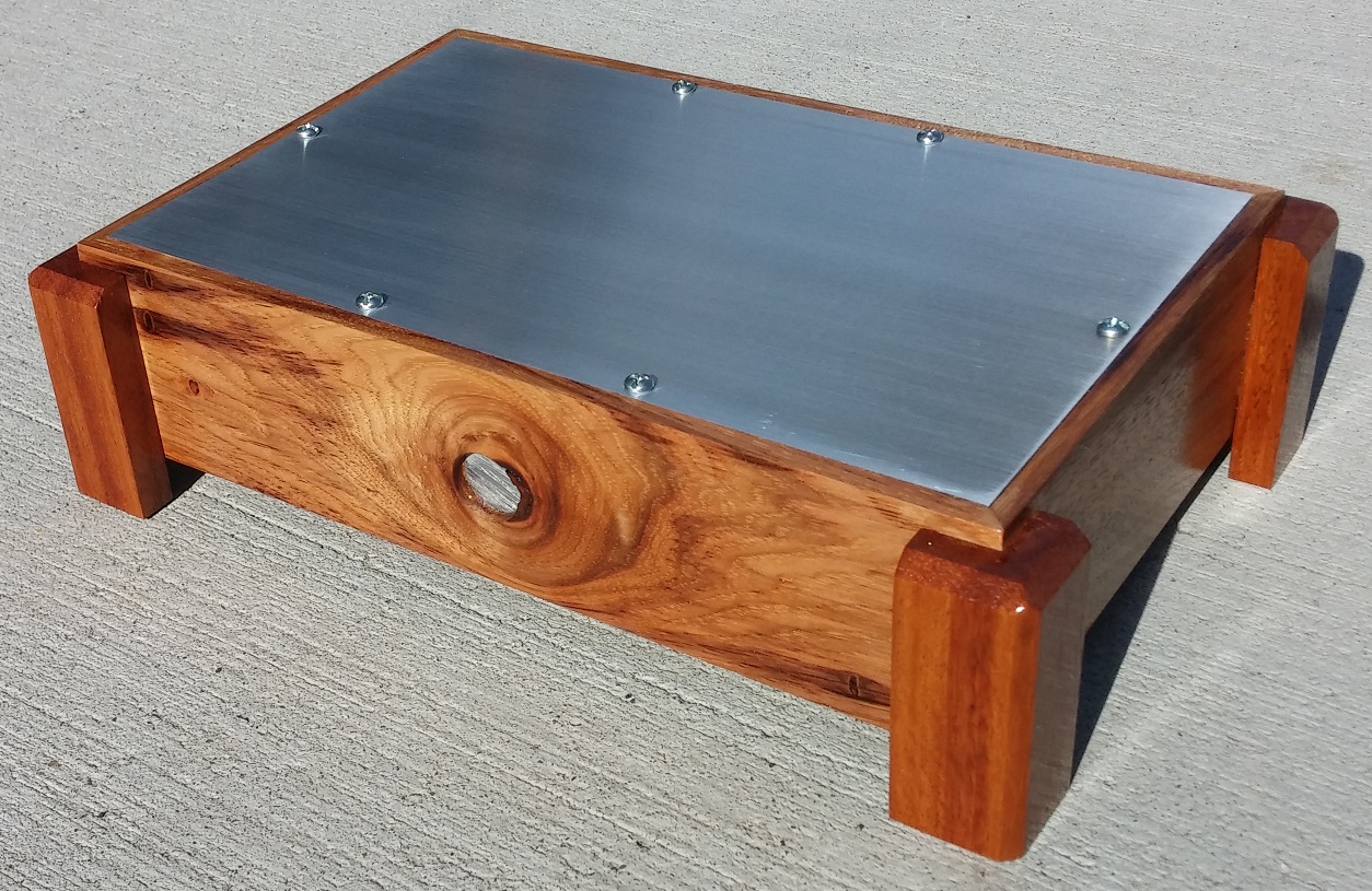

If you look through the photo thread, I think you'll find most (I'm sure at least 1/2) of the projects are built as you describe.. Wood side, aluminum plate for the top.

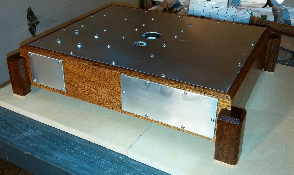

I've had no problems with noise in the phono-pre amp I build. You do need to ground (back to your star point) all metal plates. And I found it's easier to finish the aluminum with about 400 grit in your random orbital sander then trying to keep it polished. I'm like you, do a lot of wood working - but not much metal work.
