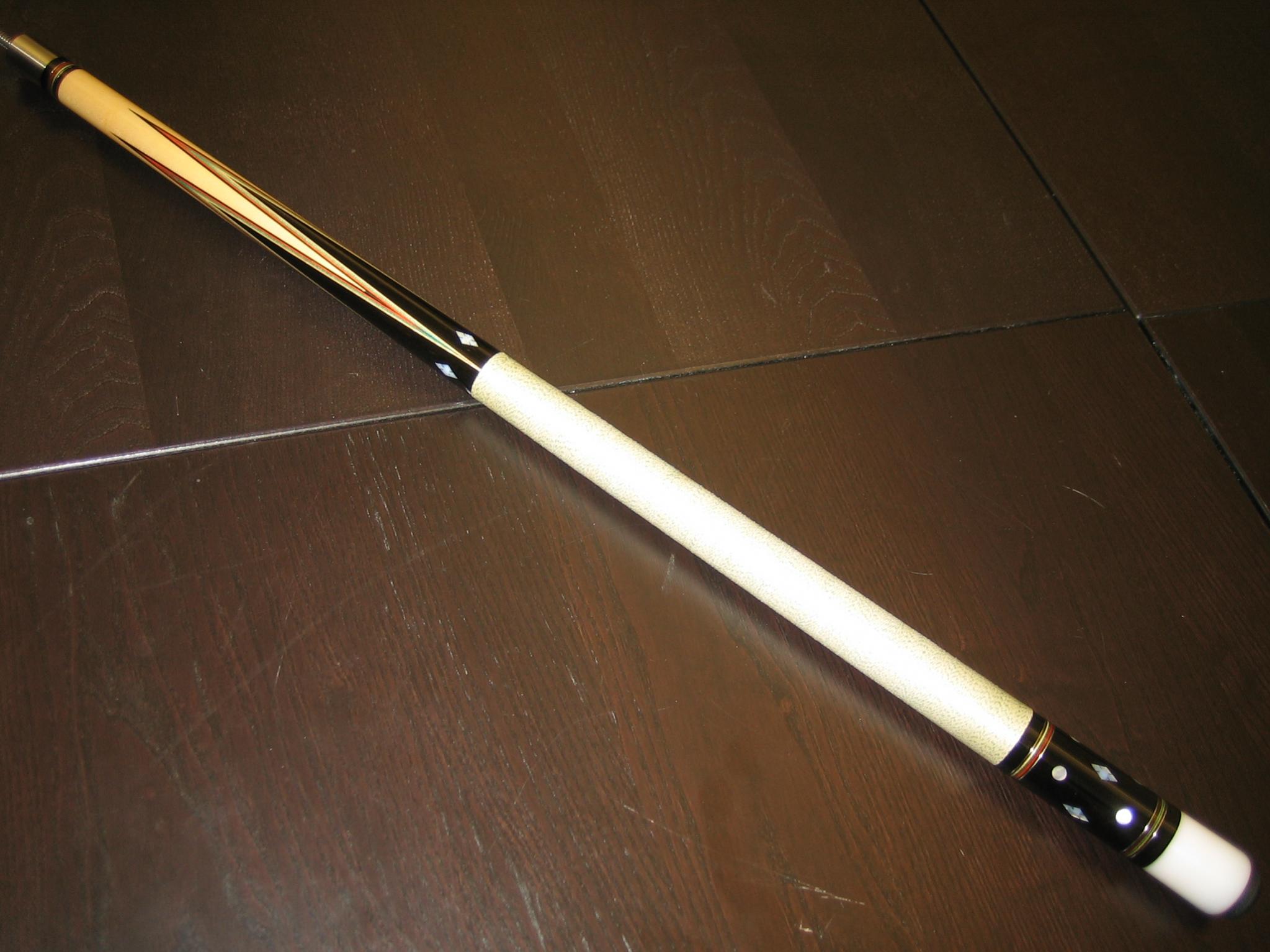

[I have done a solid Daphne blue bass recently and a few of my pool cues in clear before that for recent history] Pic of the last cue I did attached.
