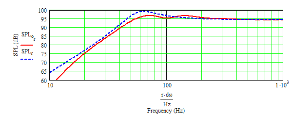

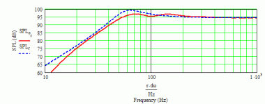

I modeled a couple of cabinet designs in WinISD and wasn't too pleased with the results. Any good ideas? BIBs maybe? I have some T/S parameters if that helps.
Due to its high Qts, it's best suited for either OB or aperiodic loading. Here's a max flat impedance ~aperiodic end loaded TL:
L = 45.5"
WxD = ~202.5"^2
All dims i.d. and the sim reflects a 1.2 lbs/ft^3 polyfil stuffing density:

Thanks GM. I'm new to speaker building. Given the specs how do I figure out the dimensions? What might be the best way to design the aperiodic port?
You're welcome!
Think of a transmission line (TL) as a vented box where the vent was sized so large that the box/vent system morphed into one large, long tube, so the 'vent' area = WxD area and can either be in the form of an open bottom with the TL spaced up off the floor or one big cutout on one of its sides or its area divided up into smaller slots on more than one side. Since it's end loaded, the driver will be at the extreme top front.
Since wider baffles are typically better performing overall and since there will be considerable stuffing to smooth it out there's no need to worry about any strong internal standing waves (eigenmodes) to reflect back through the driver, so you can either make it a visually pleasing ratio or as narrow/wide as the driver dims allows. IOW choose one dimension and divide it into 202.5"^2 to find the other one, rounding them up to the next convenient fraction if required.
To make it ~aperiodic (damp its resonant pipe modes), we stuff it with some type of absorbent material till it sounds as good as you can get it with the understanding that it may take considerable experimentation to find the right material and/or amount (density) of stuffing to find an acceptable balance between it sounding too under-damped (resonant) Vs too over-damped ('dead').

OK. Feel free to point me to further reading if these questions are too elementary.
So I can build a cabinet with inside dimensions of (HxWxD) 45.5x22.5x9. Correct? What size would the port be or is it just an open bottom that is elevated off of the floor? If the latter is the case then I could vary the elevation to vary the resistance of the port.

Correct.
Right, previously: "......so the 'vent' area = WxD area and can either be in the form of an open bottom with the TL spaced up off the floor or one big cutout on one of its sides or its area divided up into smaller slots on more than one side."
So if in the bottom front or back, then the cutout would be 9" high if full width.
FWIW, I calc ~4.93" = no resistance for bottom firing.
GM

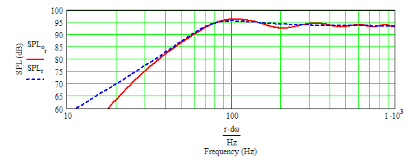

GM said:Don't have specs for the LT-12, only LS-12........
GM
THe LT12 and LS12 are pretty close. Here's some parms---
From a box design POV, not even close. The LT 12 requires a considerably larger cab, so using the 'worst case' of the two:
L = 93.875"
WxD = ~321.886"^2
All dims i.d. and the sim reflects a 1.0 lb/ft^3 polyfil stuffing density. Fold it in half with the driver down 10" from top and the vent at the other end with the same position options as the LS8 TL:
