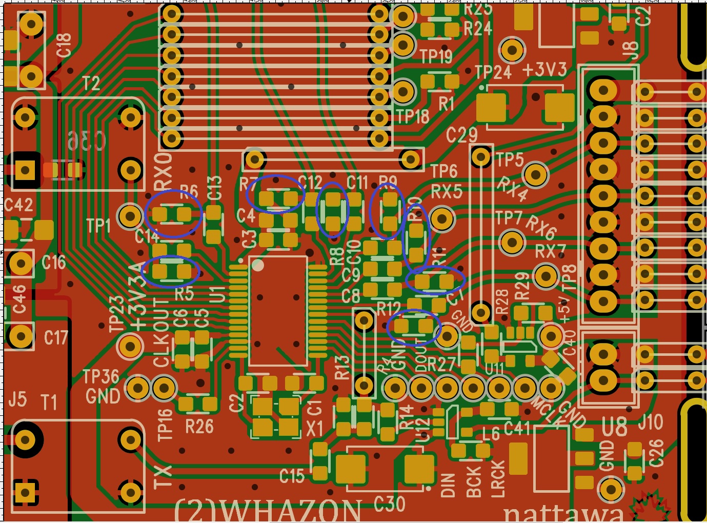

WM8805 needs a bit of "help" if wished to receive streams of sample rate higher than 96K, namely 176.4K and 192K.
This is because in order to lock onto a 192K sample rate stream, WM8805's internal PLL must start to operate at a different set of division parameters (PLL_K and PLL_N) than a common set of parameters that's good for all other sample rates, yet ironically, WM8805 is unable to tell a 192K incoming stream from a 176.4K one, and therefore, unable to decide by itself when to switch to the correct set of PLL parameters.
The data sheet has no info about how the PLL parameter switching are handled in hardware mode. I would then hazard a guess that it is not handled at all, hence the chip would stick with one set of parameters, which is good for up to 176.4K, and ditch the support to 192K.
In my Whazon Spdif switch project (software mode operation), an Arduino Nano micro-controller helps by clocking the recovered LRCK cycle period and then accordingly, loading the control registers with proper set of PLL parameters. This seems to be the only way of getting WM8805 to reliably operate on 192K and all other supported sample rates.

Did you happen to have the terminating resistor placed away from the WM8805? did you have the PCB traces sized for correct impedance? Just trying to rule out something obvious without seeing your layout. Attached is how I placed the 75-R terminating resistors around the S/pdif input pins that I don't think could be bettered much on a 2-layer layout. Rs and Cs in this layout are 0805 size.
