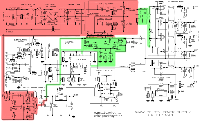

You can modify most AT and ATX power supplies to get 17V instead of 12V by changing the value of two or three resistors in the regulation loop and replacing 16V filter capacitors by 25V ones. The typical 40:7 turns ratio of their transformers makes that possible.
hmm...that's interesting...this mod it good only for 17V or also for higher voltages?do you have a link or something where to find something explained in detail?
Here is a reperesentative ATX schematic. The resistor Eva refers to is the one next to the word "Feedback", valued at 27K. I can't make out its designation, but I think it says "Rfb". Change this to a higher value, or even better yet, put a 10K pot in series with it, and adjust it up to the desired +17V.
As there are literally hundreds of AT & ATX schematics, this is a representation ONLY. (Your mileage may vary. 😀 )
Of course, this is predicated on the notion that you have changed C20, the 1000uF cap to a 25V unit, FIRST.

There is actually more stuff to change, since the voltage of the rest of the outputs will increase proportionally too. There are two ways to handle that, either to remove all the components associated to the other outputs, or to modify the +5V feedback resistor, the overvoltage protection networks and check that all the capacitors can handle the increased voltage. The former is usually the easier solution.
