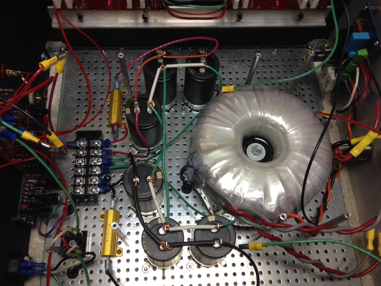

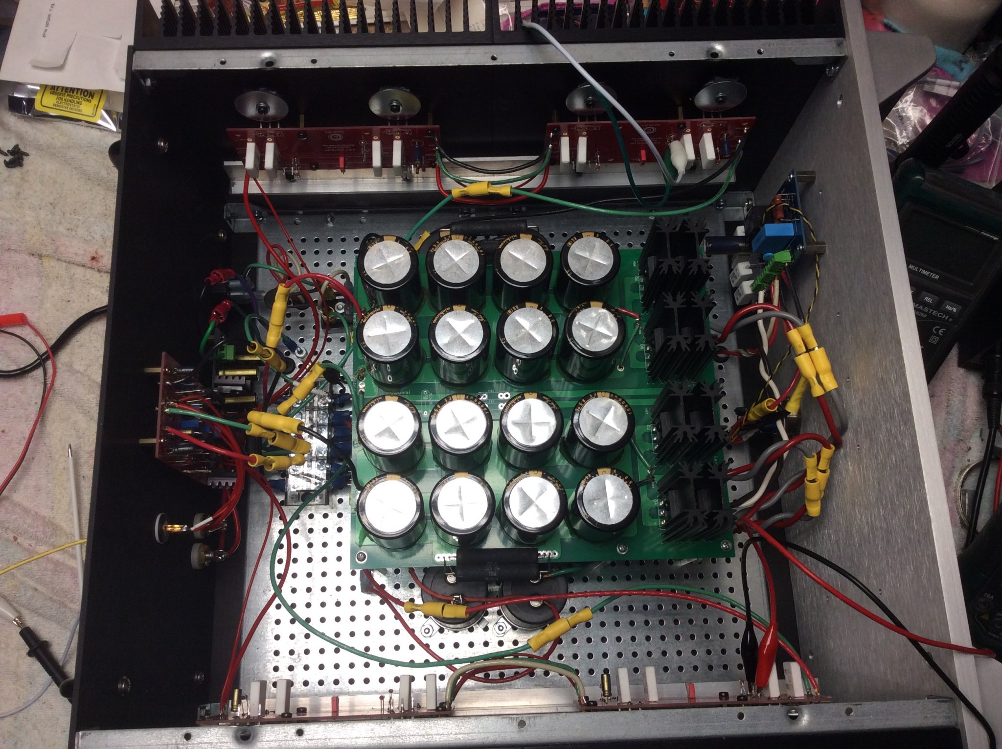

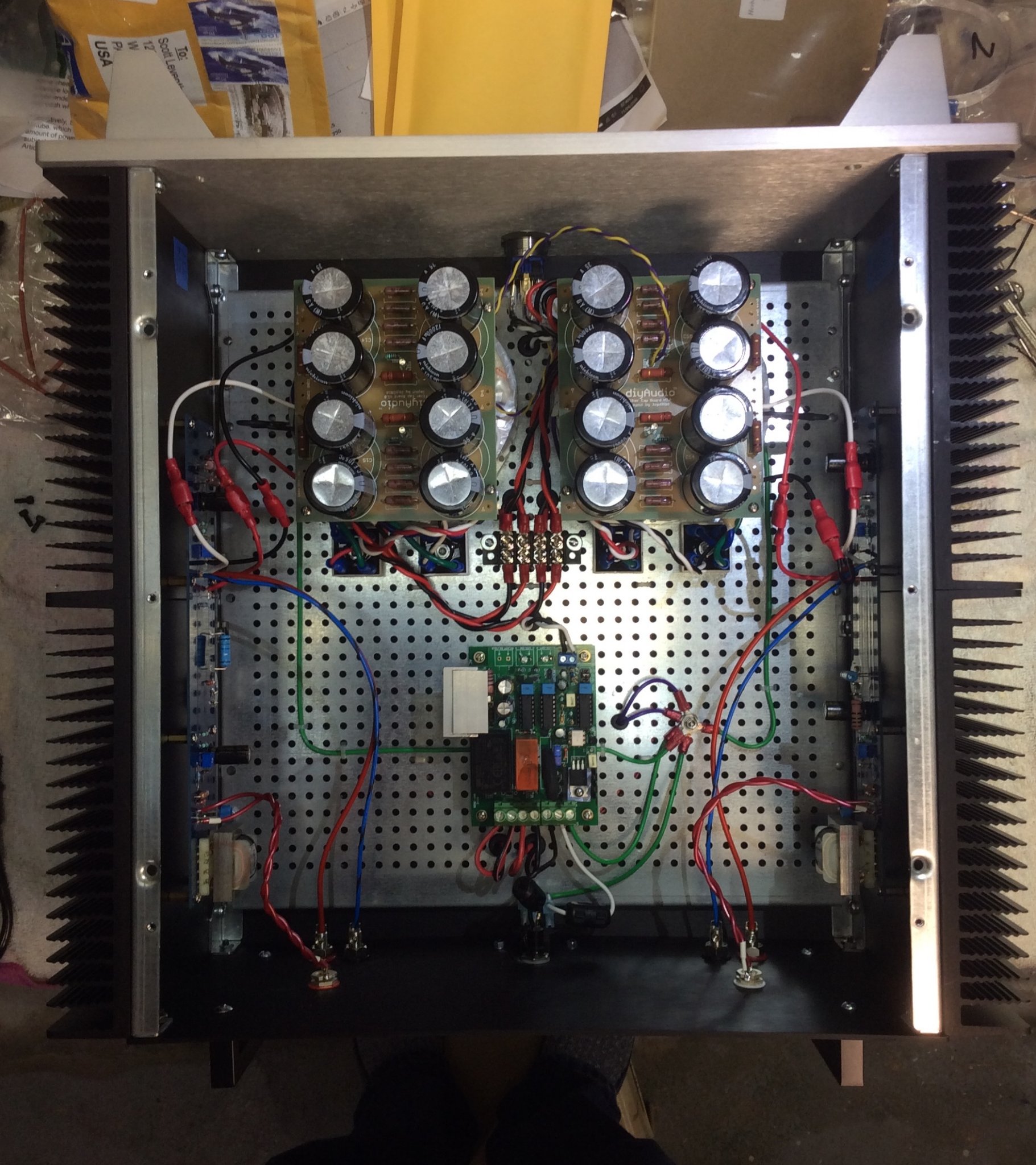

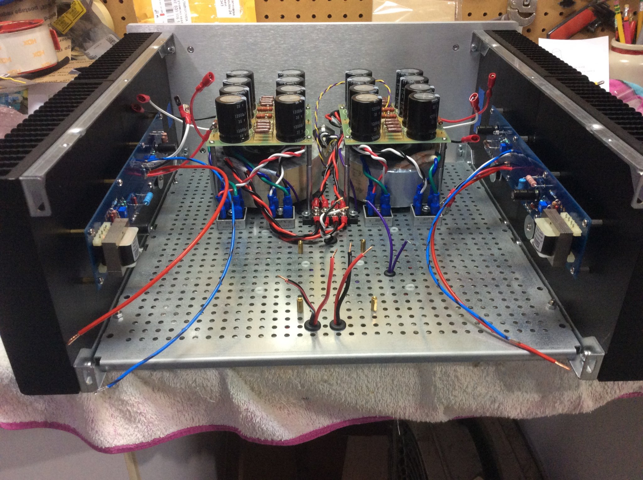

Bruce:
In that case, proceed with the power supply board you already have. There is nothing wrong with it. If possible, try to orient the board in such a way that provides extra space for additional capacitors (assume they will be mounted by clamps to the bottom panel). 132,000 uF in power supply capacitance is more than Nelson's original design suggests, but I've found that Nelson's proposed power supplies tend to be a little anemic; in my limited experience (F5T V3 mono blocks, F5T V2 and F6 amps) increasing total power supply capacitance by about 50-60% more than the schematic indicates results in far better bottom end performance, no bloat and no adverse impact on the speed of the amp. Your mileage may vary, of course, but why not leave room for experimentation down the line?
Here are two photos of one of my V3 amps and two photos of my F6.
Good luck!
Scott

Class D Audio's website is very lacking on information for their power supply board. However from looking at the picture on their website, it does not look equivalent to the typical First Watt power supply. Furthermore power supply requirements for a Class D amplifier are less demanding than that of a Class A amplifier such as a First Watt F6.
Just looking at the picture the bridge rectifier is small, not heat sinked, and just looks undersized compared to what is typically used in First Watt amplifiers.
The power supply filtering appears to be capacitance only, whereas the typical First Watt supply has a Pi filter, with capacitance, resistance, capacitance. The Pi filter supply is much more effective in suppressing ripple.
I suggest you cut your losses and build a power supply using the diyAudio board. The capacitors that you already have can be used in the diyAudio board.
If you have questions you should post them in the F6 Illustrated Build Guide thread in the Pass Labs Forum. First Watt builders are plentiful there so you will get for quick and informative responses.
