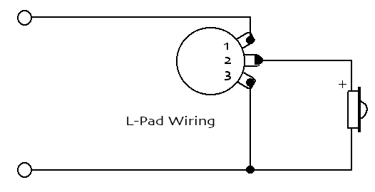

I'm a bit confused. I'm making a 2 way, 12db crossover (Linkwitz-Riley) with a crossover point @ 2500 hertz (2.5k) I know that I must reverse the tweeter leads on this particular crossover to correct for phase.
My question is this: how (and where) do I wire in the L-pad I'm using to attenuate the horn? Is it before the High Pass filter, (where the wires are still out of phase) or after I've reversed the wires?😕

Dave,
thanks for the quick response and attachment....so just to clarify, according to the drawing, the #1 lead on the L-Pad is what USED to be a tweeter negative, but is NOW the positive?
