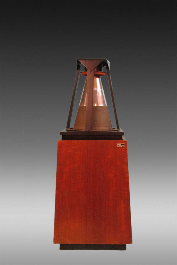

I have a refurbished Ohm Walsh F that I am playing around with adding additional BG Neo tweeters to. A Neo8 is pointing towards the listener, and a Neo3 is pointing towards the ceiling.
I have yet to wire all three together. The Neo8 is currently connected in parallel through the internals of an Aperion Audio Super Tweeter (5 Ohm). My plan is to use this to dial in what caps/resistors I need, and then build a similar crossover.

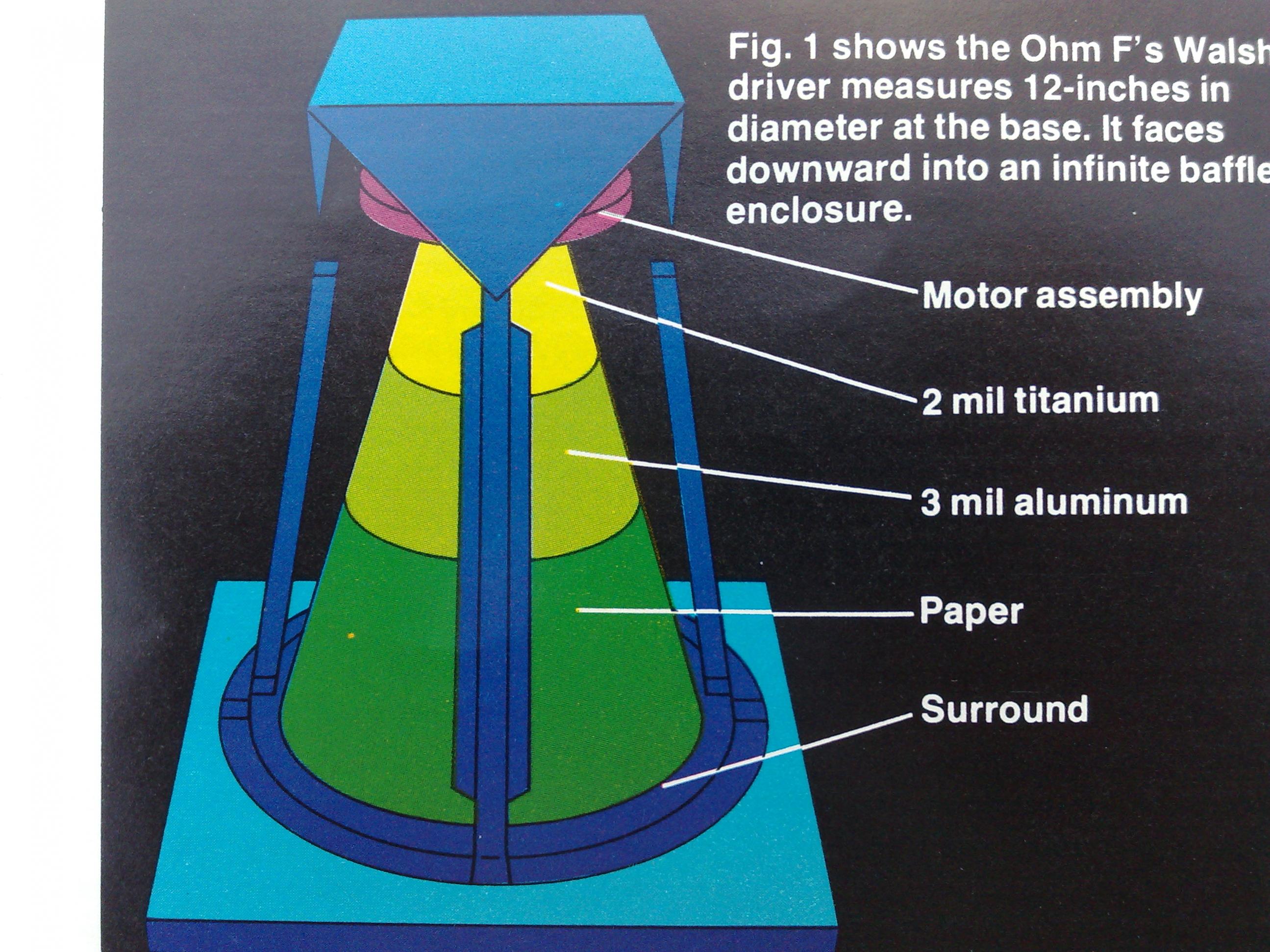

The Ohm F uses a bespoke 12” inverted omnidirectional driver operating from 35-17,000 Hz. As such, the Ohm F does not include a tweeter.
Sarsicism would appear to want to add tweeters while adhering to the omnidirectional principle. I presume he perceives the Ohm Fs to be lacking in treble.

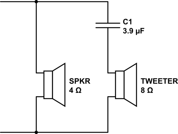

O.K. Wire the two tweeters in series to give 8Ω. Then use a simple 2nd order crossover to drive the combination.
This will require a 0.18mH inductor in parallel with the tweeter combination and a 1.5μF NP capacitor in series with that combination. This will give a crossover frequency of around 7,000Hz.
If the tweeters are too loud you can add an L-pad attenuator between the LC crossover and the tweeter combination.
This should work well. A more complex crosover would not be suitable for your application.
Thank you... so the tweeters in series with each other, and that in parallel with the main driver?
