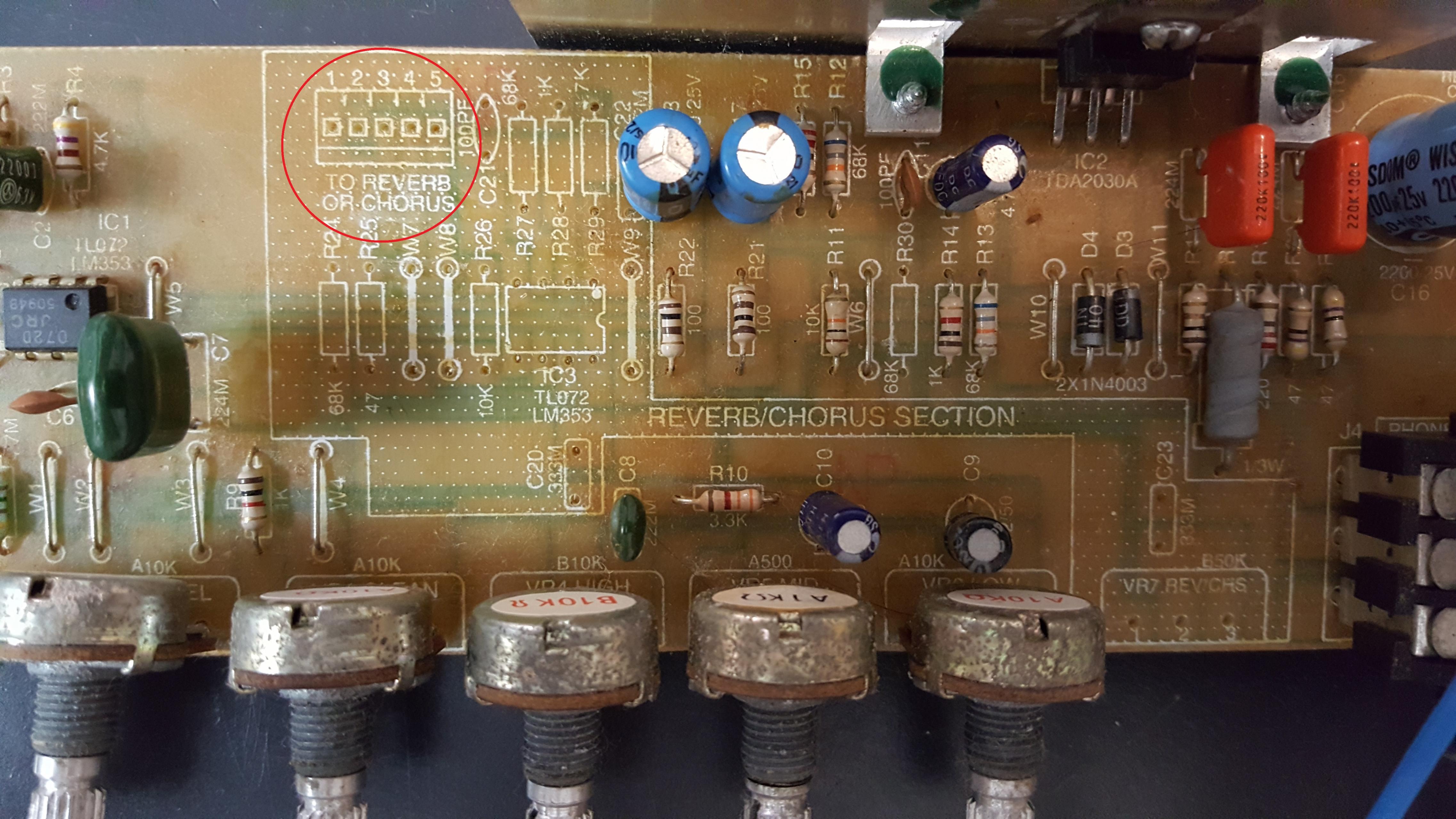

Hi everyone. I have this old Kustom amp that I would like to add the components for the "reverb/chorus" section. I am confused on what to do with "to reverb or chorus" area I have circled in the attached picture. I thought it was some sort of IC but doesn't seem to be. Could anyone explain what I need to buy and also what is meant by "reverb or chorus".....I thought reverb and chorus were two separate sounds and can you achieve both or is it a pick one kind of thing. Thanks so much.
Reverb and chorus is another way of saying effects in and out or send and return.
You will need to consult the service manual for a complete list of parts but the part circled is an IDC plug to handle send and return signals.
Agree, it is a connector that was wired off to something off board, either a reverb pan or some sort of chorus module.
What is the model of your amp? They used the same board for several models, not all of which needed all the parts. If we have that schematic, there is a good chance the alternative circuits are included on it.
As the 8-pin chip is a standard dual op-amp, population of the missing parts will give you neither reverb nor chorus without external reberb/chorus modules.
I believe it is a KLA20R. Just an old practice amp I was wanting to tinker with. If anyone knows where I can find schematics that would be awesome.
