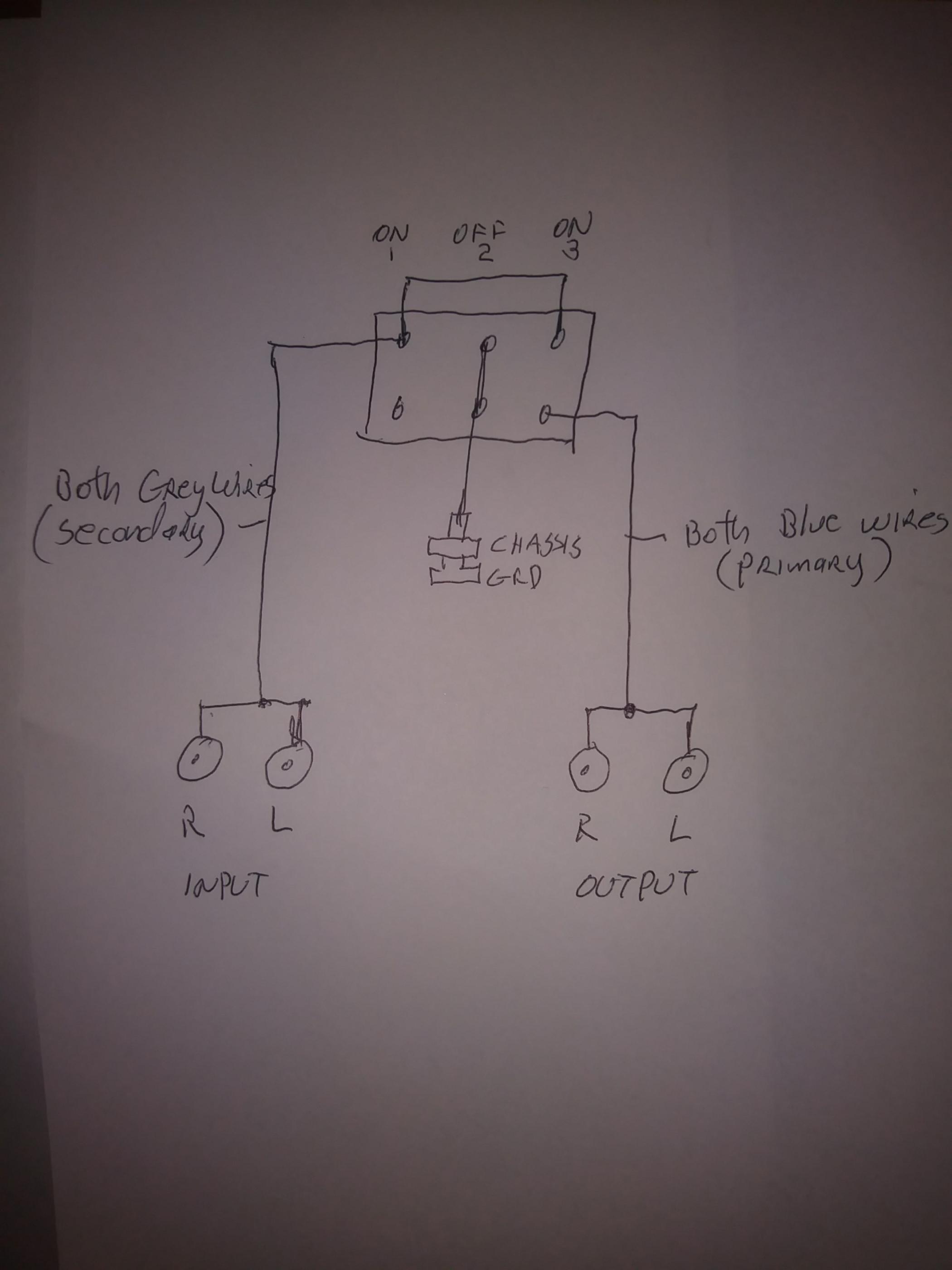

This is a question I have on the grounding scheme to use on my CM-1254 SUT build.
I hope the attachment came in. This is my plan so far.
Switch position (1) Ties input grounds to chassis ground
Switch position (2) Off
Switch position (3) Ties both input and output grounds to chassis ground
The Faraday shield will be tied to chassis ground as well, the transformer bodies will be tied to ground as they are mounted on the enclosure metal box.
Am I missing anything here?

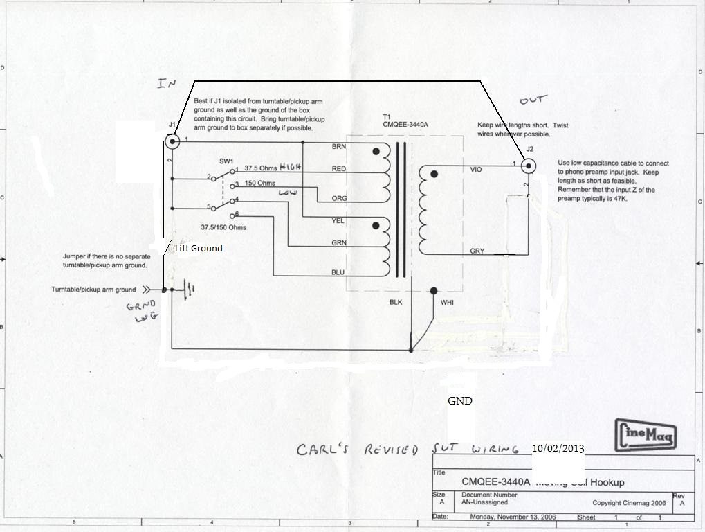

Just added a revised schematic that is very similar to the CM-1254
The last file is Cinemags recommended hook up for the CM-1254
