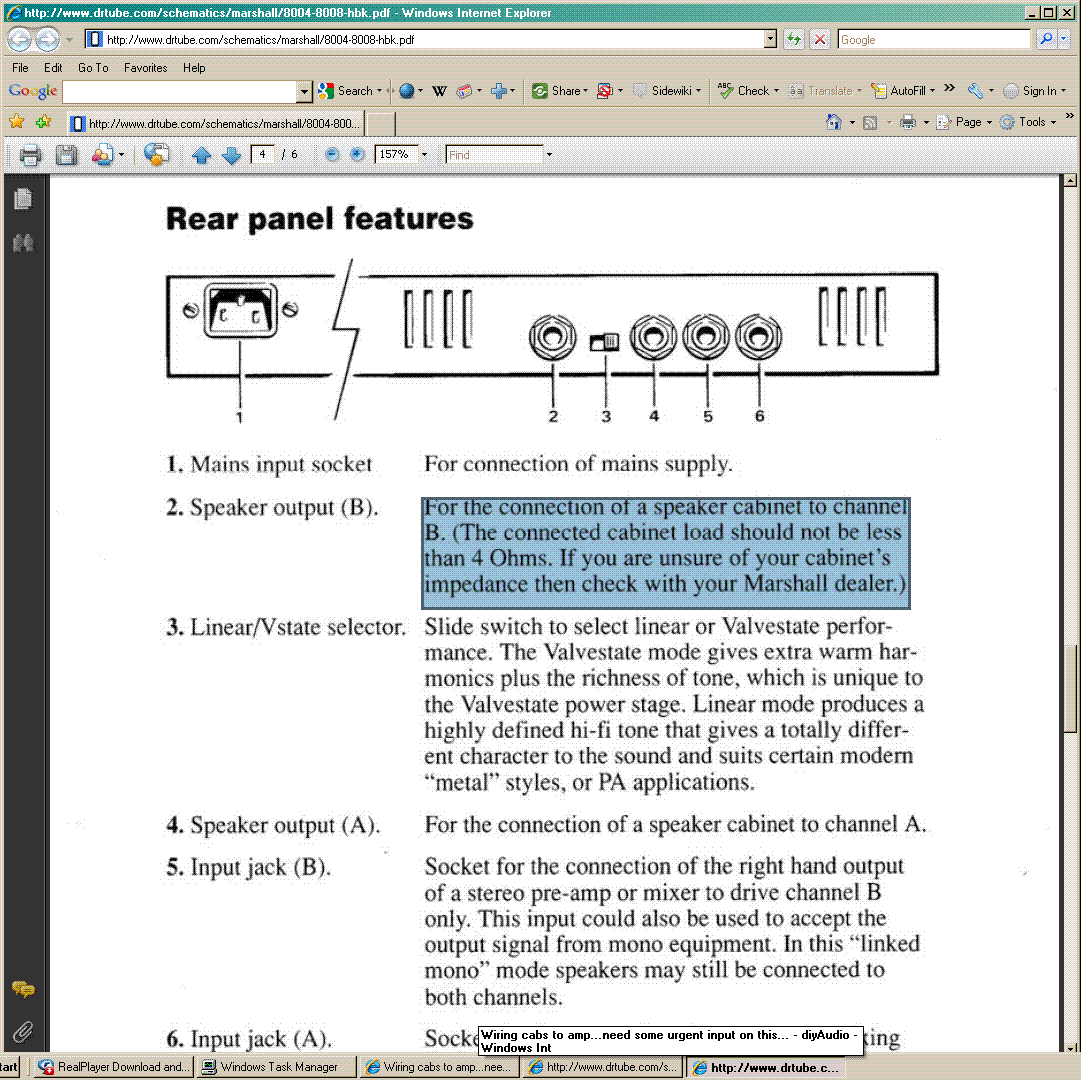

Hi folks...newbie talking here, so please bear with me 😀
I need maximum loudness out of this setup:
The scenario is a Marshall Valvestate 80 + 80 watt poweramp and two cabs 16 ohm each.
The options are one cab on each channel of the amp, or the two cabs wired in parallel on one channel.

Hi again, thanks for the replies, and sorry for my late respons....was away for a couple of days 🙂
The amp is a Marshall Valvestate, Model 8008. Rackmounted SS power amp.
PDF: http://www.drtube.com/schematics/marshall/8004-8008-hbk.pdf
Two inputs, two outputs 80 watts each, bridging not recommended (they say it can kill the amp).

The PDF doesn't specify the recommended impedence load, but amps designed for guitar generally tolerate mild impedence mismatches well. Its probably designed to take an 8 ohm load per channel. I'd put a cab on each channel.

Your answer is ...Run them in parallel for an 8 ohm load on one channel.
Amps (voltage FB) that are rated for it, provide more power at a lower impedance ( ohms law with fixed voltage).
Your amp is rated for 4 ohms so 16//16= 8 is no problem (see attached highlight)
Keep warm
