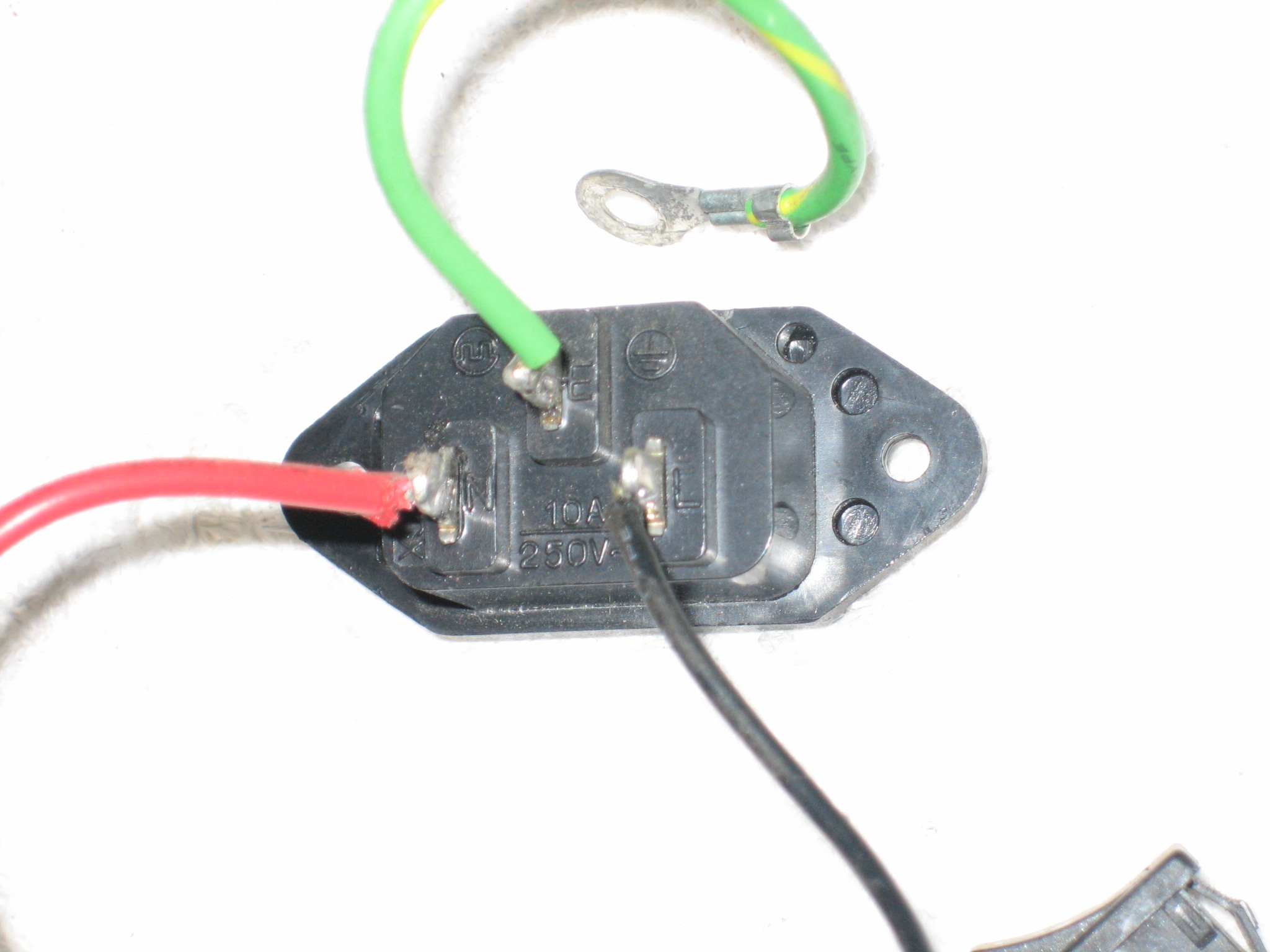

Could someone kindly point me to a photo or a diagram that shows the correct orientation for wiring a standard IEC power inlet? I searched quite a bit today but could not find one. I want to be sure to get the hot and neutral going to the proper posts.
Thanks a lot,
Paul
Looking from the back, Live is bottom right, Neutral is bottom left.
Confused, you will be!
Note the designation on the back of the socket, then note the wire colours!! Interestingly the red ended up on the circuit board at the "L" designation.
This came from a used PC PSU of undisclosed origin.
