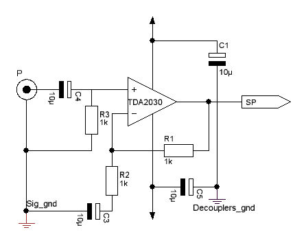

I've build a speaker for my notebook using three TDA2030's. With one amp connected to the PSU the sound quality is very good, but the quality drops as I connect other two amps to the PSU.
It gets hum...noise.
Could you plaese guide me how to wire multiple TDA2030 amp boards to a single power supply?

Yes, Each amp is working with no problem, If it's connected individually.
Here's a digram of my wiring:
As you see each amp has two grounds. one is for signal-gnd and the other is for decoupler and bypass capacitors.
Where's the problem with my wiring?

You didnt include signal wiring in your diagram you sent me either.
I think you have some earth loops.

Rainwulf said:You didnt include signal wiring in your diagram you sent me either.
I'll draw a signal wiring diagram too. maybe the problem is there!
Definately sounds like earth loops.
You signal coming in will consist of two wires, earth and sig.
Disconnect the signal earth from your star mains earth, and connect it to the signal earth coming in.
Thats how i got zero hum in my amp, and i have 6 modules, with 2 different power supplies!

Thank you very much!
Done; No Hum at all!
