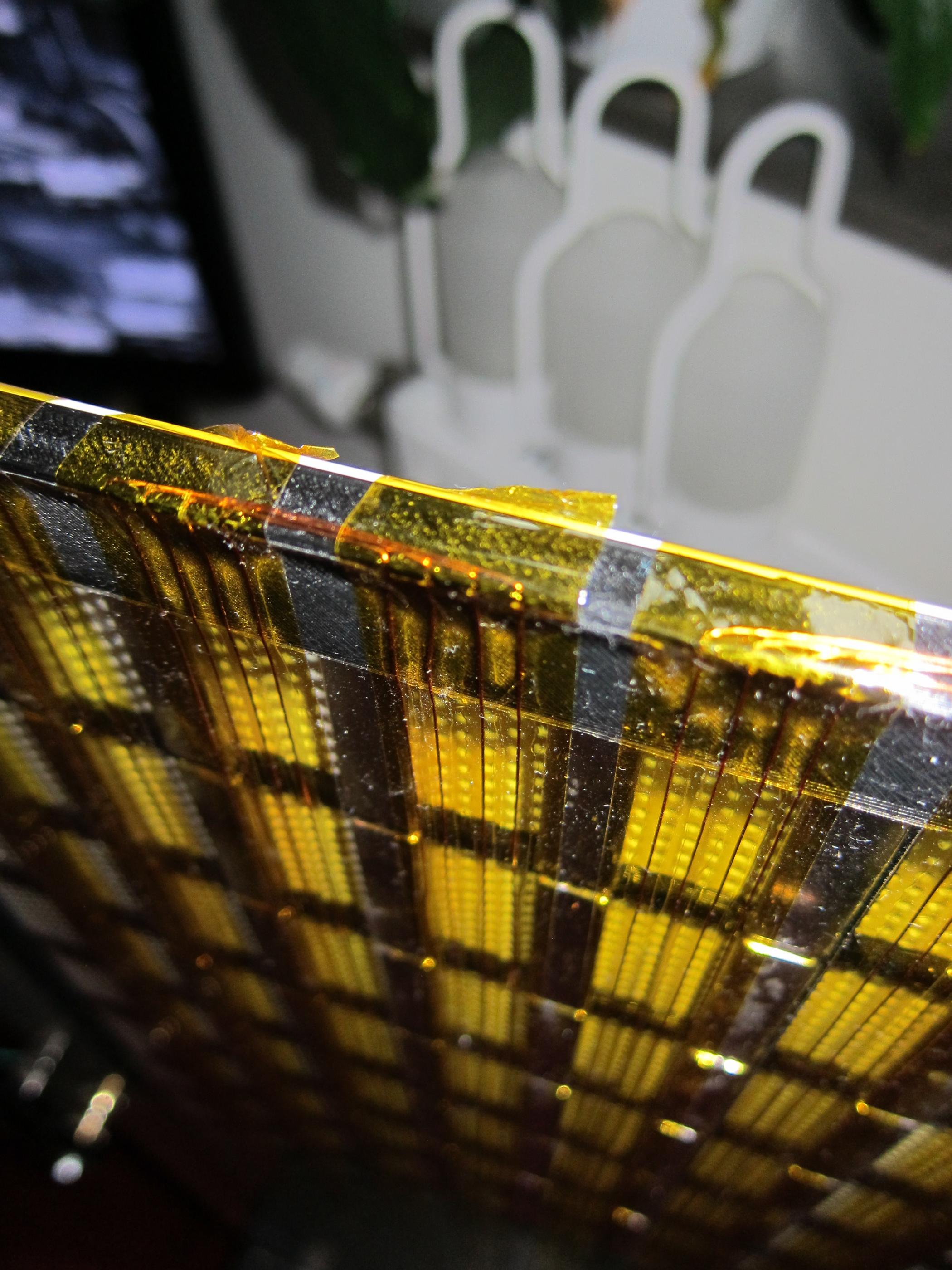

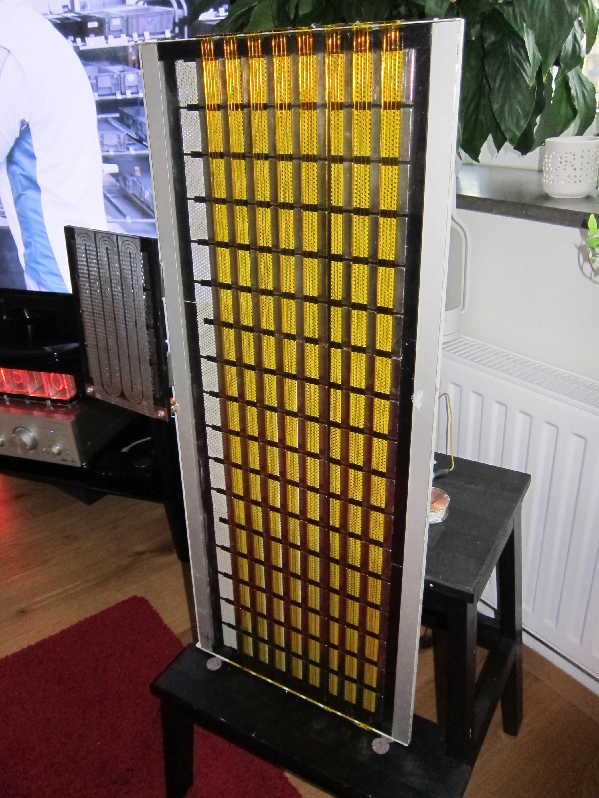

I had some magnets left from earlier projects, so I made this contraption for fun.
Its a bass driver with nine rows with 19 magnets in each row. The magnets size is 4x10x40mm, and a 12Um Mylar sheet stretched 4 mm over the magnets.
The perforated metal is a shelf from IKEA called "Bottna".
Today, it has four loops of 0.32 (28 gauge) copper wire. Each loop has four turns in the magnet gap. The loops are connected in series, giving a total of 5 Ohms and sensitivity around 85 dB/2,83 volt
The wires are taped to the Mylar using Kapton tape for easy replacement. (works surprisingly well, with very low distortion)
The big question: How to make the most Spl efficient wiring? Maybe using thinner wire in parallel?
Any suggestions?
Regards/ Jonas

IF you maintain 5 ohms then Thinner wire will lower sensitivity, yes even in parallel.
Assuming present configuration...
26 gauge copper will give you about 3 ohms and about 1.5- 2 db more
add another run of 26 ( 5 per ) and get about 3.8 ohms but only about 1 db more
Better If the magnets were closer together, about 1/4 inch apart would be good. Then field strength would be higher AND better aligned with wires field. If magnets closer together, and wire sized optimized, and assuming same size diaphragm, you should be able to get about 5 db, maybe a bit more
BTW if you stay with the magnets spread out like that you may not have good damping of both bass and lower mids. Its very "open". most planer designs have around a 10-15% open area through the magnet structure. Yours looks to be around 50% open area. This resistance to air movement is used to damp resonances. The kapton /wire/mylar sandwich might be giving needed damping but not likley. You may need to close up the construction a bit to quiet the ringing. This "ringing is heard as a boomy uncontrolled bass and a thick and resonant midrange.
You can easily experiment with this "damping" by simply attaching strips of any tape to the backside of magnet structure to close up the open areas. Try at 1/4, 1/2, 3/4 closed and listen. Be sure to rub tape down good to the perforated steel so that the tape doesnt move. I like to use the "painters tape". It sticks good enough BUT comes back off easily

You are absolutely correct on the ringing phenomena, I can hear it in the mids.
I will try 6 mm between the magnets, and then I will also have space for a true ribbon tweeter on the same "Bottna".
Thanks again!
