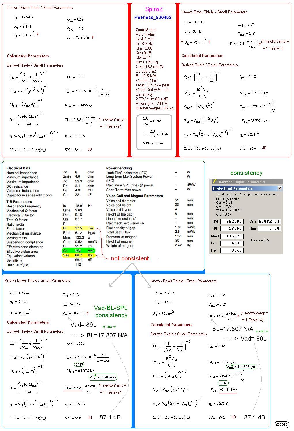

I am simulating my Peerless XLS10 830452 in WinISD and I get a recommendation for really small enclosures.
I decided to ignore the default recommendation of a 4.9lt enclosure tuned at 45Hz or something and I am simulating a box at approximately 17lt tuned at around 28Hz.
I plan to use a slot vent of 3cm height and 22cm width (to match the box depth) and I get a 1.3 meters long port (approximately).
Am I correct assuming that the vent volume is not included in the calculations? that means that I may build a 17lt box (internal volume) as long as the port will be external right?
If this is the case, I have already designed a box that the vent starts from one corner of the box and circles around it on all sides.
I end up with a box approximately 40X44X27 outer dimensions with the 17lt chamber in the middle and the slot vent (that has a net volume of an additional 6.6lt) around it.
Is that correct?
T/S parameters for Peerless 830452

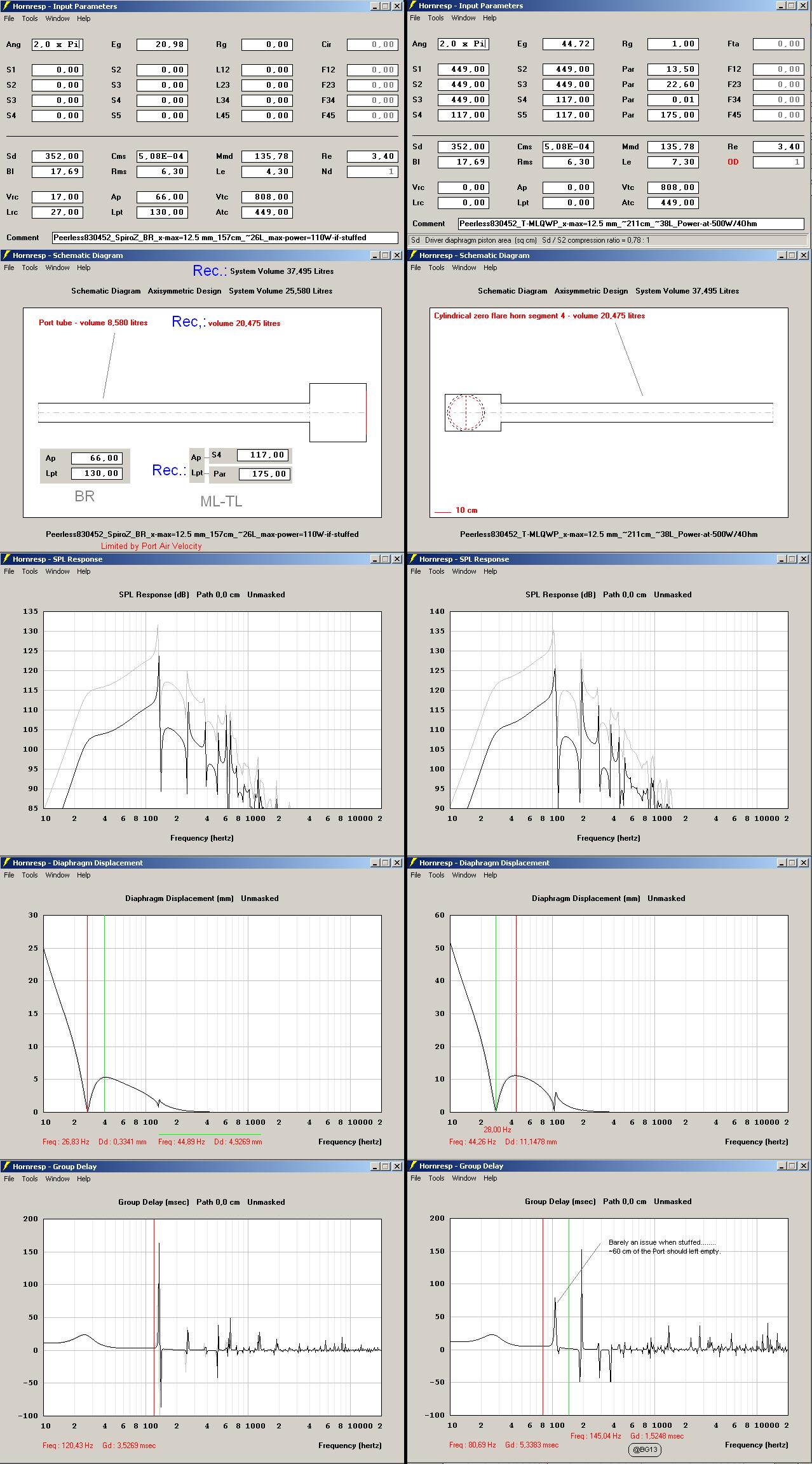

Hi SpirosZ,
I've been using ~1.8 L Vd for my designs....Its not listed but can easily estimated using the given driver dimensions and IMO only necessary to add if Vb< ~20L is a closed box.
Have a look at the T/S parameters...IME: This driver is by the driver manufacturer advertised (and here at diyAUDIO) with parameters that has low consistency. You want reliable input data when designing quarter-wave dependent speakers, at least with tolerances within 5 %. The first of picture is about the T/S.
This driver has parameters just above this limit and IMO requires a DIY measurement before quarter-wave simulations but for a closed box design the tolerance is of a minor issue and when below ~10%: 'Hits diminishing returns' for the eventually resulting performance.
You have simulated your box using WinISD...not that suitable for this kind of design: The second and third submitted pictures are simulations of your design using Superior Programs(IMO) and when interpreted correctly are far more reliable...Compare!

Hi SpirosZ,

Thanks for going into all that trouble for me. I do not expect a free program to be the best in the market. It is user friendly though and easy to understand.
Your simulation on Hornresp may be perfect but to be honest I do not understand a thing.
I really don't need a program that shows me all the math behind it's findings. Just the size of the box and the size of the port would be fine with me.
All those mathematics equations only make me dizzy.

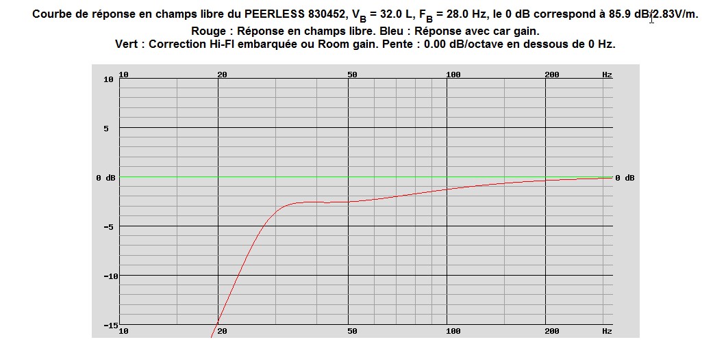

WinISD shows driver volume in the parameters end page.
Add volume of port + driver vol. to Vb for the total int. volume.
Your simulation (pic).
