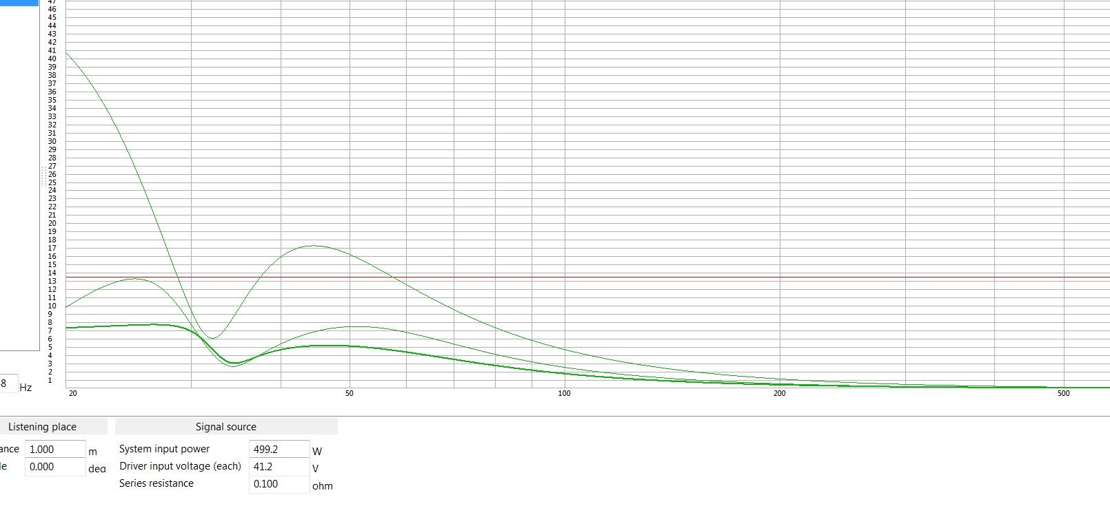

500w signal. Upper trace is driver A and lower is driver B. I don't know how to read this excursion plot. I was expecting driver B to be flapping like crazy with that much power, but it seems comfortable
Is WinISD nuts?

If you put 500 Watts into a driver that is only rated to handle 200 Watts you will simply get a burned up voice coil. You might look at the plot of Maximum SPL for each design. You will find this shows where the drivers hit either the Xmax or power limit. By not telling anyone what manufacturer and model number drivers you are looking at you limit the help you will be able to get.

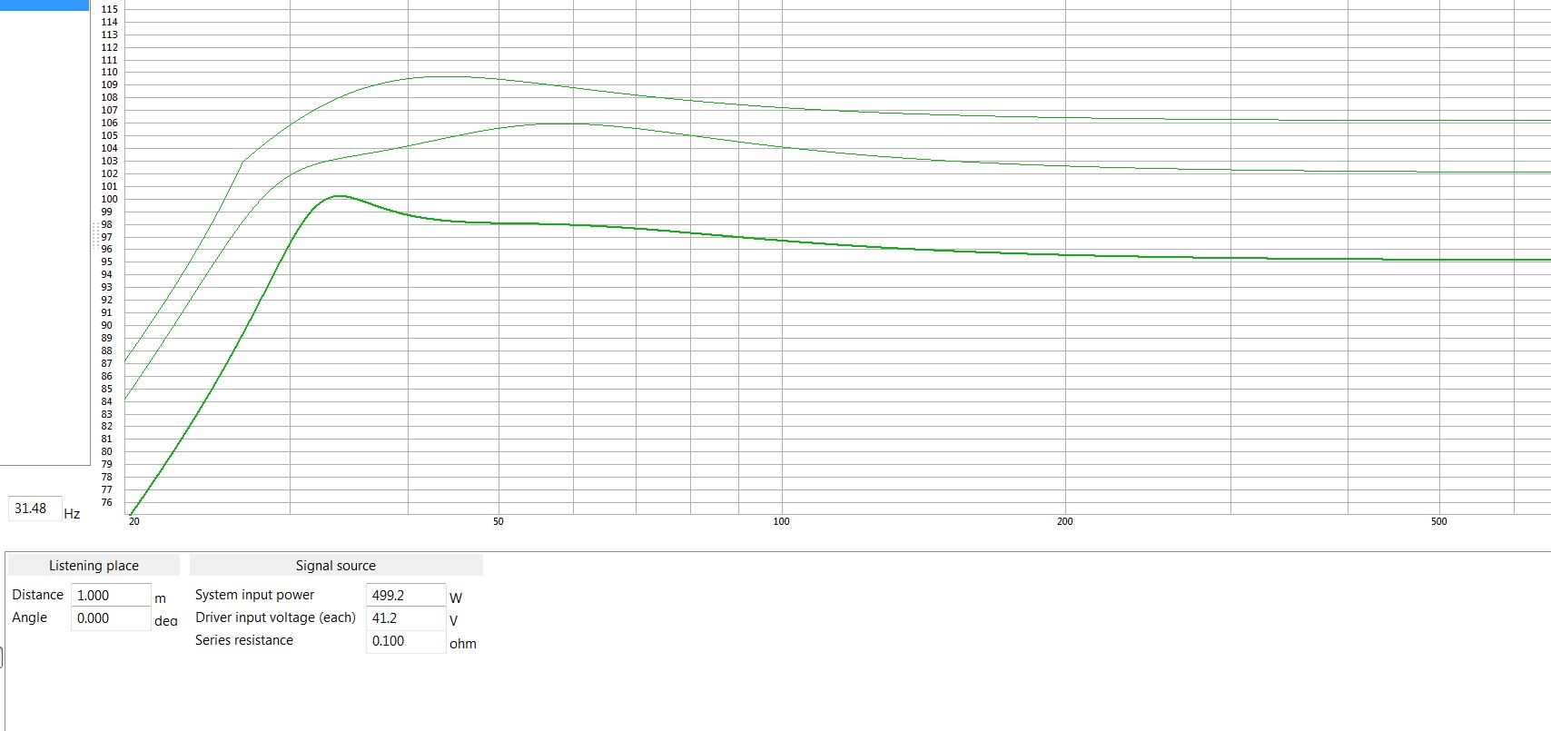

I have entered Pe as 600 for driver A and 200 for Driver B. Still simulating 18L @34hz with 500w signal. This is the max SPL plot. Lowest is driver B, middle driver A and top is the control Dayton Ultimax 8 in its different 30L @32 Hz box
30L is getting out of my targets for space. The Ultimax also seems way louder in its box, but also flapping the way I would expect driver B to

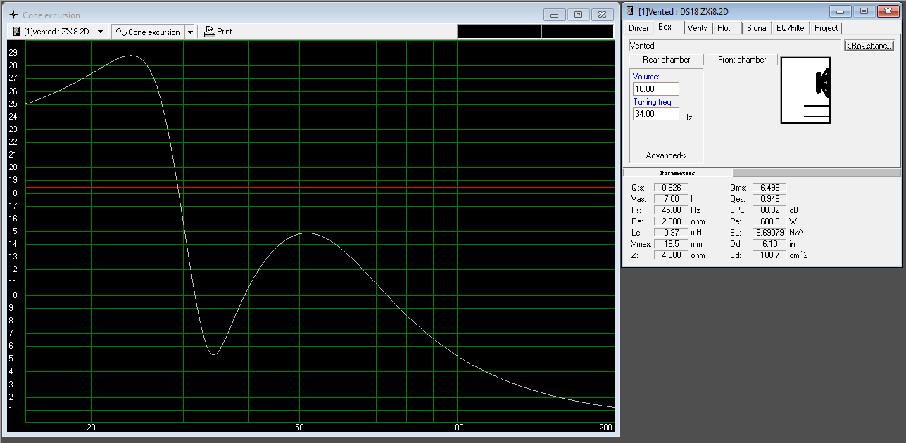

One of these drivers is Dual Voice Coil
Depending how you enter Data
and set Re to 2.8 ohms
And assign series or parallel coils
BL will drastically change by auto calculation.
Without getting sum check errors
BL will be 8 not 6 like the data sheet.
The driver unloads as usual
when there is no sum check errors
BL is closer to 8
500 watts 18L 34 Hz
shown below
keep in mind the driver has a huge magnet stack and basket
the actual box will need to be larger since the driver displaces
so much volume.
BL is closer to 8
500 watts 18L 34 Hz
shown below
so much volume.

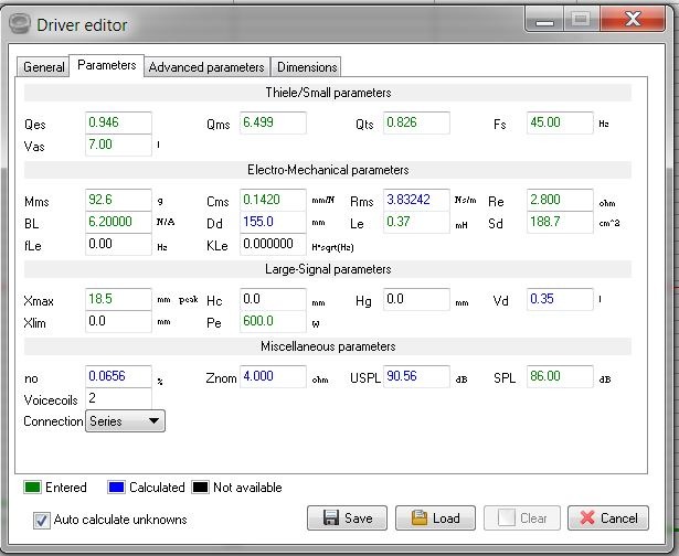

With the DVC ZXi8, I added the Re and entered it as single coil 4R nominal driver. I was under the assumption that the TS parameters were with both coils and not for an individual coil. I am unclear about this aspect of data entry. Regardless, this is not the driver in question, it's the SLS8 that's not behaving like a 200watter in simulation. It's SVC and only 200w. I don't know what's going on with this, but seems like I could throw my 1000w at it, and it laps it up
Manual data entry from datasheet in WinISD
For DVC drivers, should the printed numbers be entered and 2vc selected and parallel or series selected? Example, when the datasheet lists Re 2.8+2.8, should just 2.8 be entered and everything else entered as is? I added the Re and chose single coil

Far as DVC subwoofers and entering into Winisd.
Every data sheet can be different.
I usually specify 2 coils in the WinIsd Driver DataBase
and change Re so when BL auto calculates
it matches the data sheet.
Its better if data sheet specifies if parallel
or series coils used for measurement.
So sometimes you need to change series/parallel
option. then check BL when it auto calculates.
I double or half RE so BL auto calculates
and matches data sheet BL
I am of course also using WinIsd.
I use older version.
all the equation/math is the same.
Newer version they just changed the
graphics and how the tabs work.
It annoys me, so I use older version.

Your box on the UM8 is way too big. It really should not be in a box larger than 15 ltrs as you have found out why. Also, much more than 200W, and it makes mechanical noises. The xmax = xmech and the cone will smack the frame. It really is a sealed box woofer though, as ported will allow too much xmax.
As others have said, you can' just throw 500W into a 200W thermally rated voice coil, even if the suspension will take it, for more than a few milliseconds.
See, this is what I am talking about regarding my misconceptions. I have been under the impression that WinISD would have algorithms for the power drawn from the amp to reach lengths of excursion at varying frequency and assumed that the program was showing that the driver was in safe zone dynamically

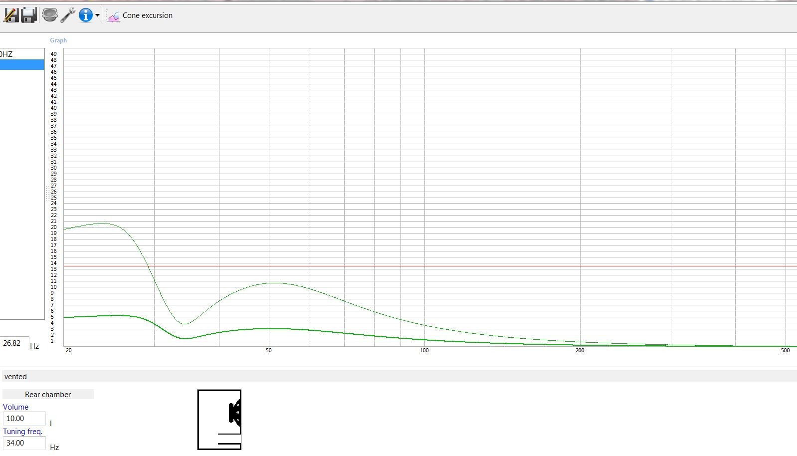

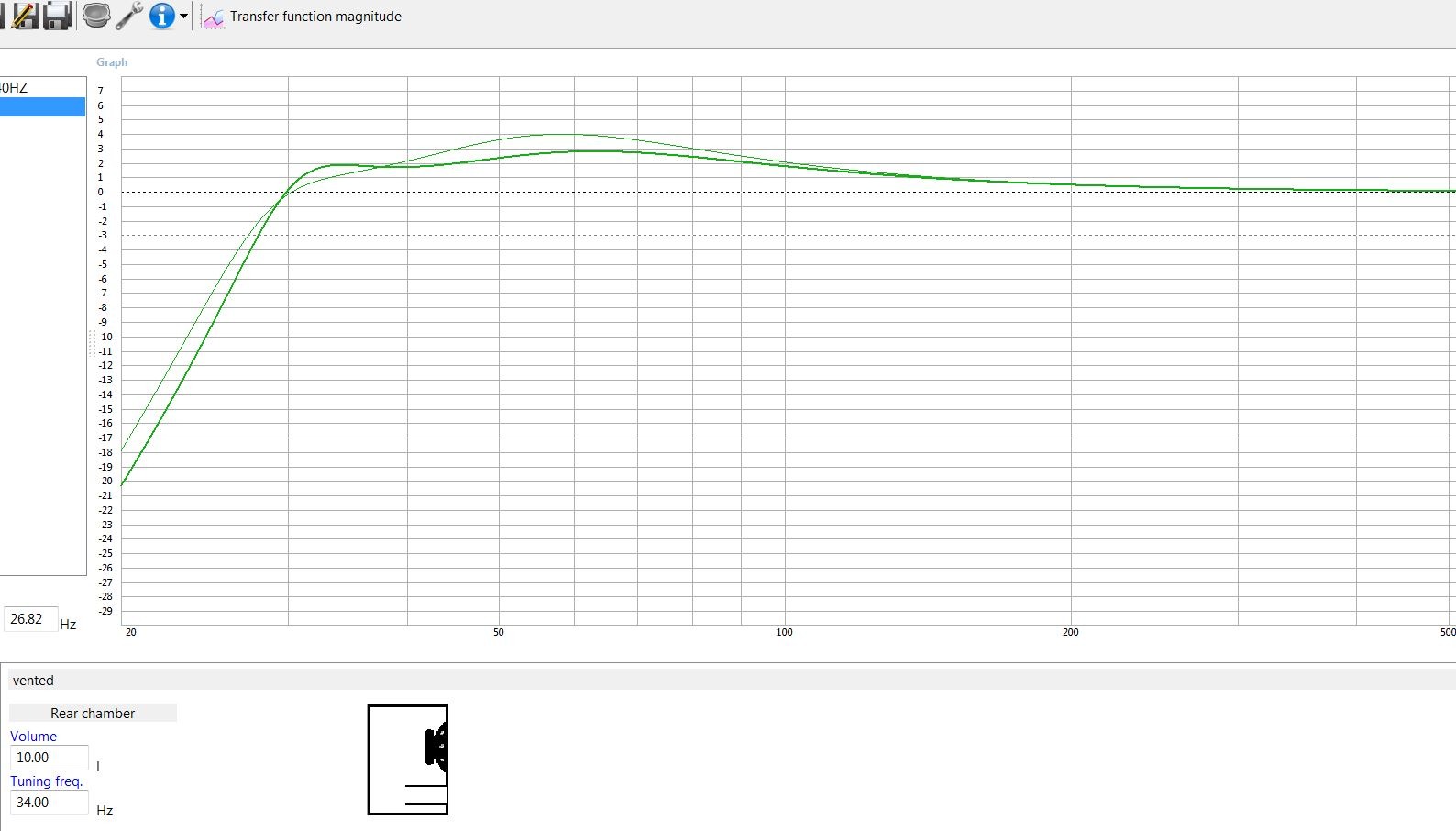

Below is ZXi8.2, 18L, 34hz port, 500w input
vs
SLC8 10L, 34hz port, 200w input
Dark trace is SLC8. I can draw a pretty line and make a pretty box, but honestly I don't know how to interpret this modelling data to know how much more prodigious clean output will I get with the larger and more expensive ZXi8.2 boxes. Hope I have entered the ZXi8.2 coil data correctly
