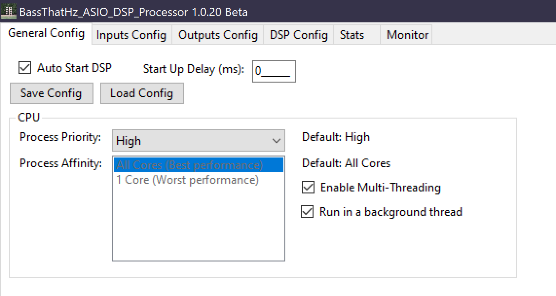

Anyway, it has a number of features that I can "try" to briefly summarize here:
-The foundation of it is a highly tweaked and enhanced version of NAudio.
-Designed specifically for Motu AVB hardware interfaces (because that's all I own for testing/use.)
-Uses up to 64 threads (or more), had threading from the ground up (one thread per stream, unlimited streams, or at least 256 or whatever ASIO's limit is).
-Full 64bit floating point DSP, vanishingly low noise (something like -200db snr or whatnot).
-No added processing latency design (stays within the ASIO buffer at least.)
-FFT FIR (currently limited to FFT sized taps, of a power of 2, and uses overlap-save algorithm.)
-Biquad IIR with 0.01hz (or lower) to nyquist (only tested up to 192khz). Processing is a fraction of 1 ms typically.
-PEQ/HS/LS/LR, Hz/Q/Gain/Slope adjustments with advanced biquad overrides.
-Global Master Volume Input and Output; plus created each Stream has its own.
-Polarity flip and nearly unlimited delay.
-Mixer/Channel summation (input only), for those that need to mix inputs or create matrixed outs.
-Smart gain that reduces the gain to zero to avoid clipping when boosting (unlike dumb static gain).
-The limiter is a instant no-delay added brickwall type, which has it's own problems but exceeding the limiter is not one of them, the softness is, it clamps aggressively (instant brickwall within a given frame).
-All of the filters are zero added delay. except for FIR and the delay filter, obviously.
-Up to 256 channels in and another 256 channels out, 512 channels combined. (Motu is limited to 128 though, so I have no way to verify higher.)
-Each can have 100 or so filters each, there is no engine limit, but the stock windows GDI gui might have a pixel scroll limitation.
-A dedicated PC is not required, but strongly recommended for the best experience. It can run on a HTPC if necessary.
-Has a config save/load, optional startup delay, and an app shortcut can be set to auto-lunch on auto-logon. For those that want to make it an appliance. (Google auto-logon and auto-app start.)
-Currently uses .Net 7 but 8 will be out this November and that will be adopted pretty much right away, assuming it's better than 7, which it probably will be. (Faster etc.)
-Windows-based, which everyone already knows how to use / already has.
-No installer or setup msi or LSB is required for the exe. Only system requirement is .Net 7 Runtime for Windows Desktop. (and ASIO drivers with the devices fully powered on before opening the app.)
Typically uses <1% cpu and <100mb of ram.
Unlimited instances are supported.
Unrestricted use for personal-use/scientific or educational purposes. (There is no warranty and not to be used in a commercial setting, and none planned).
New versions are on a hobbyist best-efforts basis. (DSP is not my profession and I have no formal education on the topic, everything is done/learned the hard-way.)
The app is ugly and barebones, and that's intentional. Pretty pixels takes up precious CPU cycles and ram away from the DSP.
It's designed to run as fast as .Net core can (real-time DSP); and the only real bottleneck is the GC/managed-memory subsystem.
The only major things it doesn't have (yet) is DEQ, GEQ, auto-RoomEQ and auto-BEQ, and arbitrary length FIR.
GEQ I'm already working on, and DEQ I'd like to attempt in the upcoming builds... It will probably be my own variant of those as I don't like the historical parameters design constrains of conventional DSP implementations.

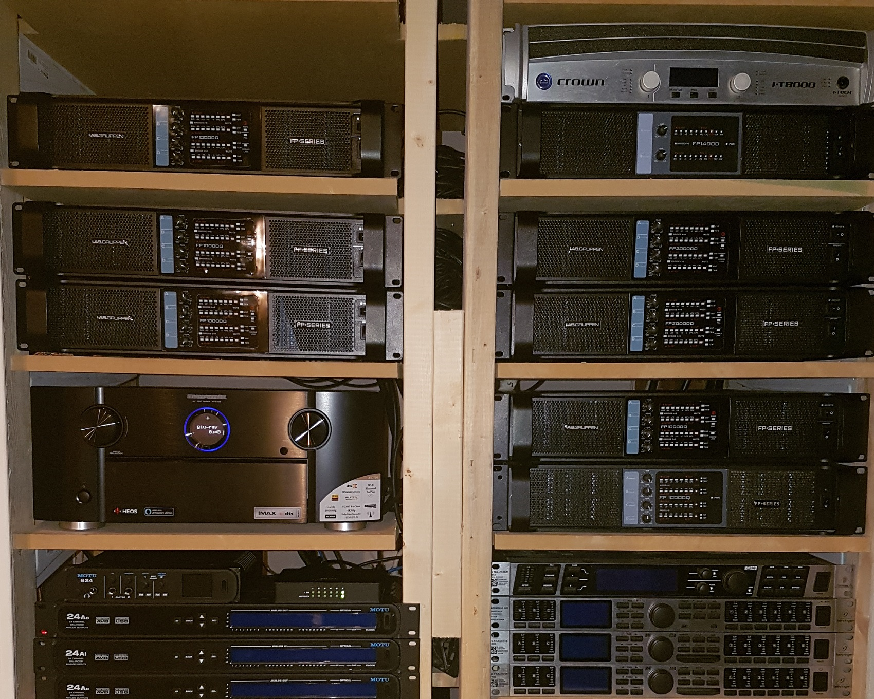

All speakers and subs are all fully active: 7.29.4 (Fronts are 4-ways, 108db/w/m, 2hz to 40khz +-3db, 14kW x 3. The ULF the subs are 4kW each, the PA subs are another 16kW.)
About ~100kW total burst potential, most of it bass.
That's just the front of the room (there's more...)
Anyhow: ridiculously amounts of power\loudness\overkill is my general-theme.

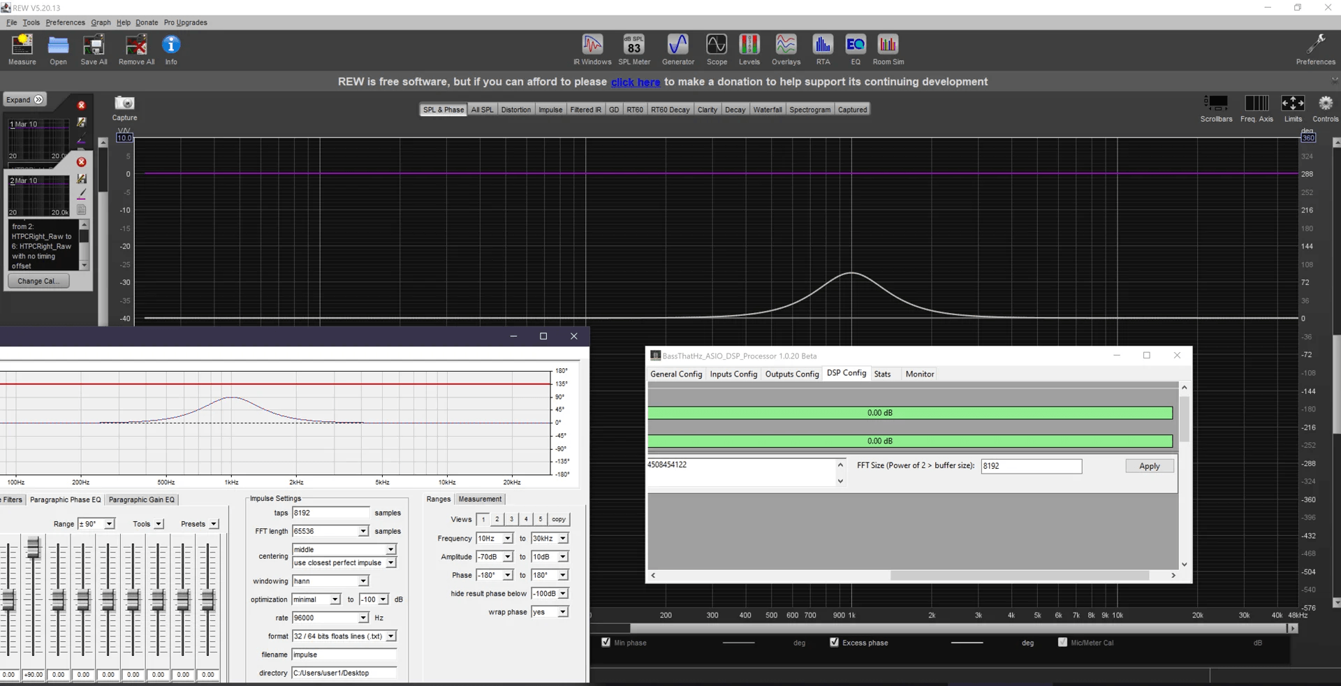

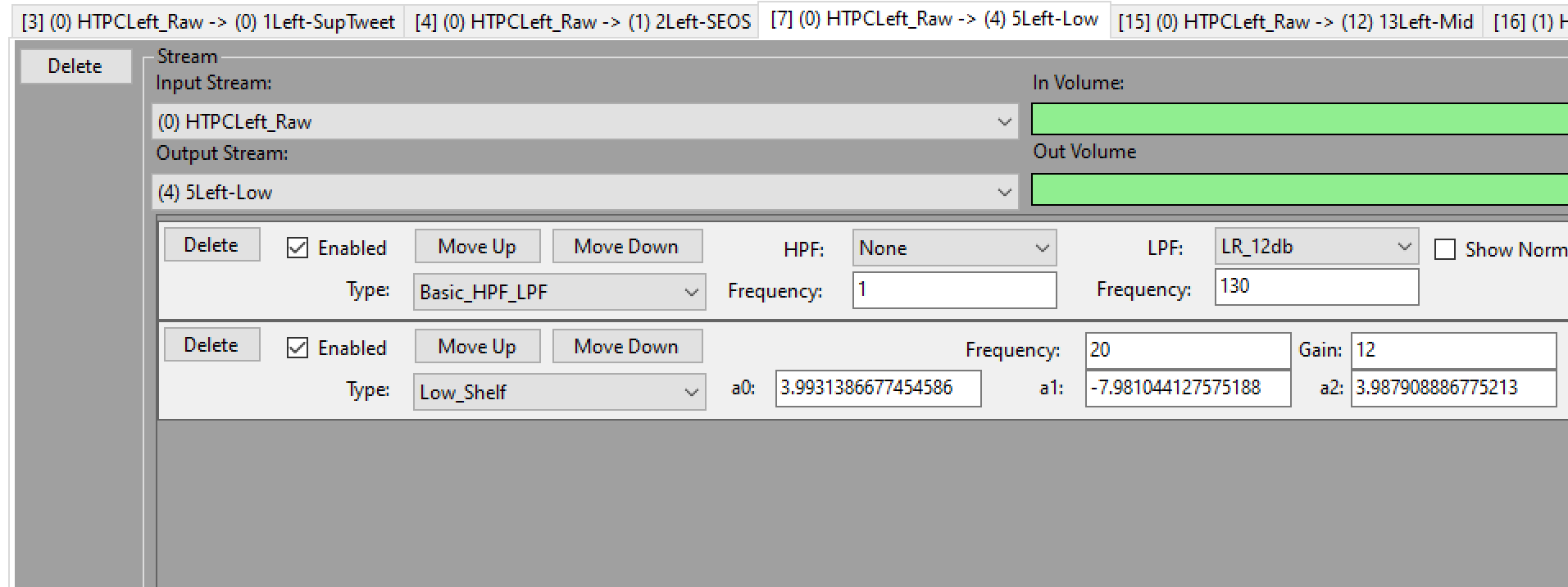

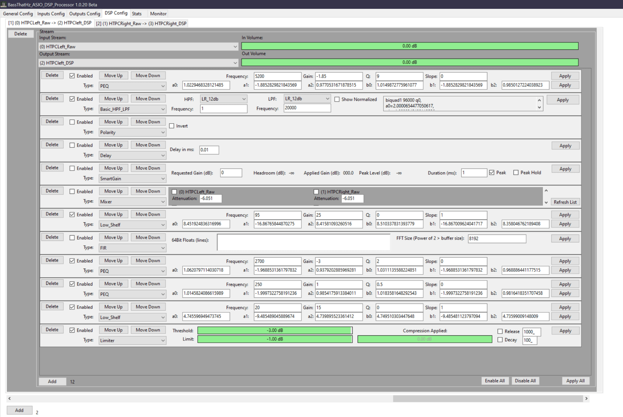

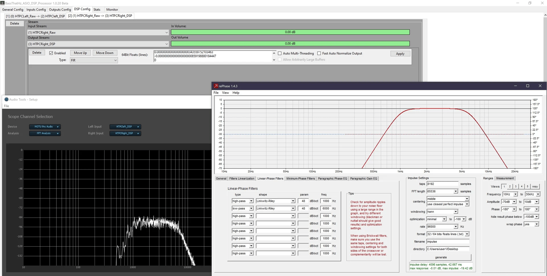

So for example: if you wanted to apply a phase-linear FIR, you could use these RePhase settings comparable to this:
Since FIR is full bandwidth, there is no advantage to cascading multiples, everything can be processed in a single pass. Unlike IIR biquads. (More on that below.)
Or if you only want to adjust only the phase and not touch the amplitude (you get the idea!)

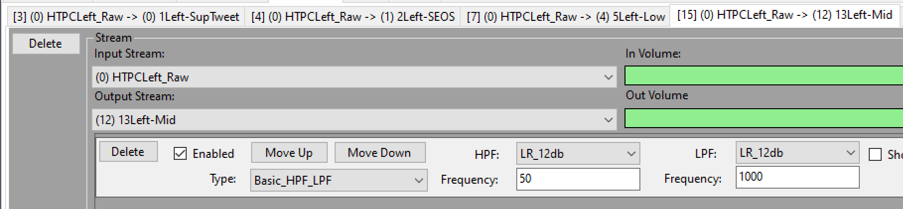

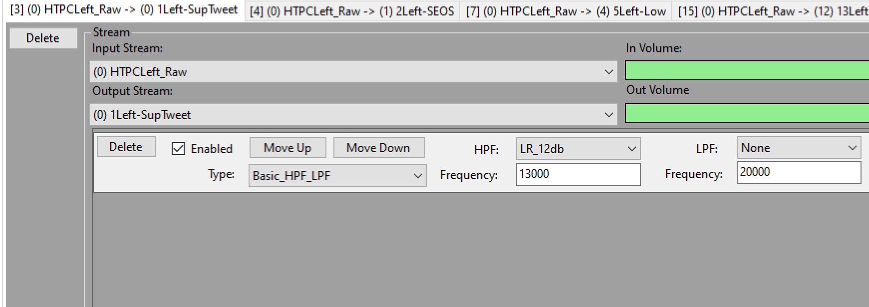

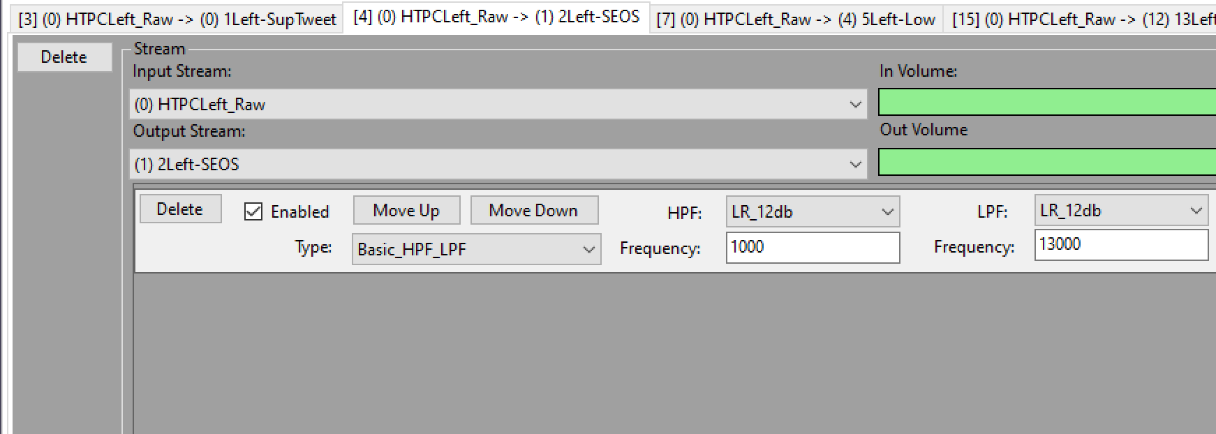

Or say if you wanted to setup a 4-way speaker:
A super-tweeter might look like this
Into a Regular tweeter:
Into a mid-woofer:
Into a sealed bass woofer with a infrasonic natural roll of compensation:
(and a dedicated subwoofer would be similar. etc) You get the idea!
I tried to make the GUI as simple as possible.
Of course you can time-align them and apply EQ as well. It has sample-level precision across any/all threads/streams, ASIO always has that level of precision for a singular device session. (App doesn't support multiple now, or possibly ever. As a result it avoids resampling and multi-device timing related issues.)
I didn't code it because I didn't need the feature, as Motu AVB already synchronizes and sends a large number of channels to multiple avb equipped devices, all under a single ASIO context.

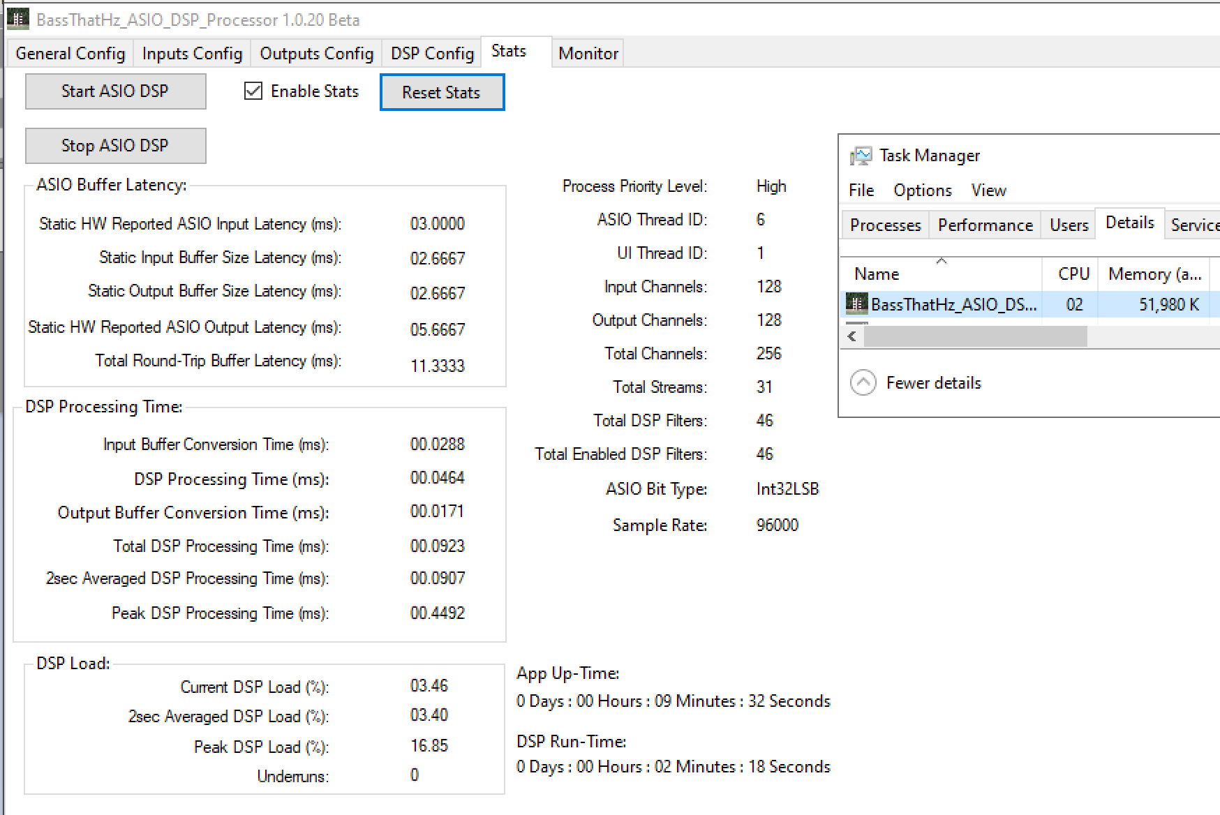

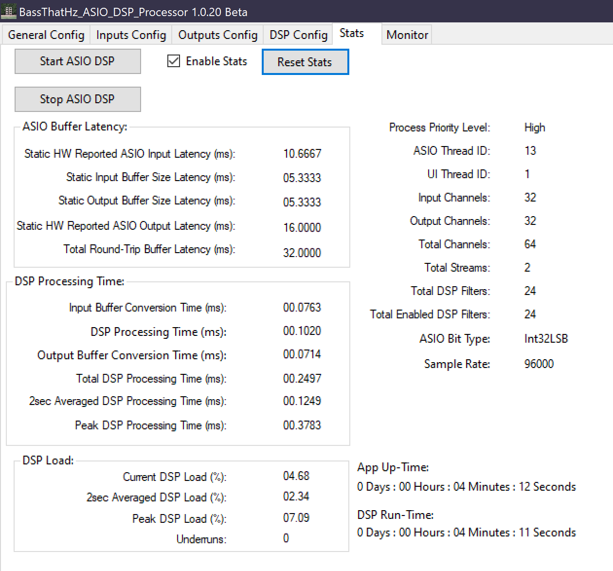

Maxing out my Motu USB 3.0 ASIO driver with 128x128 channels at 96khz it renders 46 filters across 31 discrete channels (which would be a large HT system) in less than 1/10th of 1ms with 52mb of ram (using IIR biquads at least.)
At higher or lower sample rates the performance in C# .Net 7 is about the same.
I optimized the app for mega-core CPU performance for large channel count systems.
An 8 channel system will use 9 cores, a 64 channel system will use 65 cores. (Technically LPU's or threads or .Net Tasks, but let's not nerd-out here. LOL!)
Windows will time-slice the threads across all available cores automatically, you don't have to worry about it if you have more or less cores. The CPU usage will vary according to what you have and how many other apps you have open doing other things.
Obviously a dedicated DSP-PC will only be doing this one thing, where as a HTPC might also be serving videos, which is ungood in regards to real-time responsiveness. ASIO has a fixed time-window in which all channels must be processed fully, the app either renders in time, or the audio is dropped for that audio frame. (Which will be clearly audible hiccups.)
FIR will have a fixed delay inherit in the design, so it's not really great for AV systems, but music-only systems the timing is relativistic so lip synching video pixels isn't a thing. IIR is much closer to real-time but it has phase. Is what it is. Physics is Physics!
With IIR @ 192khz you are talking like a few megaflops of processing per stream per second per thread.
With FIR @ 192khz you are talking like a few gigaflops. It's about 1000x more CPU intensive. (The wattage and cpu heat will go up.)
But I'm not a DSP guru so don't quote me on that. It is substantially more. A biquad is a dozen or so multiplies per sample, and FIR is closer to +1000!
A 64bit DSP isn't twice as good as a 32bit DSP, it's closer to 1 billion times more precise. Each bit is like 2x compounded.
Motu uses 32bit Integers, at least according to NAudio, and nobody who has used those in concert tours or DAWs have complained,
so 64bit is beyond overkill for just about everyone!
Now if you had a 512bit CPU with 512bits of fully populated ram, you could track every atom's vector in the visible-universe. The best computer is whatever runs this reality. (Now that's some precision! 😅)
Into a mid-woofer:

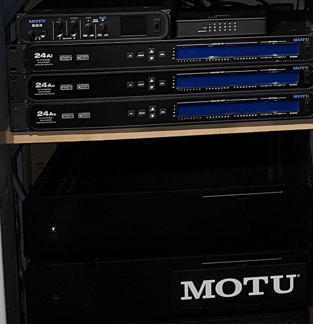

So for example:
Say you have a 16A or 8A or pair of 24's. You'd have either unbalanced or balanced TRS or XLR from an AVR or Pre or Mic going into the HW, it would send that via TB or USB to the DSP-PC / app, and sent to the outs via ASIO on the same connection, and those directly connected to your amplifiers.
In my case for movie-mode:
I have a BD player -> HDMI - Marantz (Atmos decode to XLR) -> Motu 24Ai -> AVB -> 624 -> USB 3 ASIO -> DSP-PC / App -> USB 3 ASIO -> 624 -> AVB -> 24AO -> amps.
Music mode:
HTPC -> ASIO USB 2.0 -> 24Ai -> AVB -> the same
or the shortened version:
HTPC -> ASIO USB 2.0 -> 24Ao -> ASIO Loopback -> DSP app -> ASIO -> balanced headphones etc

That said, the app is fairly simple to use:
1) Set the sample rate and buffer size in the ASIO control panel / HW.
2) Select the input and output devices (has to be the same one).
3) Add streams, selecting the source and destination channel.
4) Add filters to each stream. (All the usual DSP stuff: Levels, Polarity, Delay, XO's, PEQ etc.)
5) Optionally: saving the DSP settings to a file. (If the DSP file is saved in the same path as the exe and auto-load is enabled, it will attempt to find/load it.)
6) Click Start \ Stop DSP
