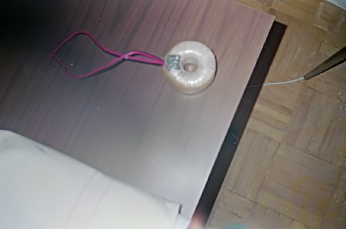

There is no any mashine which could wind with the same quality as man could do. 🙂 Toroid is the best for DIY. I mean for PP.
Several examples. Last is for power suppl. On the background
output toroid in amp.
http://friendpages.com/pages/music/igma/photo12.jpg
http://friendpages.com/pages/music/igma/photo13.jpg
Igor.
Yes, there is a mashine that can do better than man. It's called "transformer winding machine" and it's sole purpose is to wind transformers. It will wind it tighter, neater, and when properly set up, without any breakage of wire, no matter how thin.
If toroid is the "way to go" for DIY, as you say, please explain to me how would you wind 2000 turns of 0.3 mm wire on a toroid, while keeping it all tight, neat and all in one piece? Thread it with a needle?

I have seen a toroid machine and it's a very complex one.
But why you'd like toroid.What will you do with the gap of it!?
Even P-P OPTs need a little gap.Winders that are serious with their OPTs use gap.
Go double C-core and you will not be dissapointed.
And use a little gap!!

With patience you could do everything better than machine because u understand what u are doing each moment. I never
saw machine made toroid with proper puting winds. Esp. if u
whant to wind by diff. diameter wires with a lot of sereis. With
different (soft) materials of isolation. The tor I shown has exactly
2* 2000 turns of 0.35 mm wire. 🙂 And it has 5HZ - 50kHz range
at 50Watts. So, handmade... 🙂
Yes, it engage a lot of time. Almost one month for each
transformer. But we are not hurring up, arn't we?
Resident:
About the gap. Gap is no the goal itself. Gap makes the magnetic line longer and that's all. But gap spoils sensitivity.
I consider, it is an advantage of PP using cores with no gap.
Anyway we need quite big core. It's easy could be counted.
Igor.

Igor,
Toroidal type cores look very good on paper but they are the most sensitive to DC magnetisation and are also more difficult to wind in sections.
Regarding sensitivity to DC magnetisation it should be noted that DC balance btw tubes in a push-pull amplifier can change when the tube ages.Ideally a P-P stage should be rebalanced now and then.
Another cause of unbalance in the transformer is dynamic unbalance btw the tubes, this will show itself as even order distortion even though the tubes are DC balanced and if dynamic unbalance is large the transformer can saturate on signal peaks which will limit low frequency output power.
(notes by Hans Beijner)
5 Hz – 50 KHz flat????
What about THD?
Another very important thing is that turns must be exatly next to other. They must be placed with a precise order!!! Sth I don’t see in your foto.
And all layers must be the same length. Something that doesn’t exist with toroids, cause you didn’t get out the wire from the edges of a bobbin like C-cores but from inside of the windings.So none layer is the same with the other.Us you go from inside to outside,layers getting smaller!!
So what’s going on with efficiency, leakage inductance and stray capacitance??
The efficiency of a transformer depends on winding and not from the core of it!
A common C-core has B about 1,7T, but how much of this can you adopt without add distortion?

Hi, Resident
All you are saying is correct. But all this difficulties correspond to
EI cores as well. I have facts, ready transformers and wind only
toroids. That is not for sale, that is for myself...dear 🙂, so I try
to do the best. All problems that you noticed, I solved. But there
are lot of others... common to EI & O. My amps working years
and evrything is Oki. I apply pics of funny construction. It has 4
50 Watts toroids. 2 for power, 2 for output.
http://friendpages.com/pages/music/igma/photo1.jpg
http://friendpages.com/pages/music/igma/photo14.jpg
May be later I'll write an article about tor-winding , because there
are a lot of questions about it.
Now I'm trying just to ensure you that problems EI and O cores
are the same. Anyway I see a row of advatages in tors, which
already discussed in different articles. I'm not so strong in English
to argue them. Sorry about that.
Rgs, Igor.
