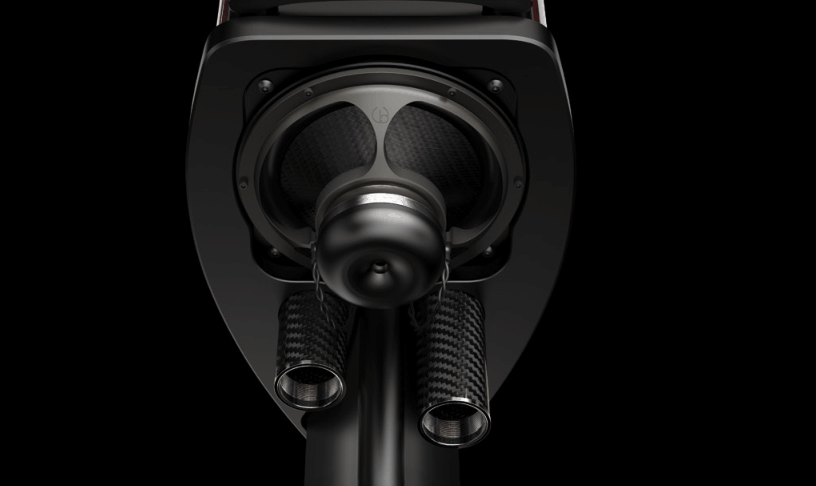

Can someone please give me the basics of possible issues one would run into by having different length ports as in the WB endeavour speakers?

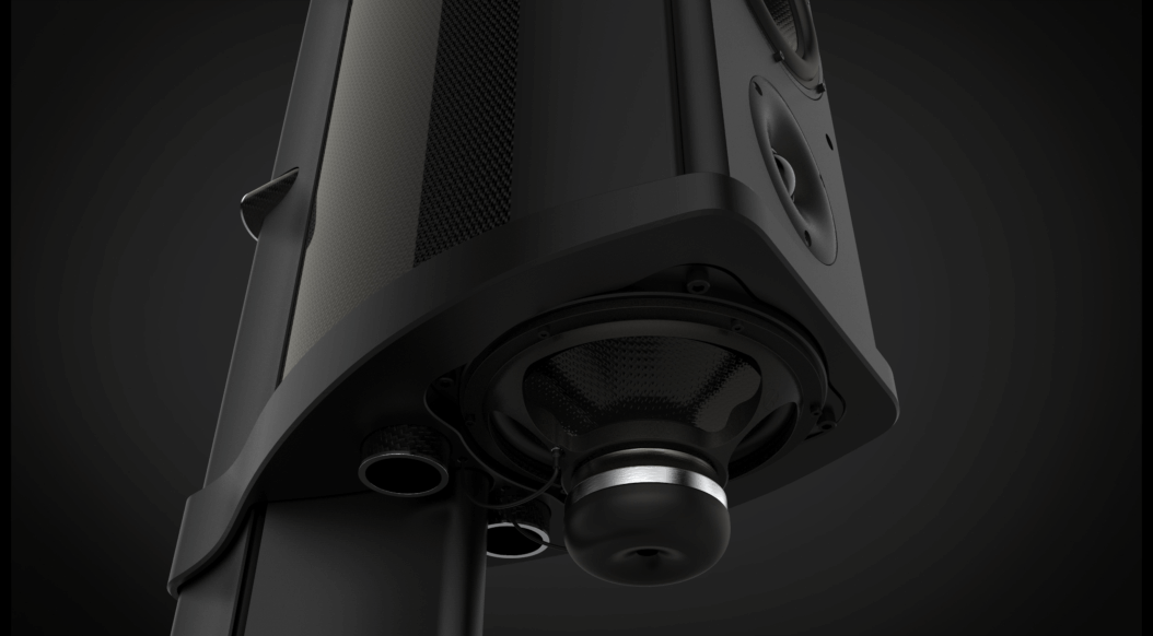

Double ports. If they are different size lengths (and same size diameters) connecting to the same Helmholtz chamber, then they have different frequencies, I have some Focals and they have a lower port (bottom) with lower frequency tuning reflecting to the floor. It might have an impedance curve with lower max. peaks and spread in frequency.

Since the ducts are sharing the same volume, they'll just behave as the mean length and the total summed cross section, notwithstanding any added frictional effects (the ducts don't look small enough for that to play any significant role).

Another thing, when (and if) sharing the same volume, is that with different sizes they have different ressonances. Port ressonance I'm assuming...

The latter (multiple high aspect ratio slot ports) is something incorporated in virtually all of Planet10's non horn designs - at least the scores of those I've built over the past dozen or so years. They definitely make for an extra step or two in assembly, but seem to be well worth the trouble in terms of control.If two vents of different dimensions are attached to the same volume, you don't get two different resonant / tuning frequencies: all that will happen is that you will get a single resonant frequency which is determined by the mean length and the total cross sectional area of the two vents. The exact behaviour of the overall response may vary if there is some additional mechanism at work , such as ducts that individually have a very small cross sectional area -the added friction may case some damping effect.
I already read about them, WB. I can't remember about their topology. An Xray would be nice. Someone already said that the distance to the floor it's high to work for the benefict of LF. The pdf shows a reflex (or aperiodic) mid driver chamber in the shape of a bottle with back port and a double sub, face to face, isobaric with a dual system of ports. Now, this was implemented with a B&W sub (I don't think is the case here) that interchangable ports, with different size lengths could change the low frequency/alignment.
The ports can be of the same length but posicioned at different heights or they are just different, thus I don't know.

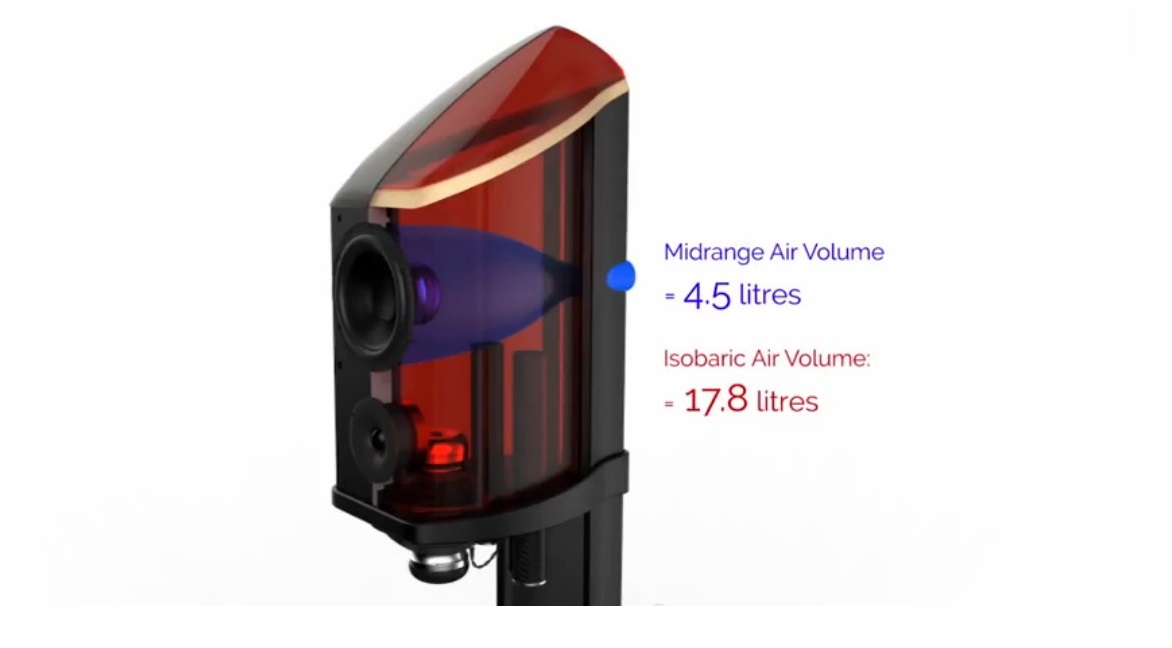

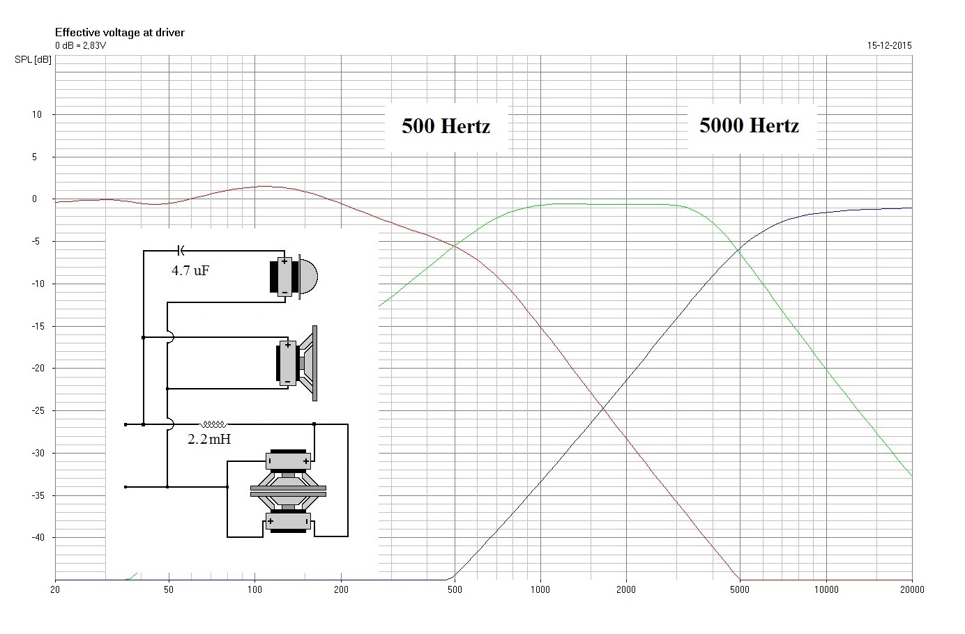

Wilson Benesch Endeavour
Air Volume Mid: 4.5 Liters reflex (alignment?)
Air Volume Woofers: 17.8 Liters Isobaric (series or parallel?/alignment?).
https://www.youtube.com/watch?v=C5P9DkF74rQ#t=20
Wilson Benesch crossover (similar type below) would be something like a 1. order crossover type and a mid driver directly connected in a 2.5/3-way fashion.
Note. Of course polarity from one woofer needs to be reversed if drivers connected in parallel.
Wilson Benesch – High end audiophile speakers from the UK – The Future is Carbon
Drivers
1 x 25mm (1”) Wilson Benesch Semisphere Tweeter
1 x 170mm (7”) Wilson Benesch Mid-Range Tactic II Drive Unit
2 x 170mm (7”) Wilson Benesch Isobaric Tactic II Drive Unit
Crossover Frequency:
500Hz, 5kHz
First Order Tweeter Crossover, ferrofluid damping
Mid range drive unit directly coupled to amplifier (alignment?),
First Order Bass roll-off.
Drivers
500Hz, 5kHz

Building the unit in-house has allowed Wilson Benesch to tailor the tweeter’s low-frequency roll-off to suit their preferred first-order crossover topology, eschewing ferrofluid damping in favor of a closed and carefully optimized rear chamber. (...)
The forward facing midrange unit is run wide open, relying entirely on mechanical roll-off to blend it to the drivers above and below it in the range. Both the tweeter and the bass units are integrated using gentle first-order slopes to attenuate their output above 500Hz and below 5kHz.
(although nominally a two-way, first-order electrical but two-and-a-half-way acoustical filter, it is actually much closer to a three-way system in practice)
So for example; if two ports of two different lengths end up being the means, why do you not simply have the 'mean' port, other than to .... as you out it .... "look cool" (no disrespect to your good self)?

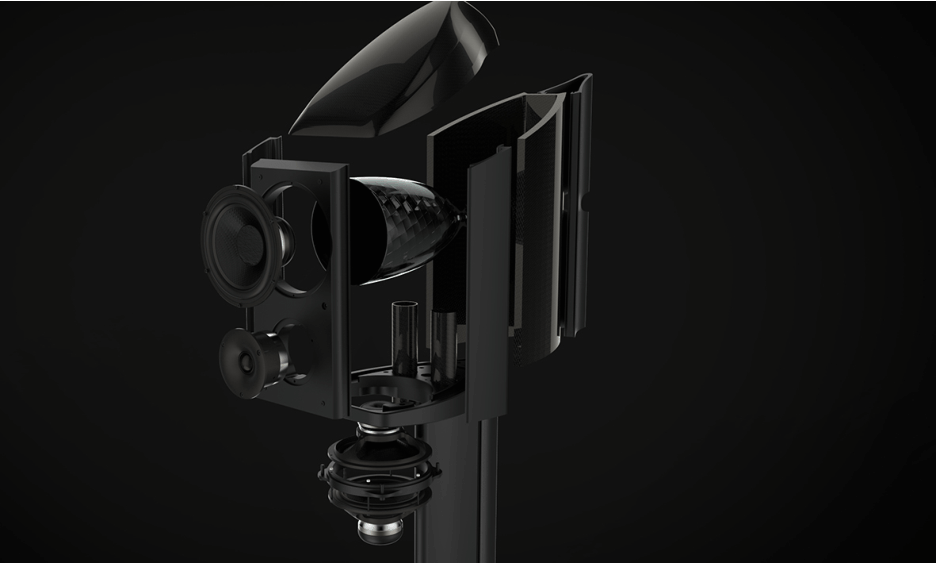

In this case because they don't fit in the back of the isobaric compound, they need to be two, to be one on each side of the drivers (symmetry) and sides of the mid enclosure (in the shape of a "Champagne") bottleneck on top. 😀... if two ports of two different lengths end up being the means, why do you not simply have the 'mean' port,

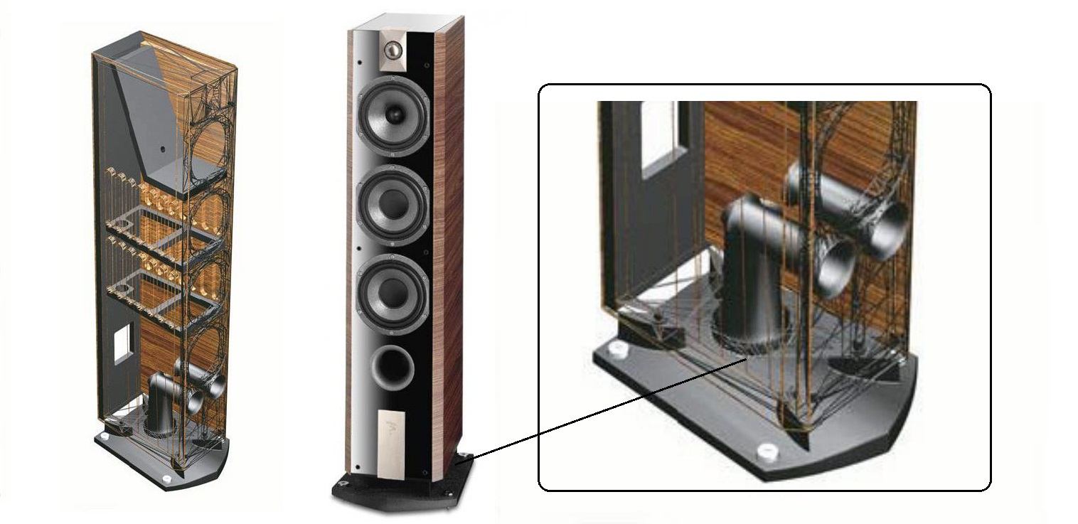

But the ports start inside the enclosure are at the same height/length.
It's only outside where we see the actual differentiating lengths

Here's seems to be another unsymmetrical dual port design
AREA DVD Hardware
https://goo.gl/WKattG - Translated
thinking about it, i assume it's no different than a 6th order bandpass ...
...sorry, what was i thinking😱 There are no separate chambers here.
It always makes you wonder what is inside...

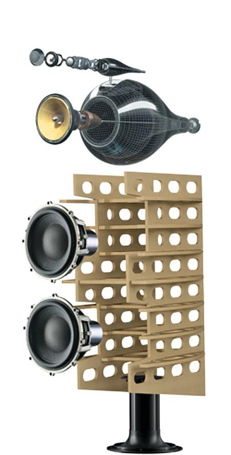

Inside the Focal Chorus 826 & 836 V_X-Ray (port system), Bowers & Wilkins Acoustitune Passive Sub (interchangeable ports). B&W 800D, 801, 802 type of midrange enclosure and B&W Nautilus. 😀

The two terminations will act slightly differently. It's not likely a terribly meaningful effect, but I did the same thing (though I properly terminated mine with flares onto the front baffle) because, why not?

As for the double port with different length, I think it is only a differentiating detail, with no real advantage over dual equal lenght ports. Or it could be used to tune the speaker plugging one or the other (or both) to achieve a better response.
- Wilson Benesch Endeavour Ports :(
