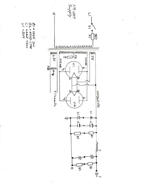

Hey, I need some advice on this schematic. Found it here a couple months ago and getting ready to build it. I'm no engineer, just a solder slinger. The thing that intrigued me was the highish B+ and 10k OPT primary. I tried to do a load line but got totally confused

For a SE EL34 this power supply is a little overkill but will work just fine. The current drawn by the two EL34s would probably only require a single 5U4, and this would lower your B+ a bit too.
The caps would need the equalising resistors connected across them, i.e. joined to the junction in the middle. Also you could easily get away with just the one pair of 47uF in series for the first cap.
The choke should be whatever you can get, around 5-10H and rated for 1.5x the current should work ok.
The second cap can be whatever you want, 100uF total would be ok. You probably don't need to use series caps here, but I am guessing this is what you have.
To model your power supply, go to duncanamps.com and download the power supply designer (and the tube database!) and plug in the numbers, and adjust to get the smoothest curves.

Thanks for the input, I was thinking I could get by with one 5u4, but not really knowing, thought I would error on the side of caution. One will be much handier as the chassis layout is a little crowded. Good point about equalising resistors too. I may use 600v caps as well. I have a bad habit, that if I'm not sure about the designing of something, I just use overkill. I need to work on that. I'm just more at ease with a soldering iron than a pencil

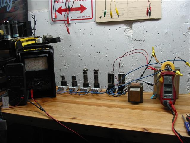

Well this is going to be an amp someday I hope. One question I have is with all my 6.3v heaters connected I have 7.38 volts. This transformer ran more heaters in it's previous life and probably had some sag that is now non-existent. What if I were to rectify the 6.3 with a simple diode bridge? Wouldn't that give me a little drop, and isn't DC more desirable for the heaters? Any thoughts and ideas would be appreciated. I think I am learning from this project after sort of hitting a wall with the books. Thanks, Jay

Just my opinion but the extra voltage will allow you to use a series resistance. The resistance of a cold heater is low and when hot it is high. Therefore the resistor will have most effect when the heaters are cold. It will reduce the inrush current and prolong the life of the heaters.
AFAIK, AC on the heaters is an excellent choice due to the simplicity of the circuitry, except for the issue of hum. I use AC and have no significant hum (except in my phono stage). I actually get more hum from my supply rails (fixed with a few neat tricks).

Could you recommend a value and wattage to start with, or maybe there is a formula (I have to remember math is my friend). With 2 el34, and 2 6sl7 heaters I am pulling 3.80 amps at 7.38 volts.
Add the currents for all the heaters. Then, 7.38V - 6.3V leaves 1.08V in excess. 1.08 divided by the total current gives the resistance (0.28 ohms). 1.08 squared, divided by the resistance gives the power dissipated by the resistor (use 5W for example).

Thanks indm, This is how I learn. By trying to build something and getting guidence along the way. I could read that 100 times in a book and it won't stick. Actually using it to solve a problem seems to make it soak in. I'm going to try and get by the electronics store today as I have very few resistors in the 5 watt range. I will keep you posted. Thanks Again, Jay😀
That seemed to do the trick and it never hurts to be kind to the tubes with prices what they are for the good ones. I picked up an assortment of 5 watt resistors and tried a .22 first which gave me 6.75 volts. Then I tried a .33 which hit dead on at 6.32v. I picked up a nice piece of aluminum today 1/8 thick and 11" wide by 19" long. I plan on trying to do some layout work tonight. I may mark it all out and post a pic for scrutiny. I plan on having mains and signal at opposite ends and rotating opt's 90 degrees from pt. I will have to look at the sockets to figure out how to keep evrything short and tidy (this may take some time and thought). Is there any problem with putting the choke directly in front of the pt with a 5U4 on each side of it. I have some coke bottle ones and thought it would look good that way. Any ideas are allways welcome, and thanks for the help so far. Jay🙂

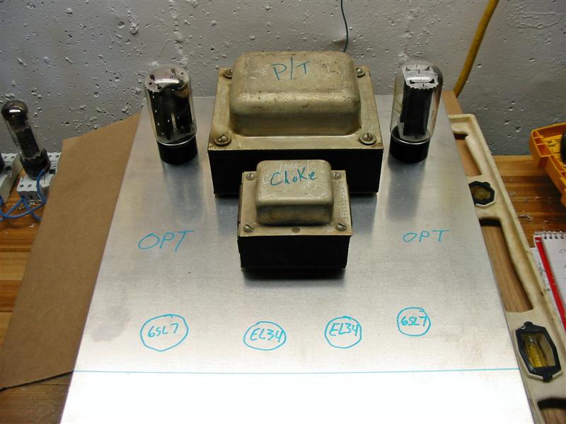

This is a rough Idea of the layout I have in mind. Anyone see any pitfalls or concerns? Anyone ever use "Krinkle paint" for trans. end bells? I don't know how this amp will sound, but it may be in the running for the heaviest 8 watt amp in the world. Thanks for any and all advice, Jay
